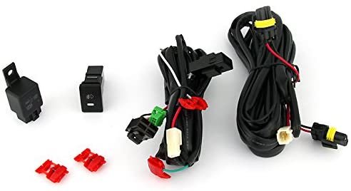

    hi. thanks for getting back so quickly. i dont know the wattage and ive got the kit sort of half installed so a picture is not really possible but i can tell you this:
    comes with a relay and a switch...the bulbs are connected by a wire along the front bumper and there's a switch connector spliced into that. the wire with the relay and the switch is meant to go through the firewall...it also has a thin green wire bare end which appears to be something to hook into the kick panel somewhere. this is an Amazon site photo of the included parts

    Probably the ground....

    i always associate green with ground as well but there doesnt seem to be any other source for power and there's a black neutral/ground wire on. the cable as well.
