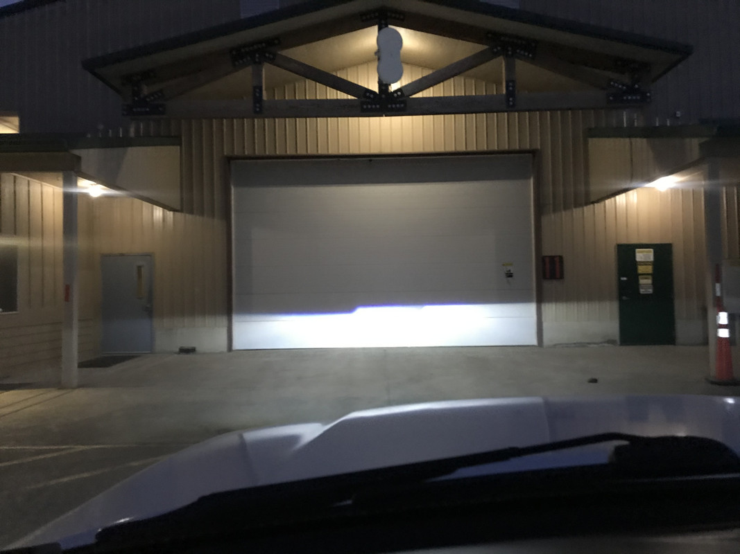

    Damnit that cutoff makes me want to... but I still can’t bring myself to open my new oe headlights..

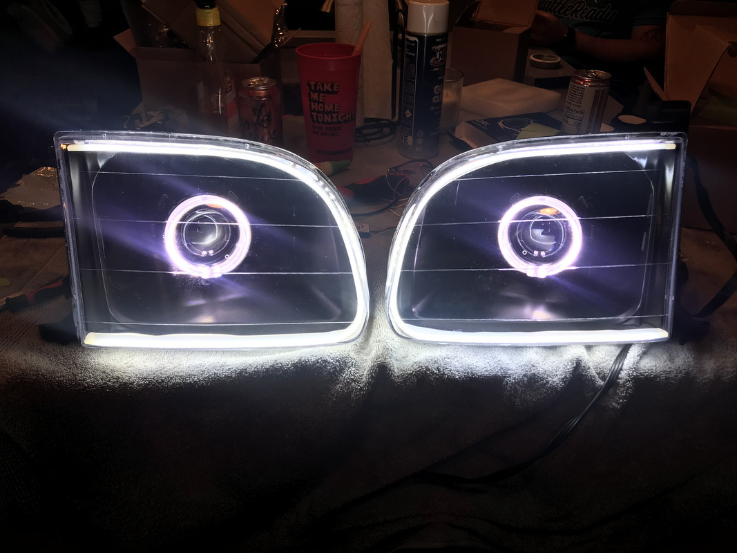

    These are the headlights and corners I used for my retrofit. My HID harness is plugged in to the drivers side headlight factory plug and I also had to install a load resistor on the passenger side. High beams worked but no indicator on the dash.
