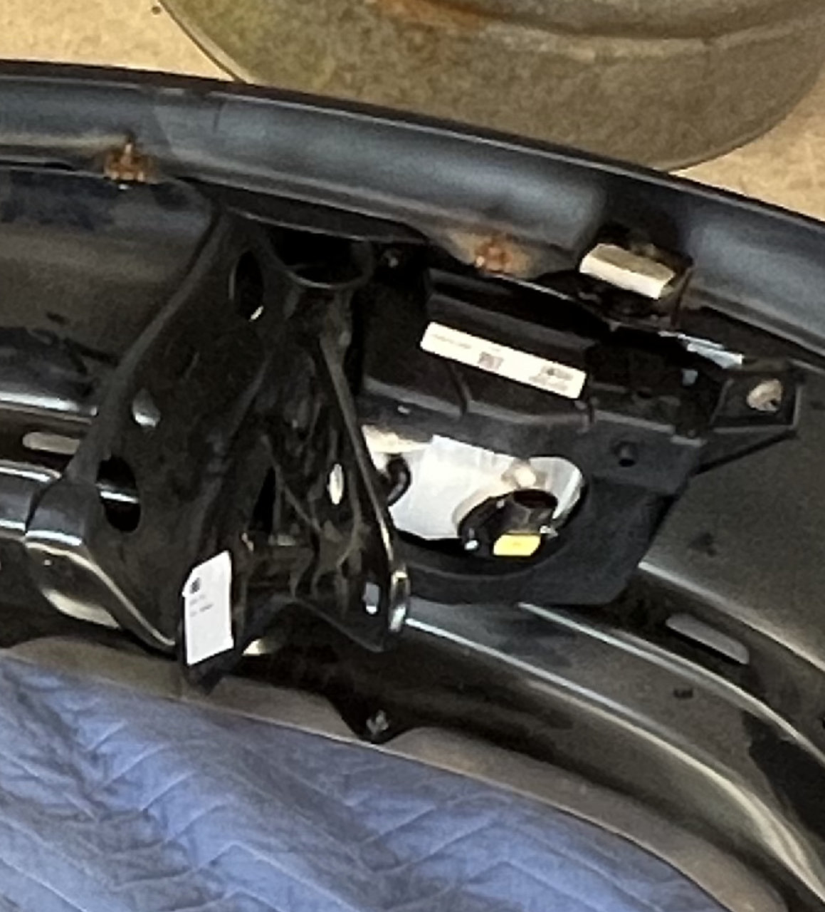

    So I bought the tyc fog lamp assemblies since I have the wiring present for them, I also got the relay and sourced an original fog lamp switch from a parted out vehicle. All that works.
    The lamp assembly to bolt hole doesn’t line up on the top hole of the bumpe. Could this be because I need a new bumper support and bumper or is the part the wrong fit?
    I could get a small piece of 1/8” thick flat steel and make an adapter for the top support I guess.

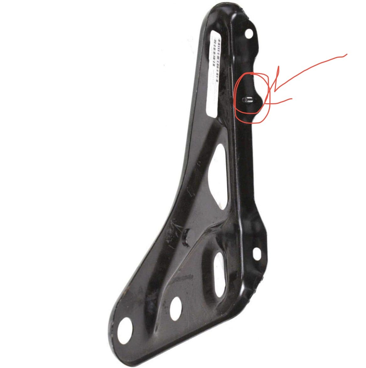

    You’ve got the right part. I think the post you’re looking for is on the bracket that attaches to the bumper. I remember being puzzled during my assembly as well.

    This is the post you seek

    I have that. It’s what the bumper is going to attach to. I believe it’s going to go through the hole on the bumper that the top hole of the fog lamp is near but not on. I had a hit a deer in it years ago and messed up the front bumper. Maybe this bumper isn’t to oem spec on that post. The bumper mount that the bumper mounts to looks newer than 2002

    Mount the brackets to the bumper first. Then mount the fog lights.

    Well I guess I removed the bumper the hardest way possible with how I did it then.

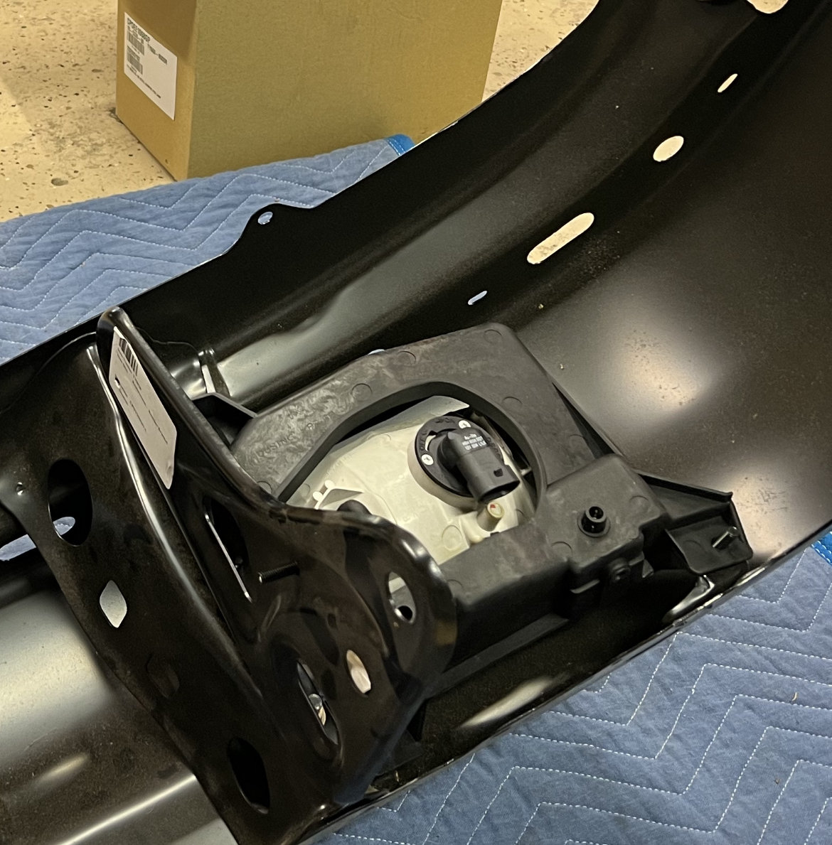

    So I feel really dumb now. I took that part off, and of course it all fits perfectly. The hole on the bumper was so close that I thought they fit together.

    [​IMG]I’m very happy with the result. The grey bumper paint had flaked flakes off and also rusted in places. I sanded it, put phosphoric acid based rust remover on the rust, sanded, and finally used 1.5 large cans of rustoleum spray on Bedliner. I took a torch to the plastics to remove its fading. I put new grommets under the cowl and siliconed them in as well. I did have to cut the cowl a small amount to make the Ravi ditch light brackets fit (this is normal)
