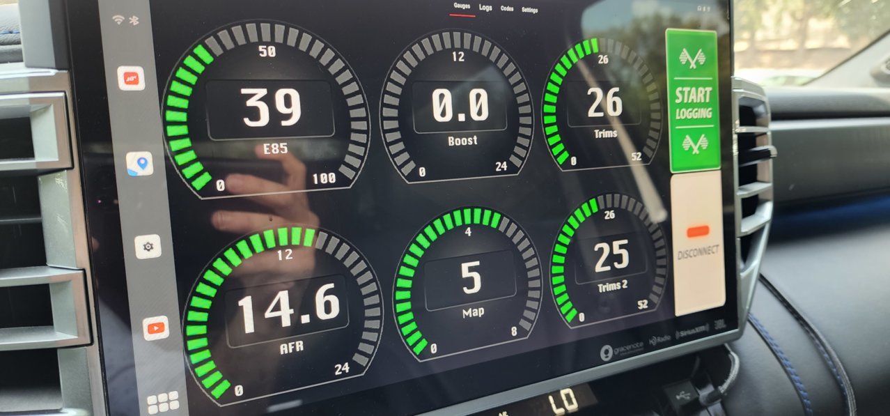

    Installed the ethanol content sensor and its been working perfectly. Hardest part was opening the jb4 and sliding the pin into the connector...15 minute install, tops. If you plan on running E30, this makes life so much easier when it comes time to mix. Hopefully they will eventually support a true flex fuel tune but for now, this will do.

    Thats awesome that the app works on Android Auto. I've always wanted a setup like that.
    Can you datalog the fuel trims?

    I'm actually quite impressed at the amount of items you can datalog via the mobile app and to what precision it does so. The setup Eddie has is using the binize box (from Amazon). I WISH normal Android Auto allowed you to put the JB4 app up but it doesn't through the standard means.

    What are the trims at on E39?

    I think any conditions are fine. The whole point of the trims is the make a large correction for the AFR being off so I wouldnt imagine they would change much once they get to where they need to be.
    I know on my lexus there are separate fuel trims for low, medium and high loads.

    i can do a quick log and check...they show up as 25 on the app but that's considered perfect for the PID...idk why they set it up like that...so 25 = 0% STFT

    What about LTFT? I think that would be the one that is compensating.

    i dont see LTFT. ST is the one compensating on the fly though and I would expect it to be pegged if it wasnt able to keep up with the additional fueling demand from the E

    At idle, ac on, in park.
