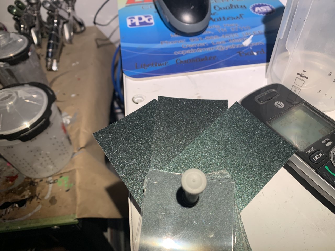

    You’re doing great. As far as the color match check with a local shop and ask them to mix you some that is a better color match. When I get to work I’ll pull that code and check it out.

    So I have 3 choices for that color, and any good paint supply will too
