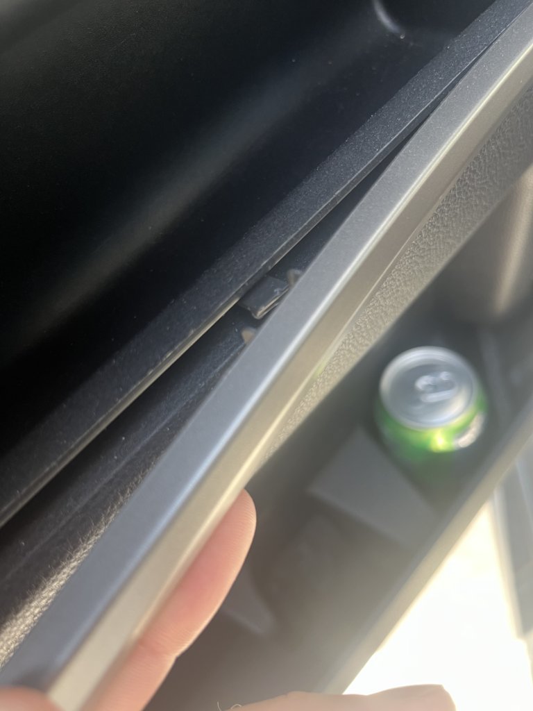

    I've got a 23 Platinum and noticed the trim piece that wraps the armrest on the inside of the driver door must have a broken clip or two, as it's not attaching flush to the door panel. A few questions:
    1) What's the proper way to remove the piece? I assume if you pull the window switches module out, then it could just pop out with clips? Can't find anyone on Youtube removing this part.
    2) If the clip(s) are broken, does anyone know the Toyota PN for replacements?
    Trim piece in question in photo (not my truck- but good enough).
    Thanks!

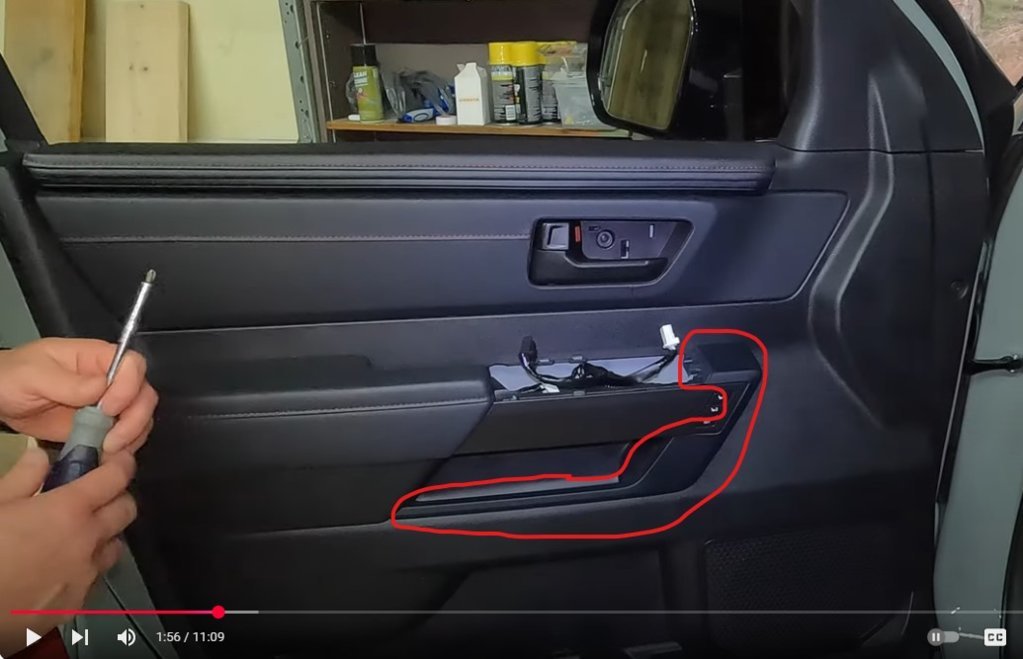

    Not yet- was thinking maybe the silver trim piece would come off without needing to pull the whole door panel off. Watched a few videos on it, doesn't look too difficult. May experiment with it this weekend. thanks

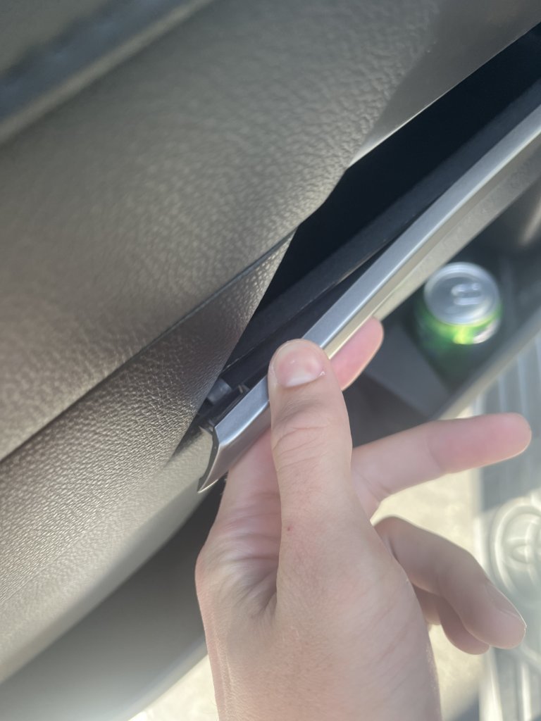

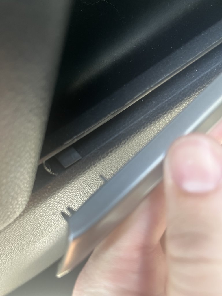

    it does appear they’re held on with clips. In the third pic you can barely see a piece of loose plastic remaining in the door. I think that’s where my trim piece / clip broke. My truck came with the two rear door silver trims having the rearward clips broken so they occasionally pop out. I’m able to pry the other clip out by pulling on the trim piece, so you could probably use a plastic trim tool to pop it out… I was planning on having mine replaced under warranty sometime before my warranty expires since it doesn’t bother me much at all.

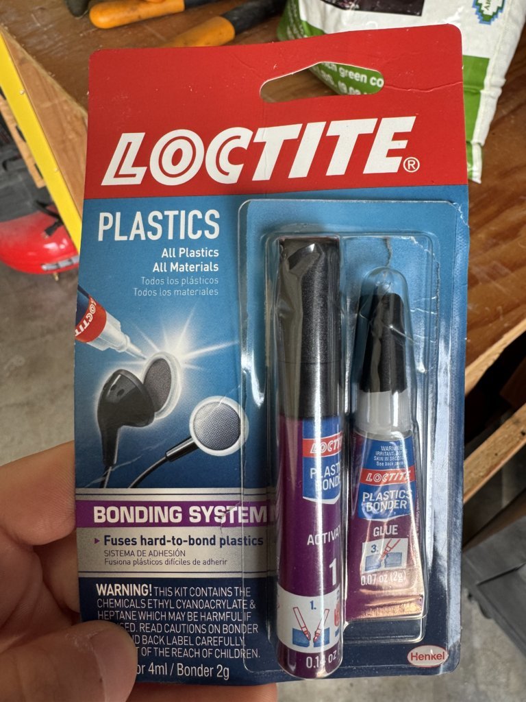

    For anyone else dealing with this, I applied a small amount of this loctite plastic glue and clamped it overnight. Worked great. And if for any reason need to remove the trim piece, could run a utility blade under it to break the glue.

    It was $4 at Lowe's- figure worth a shot at that price and I think it will hold. When applying the glue behind the top edge of the trim piece, be careful not to use too much or it will run out the bottom.
