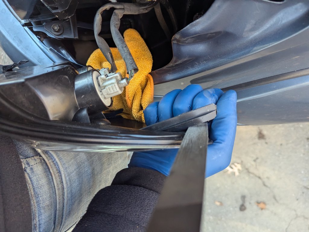

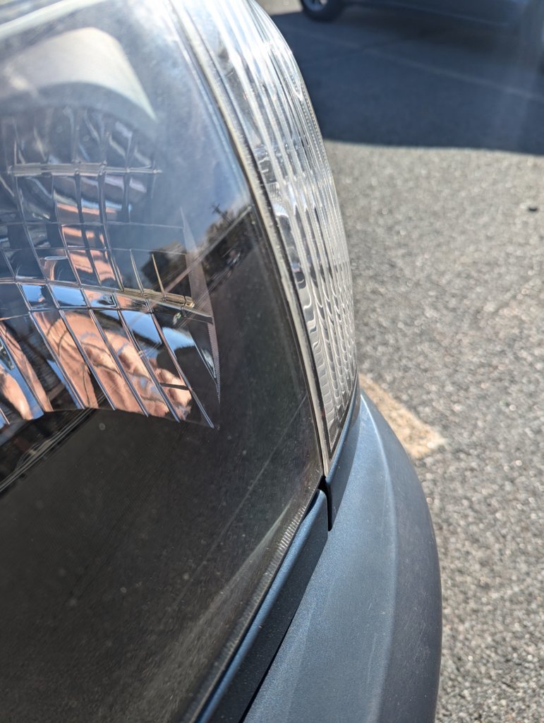

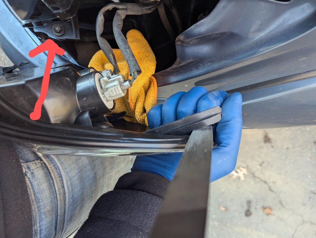

    I decided to post this to hopefully help anyone installing a new aftermarket headlight assembly. I finally installed my blackout headlights with clear corners about a week ago and they didn't mount evenly. I used 2 rubber washers as spacers where the inside bolt attaches on both sides to get the headlight assemblies to sit even. I also wallowed out the holes on the top screw mounting point to get it to fit. PXL_20241116_204030412.jpg
    There still was a lip that stuck out on the corner lights on both sides.
    I drove for a week with this and then figured out how to get them to sit flush. I filed down the long plastic piece that inserts into the fender.
    The headlight assemblies now sit flush on both sides.

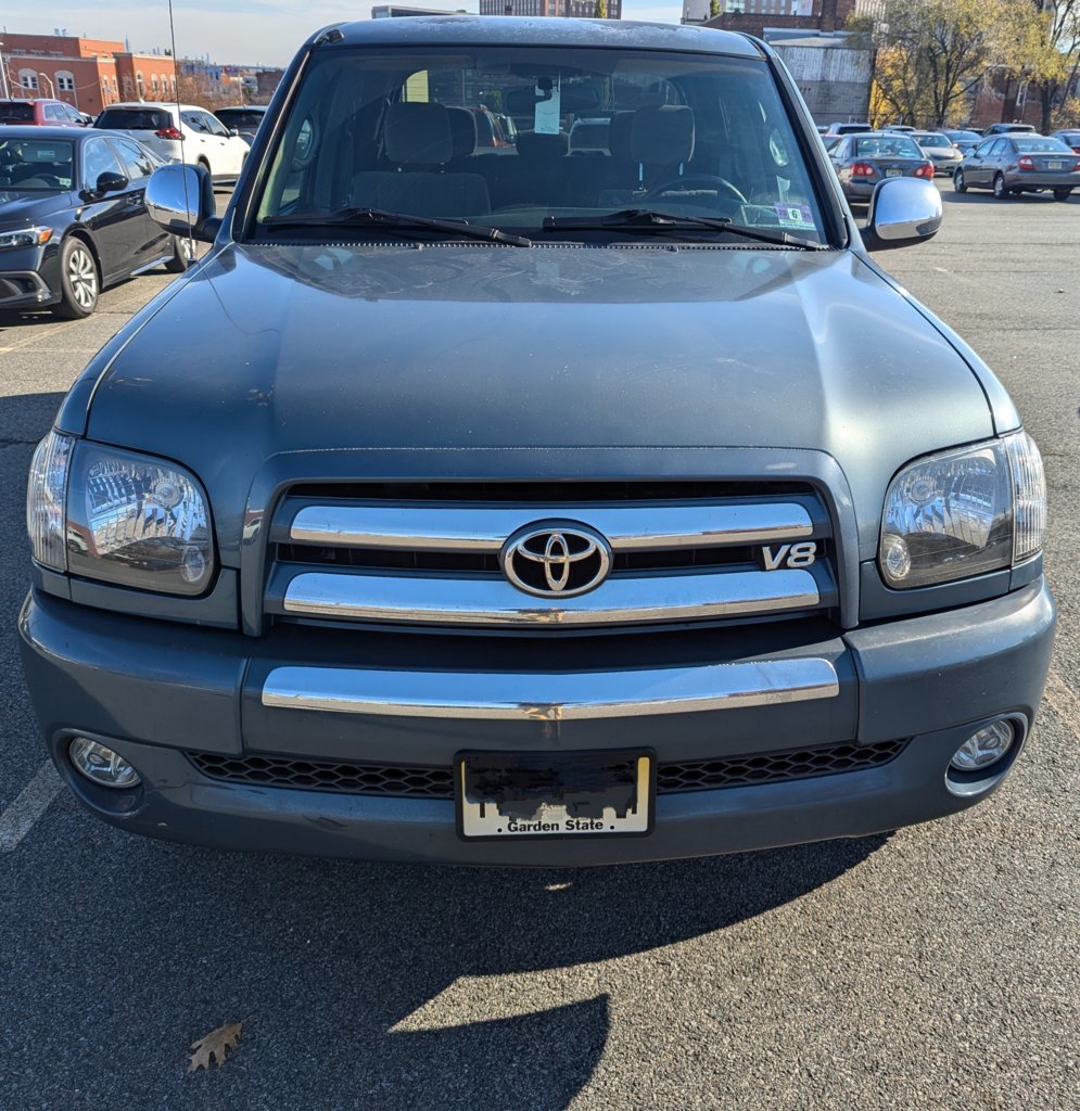

    Let's see a full picture of the front end!

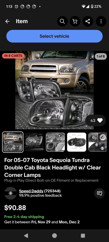

    Mine are probably the same ones from the same factory. I ordered these off eBay for $96 and now I see the price is down $90.

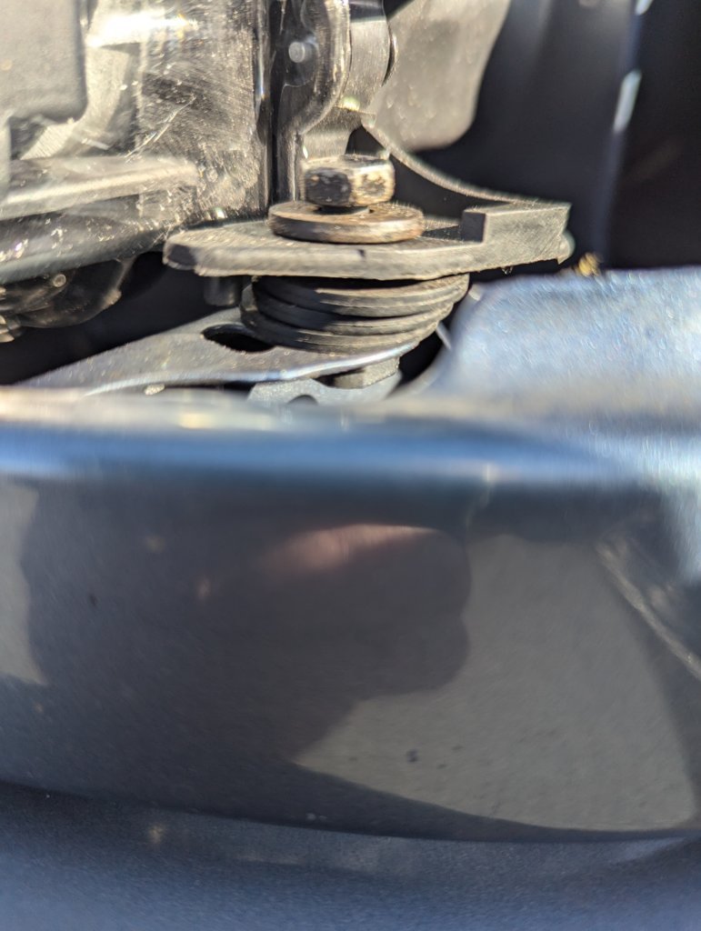

    I did the mini-projector LED install which of course requires removing the metal shroud and those are working well. I'll take some photos to show the thick rubber washers on each headlight that I used to get them to mount evenly. I'll be installing LED blinkers shortly and I'll take a few pics to show all of this better then.

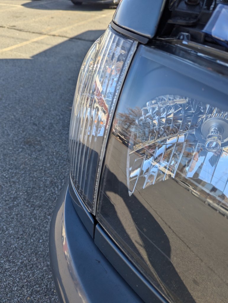

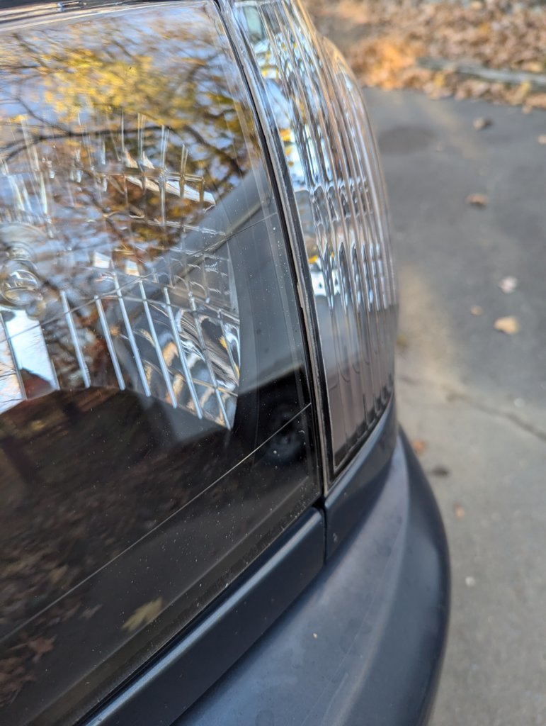

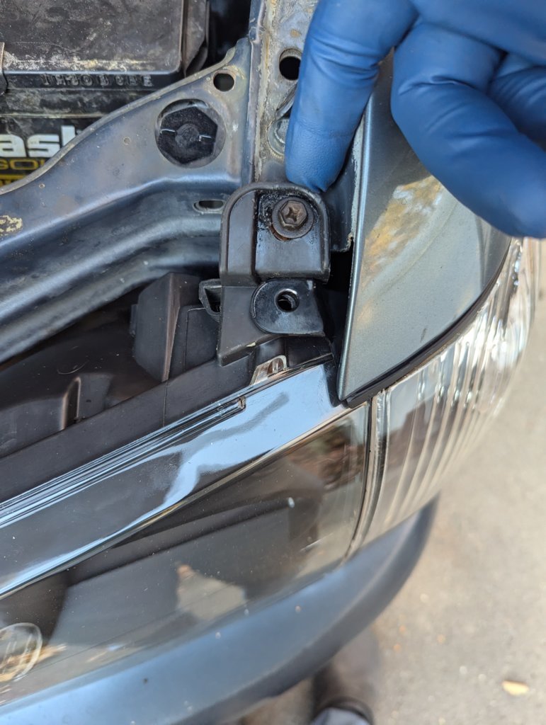

    Both headlight assemblies did not mount evenly and contact on all 3 mount points when initially installed on the truck . I used 3 stacked rubber washers on the mount between the headlight and the corner light. I also now see that I need to tighten the bolt another turn or two.
  9. Nov 27, 2024 at 9:41 AM
    G_unit3000
    G_unit3000 [OP] New Member
    Jun 25, 2024
    #118959
    197
    Gman
    North East
    2005 Tundra DC 4x4

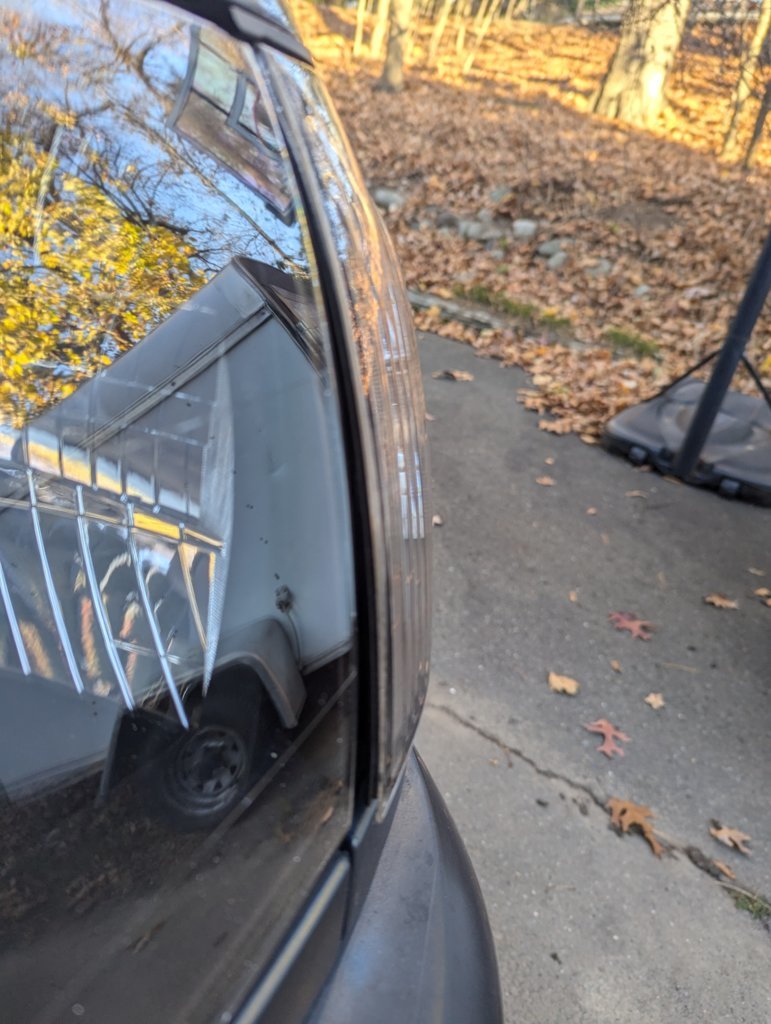

    The headlights and corner lights now sit flush on both sides.

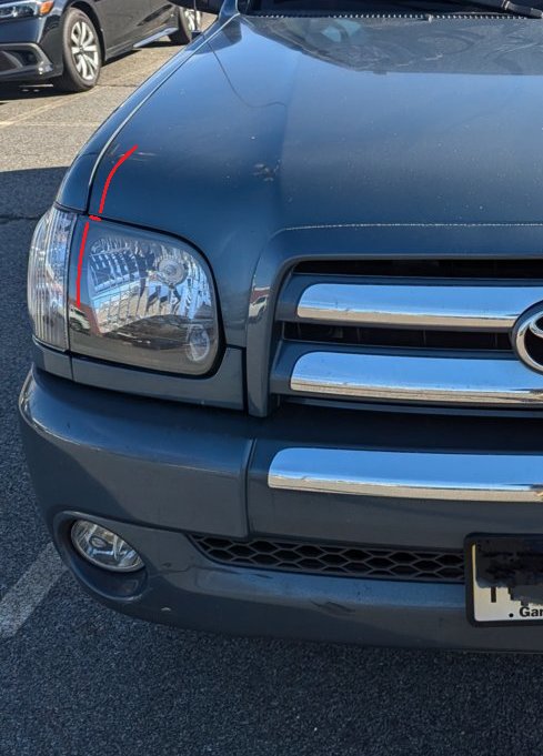

    The body line alingment issue (hood to light) with the DC really harshes my OCD. Like, c'mon Toyota, couldn't you not have it jag like that?

    Ugh, cannot be unseen! Lol

    Why did you have to bring this to my attention

    Because someone else on here pointed it out to me this past year, and I never noticed it before, and I can't seem to un-see it now.
