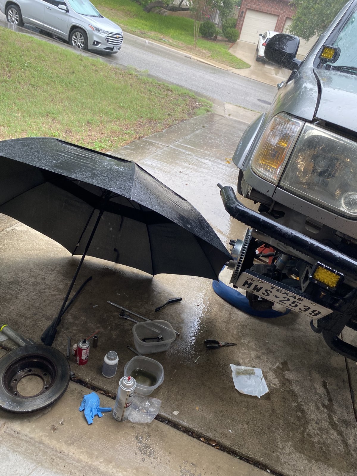

    this pic is to show how well SuperLube holds up in wet. We had about 3 days of solid rain after I installed these and I’m a distribution driver so I was all over the roads and the lube held up amazingly well in some of the wettest conditions I could of put them through.

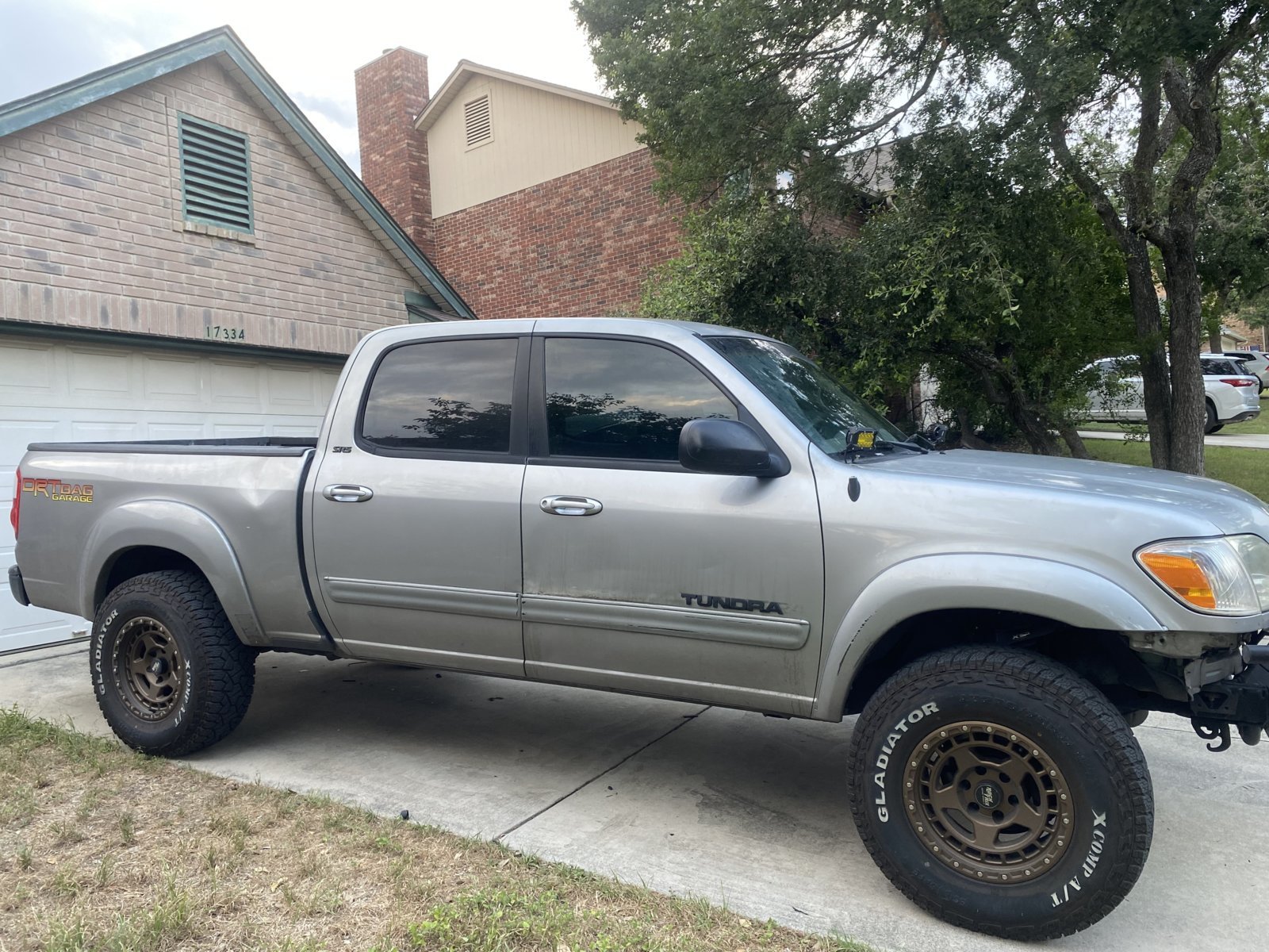

    I have returned.

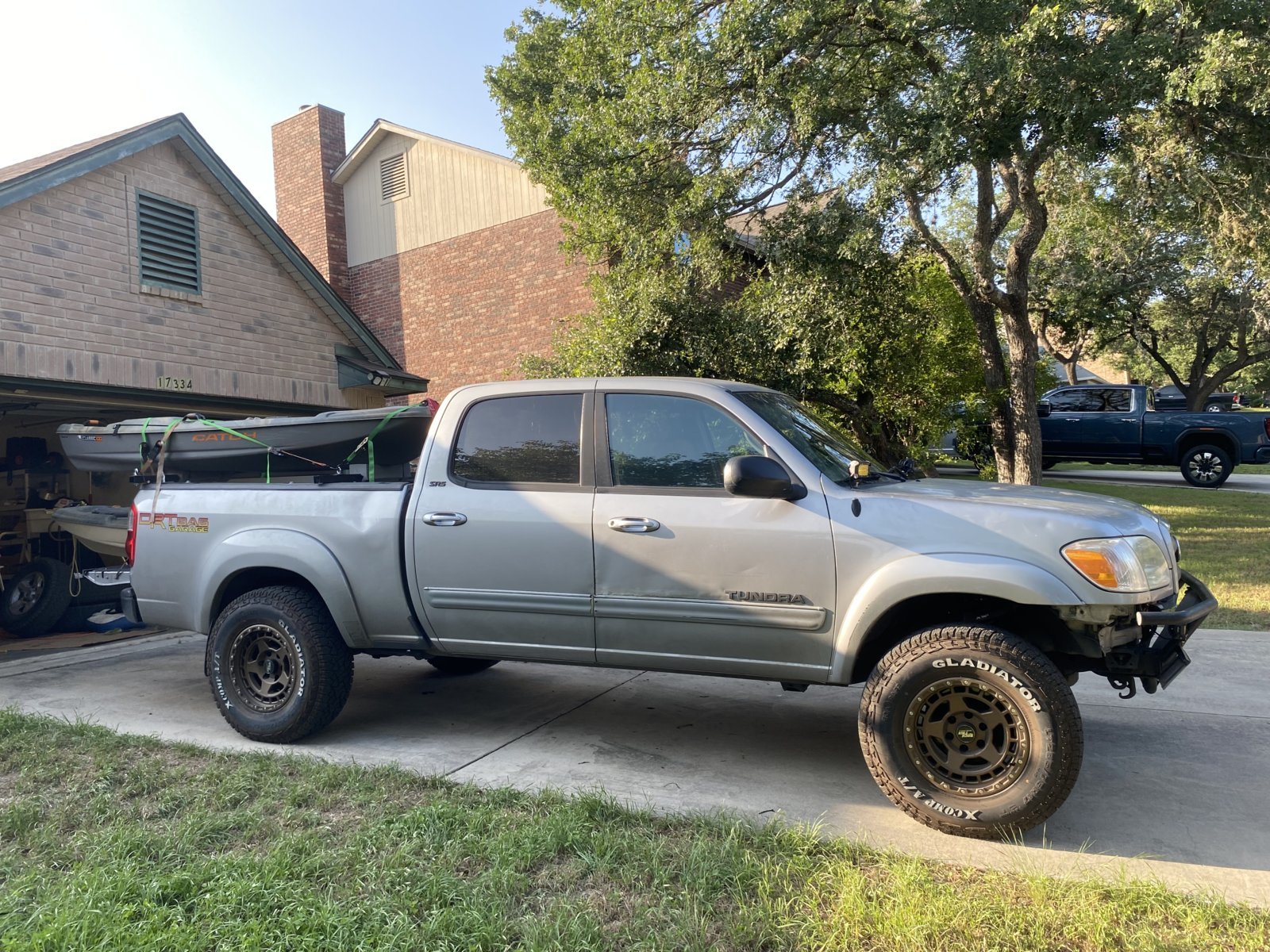

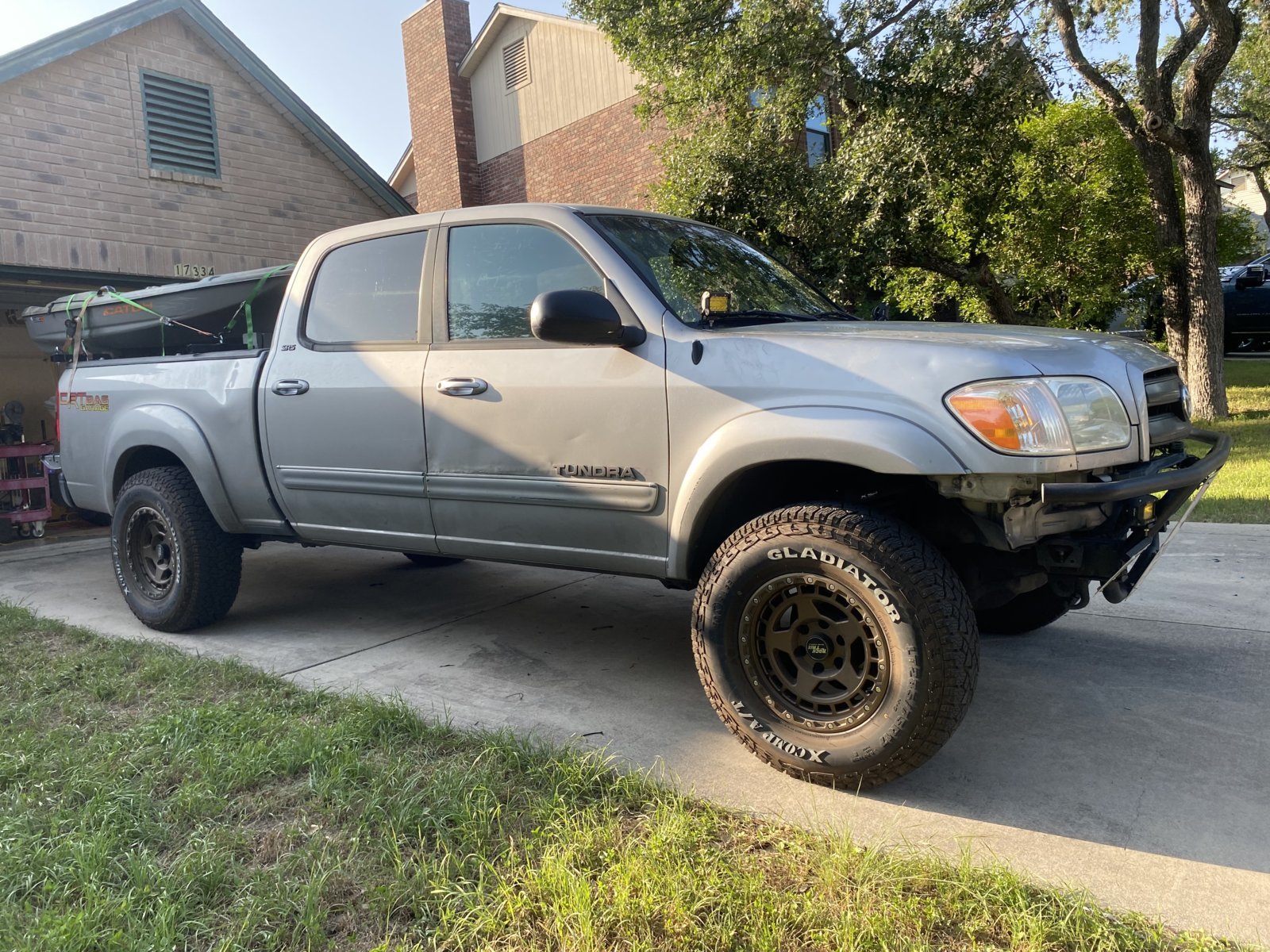

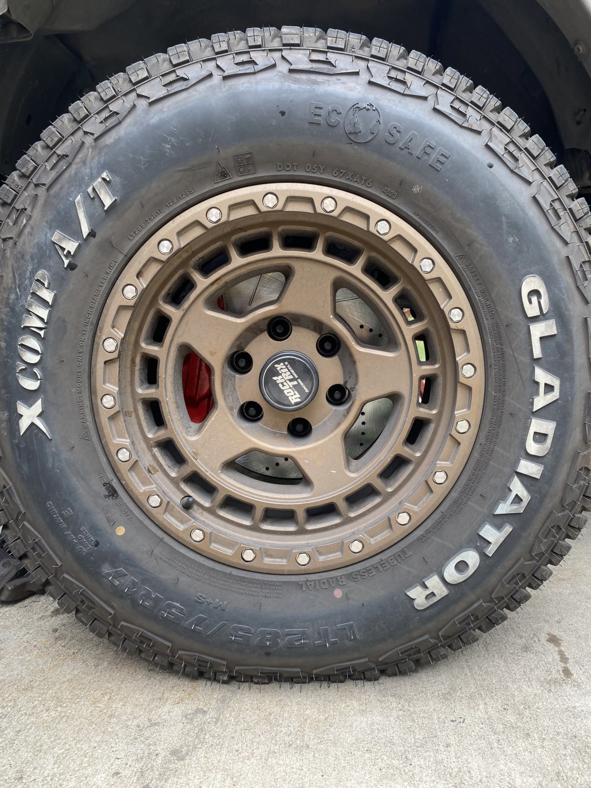

    Wheels came in
    285/75/17's mounted and ready
    all in all the install went smooth as silk. Thanks to @memario1214 @ HotShot Off-road for the 5100's/2885's. KSP UCA went in smooth. Used red n tacky for the bushings and new ball joint.
    Annndd how she sits currently.
    Has just the right amount of poke
    Set up is a 17x9 -12mm ANNNDD a 1" spacer. tires are 285/75r17
    Pinch weld was the only thing I rubbed, but I believe that's due to my lack of a front bumper
    and for all the haters
    SharkDog, Hutcheson, B.Ross and 9 others like this.

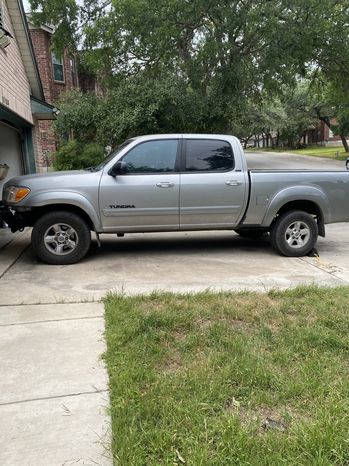

    Here are some before/afters. I should have put the stockers back on to see how much lift. With 5100's/2885's on a DC 2WD for y'all nerds. But I was impatient.
    it's definitely at a point where it's settled so I'll take more measurements today. Or my eyes are just used to the heights already.

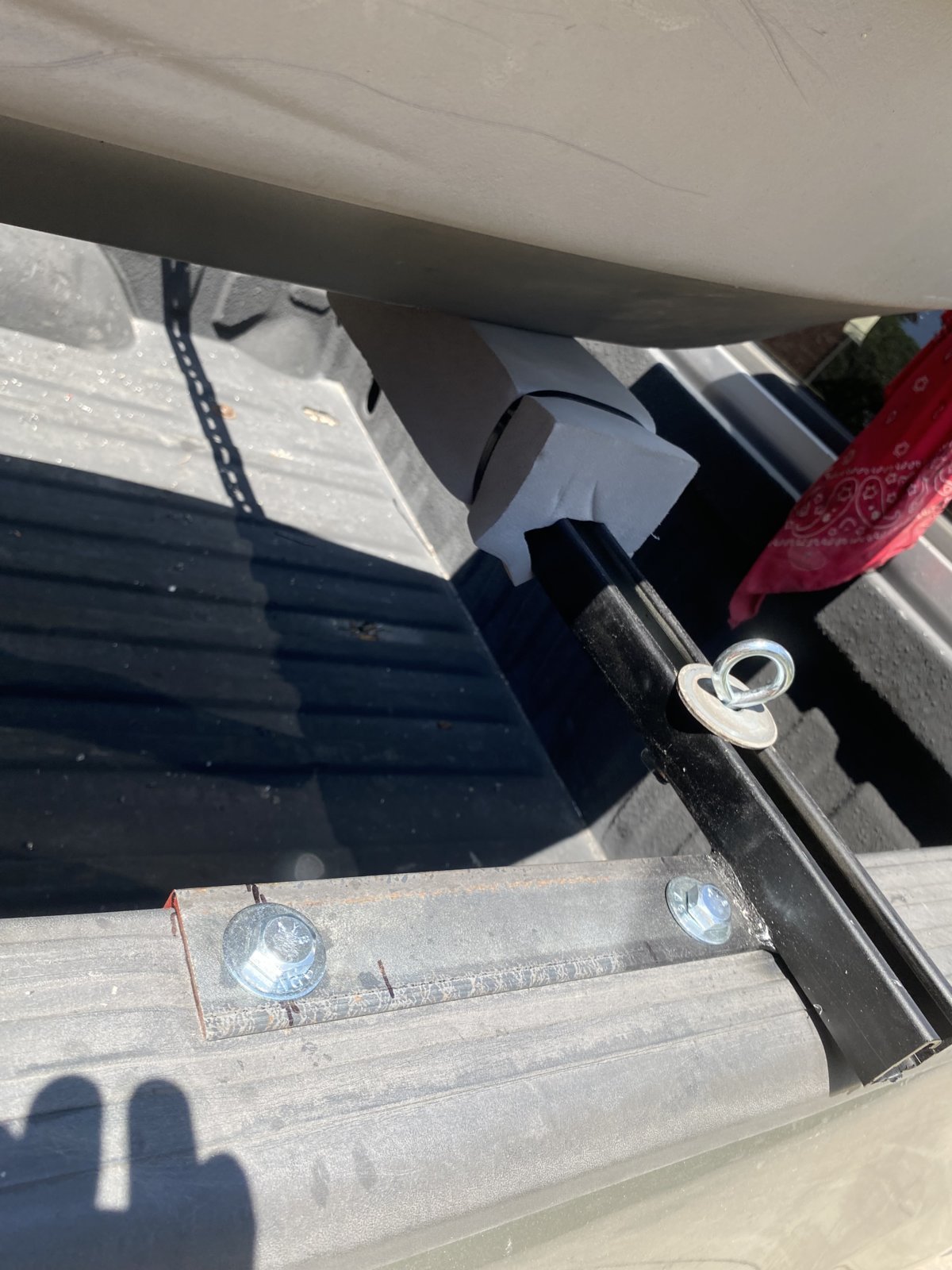

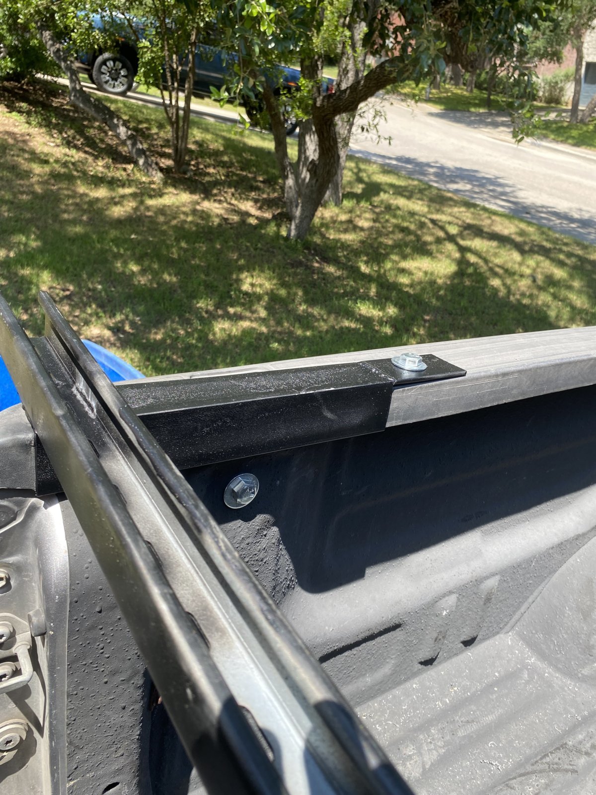

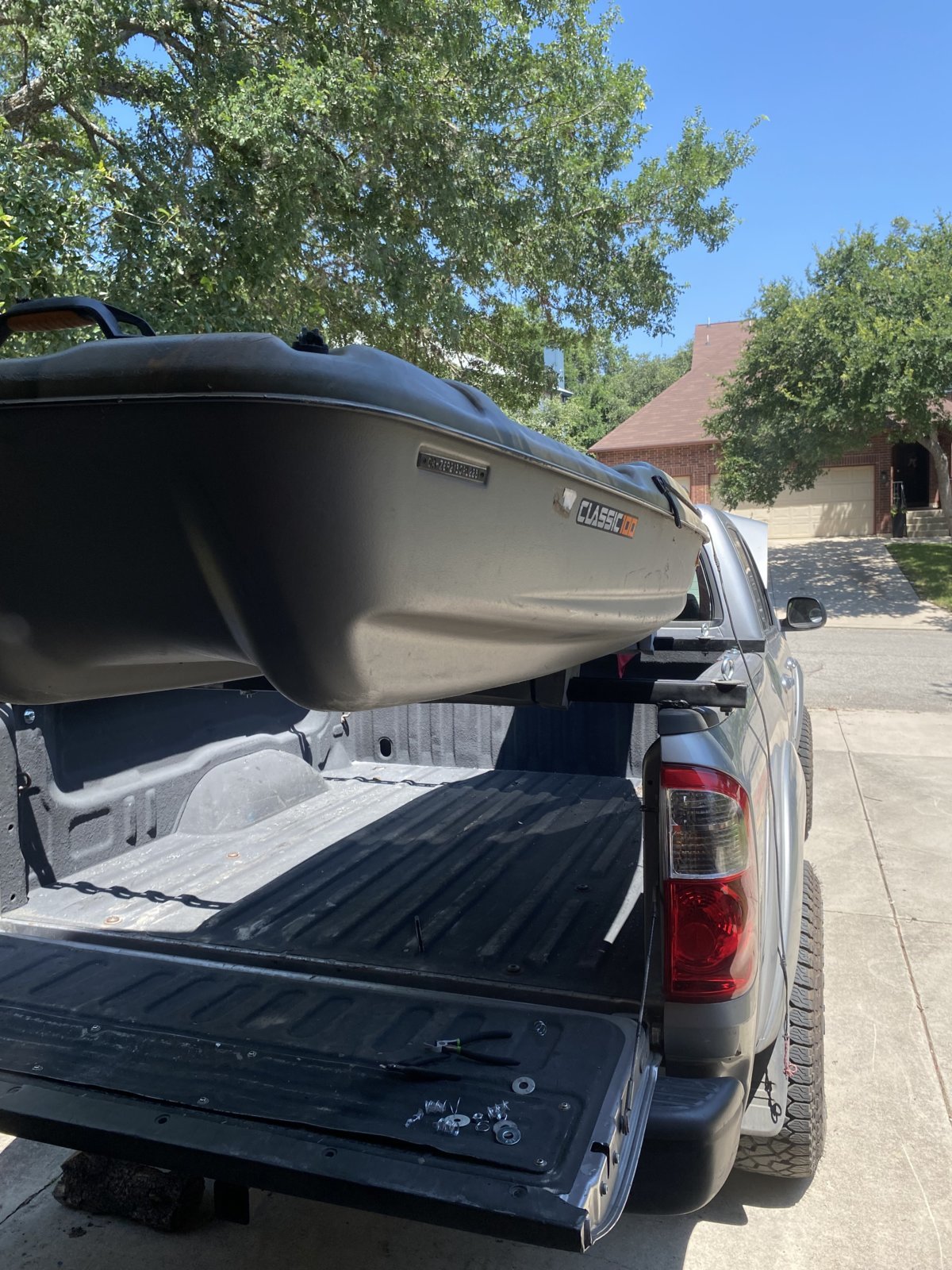

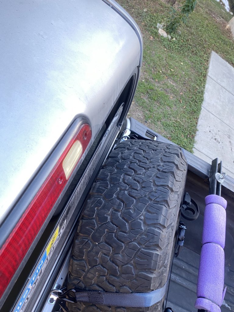

    Finally got the time to put this Kayak Rack together. IMG_4545.jpg IMG_4546.jpg IMG_4544.jpg

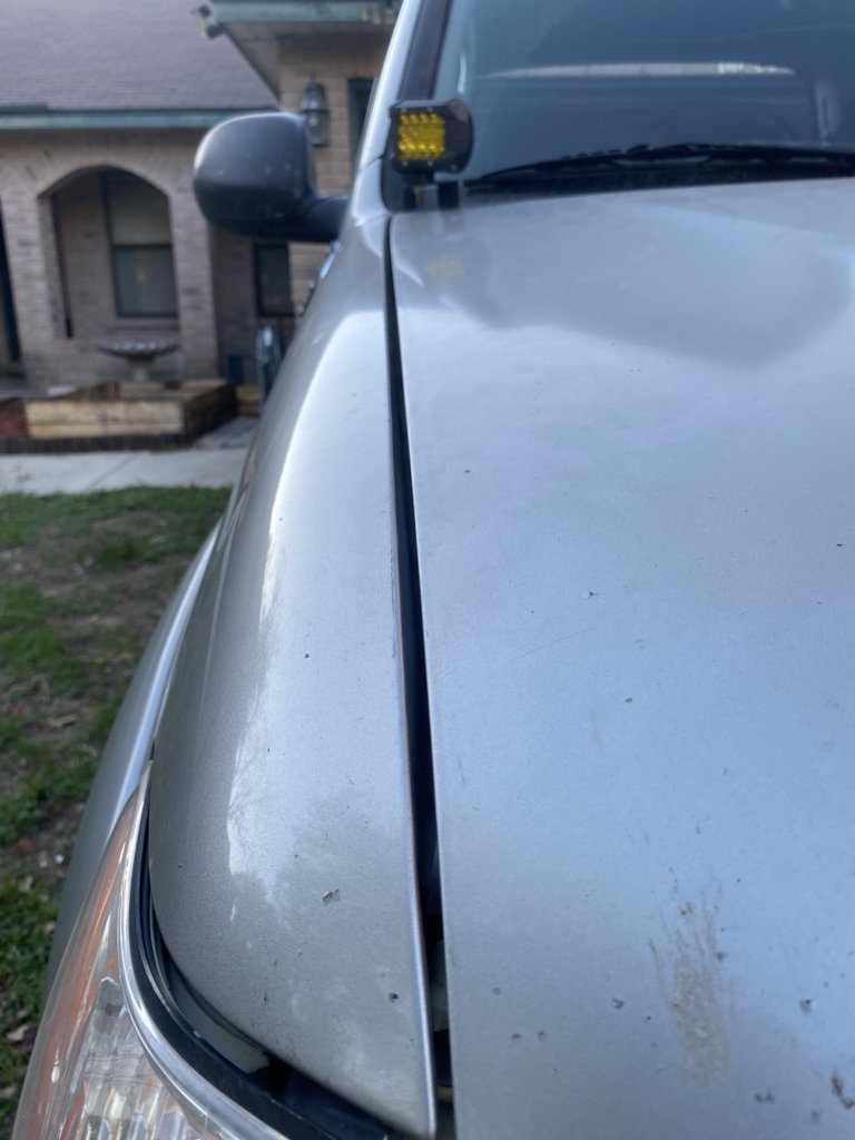

    Also put the ditch lights on. Dealing with the hood was the most annoying part. A lot of muscles are cramping/don't wanna function properly right now.

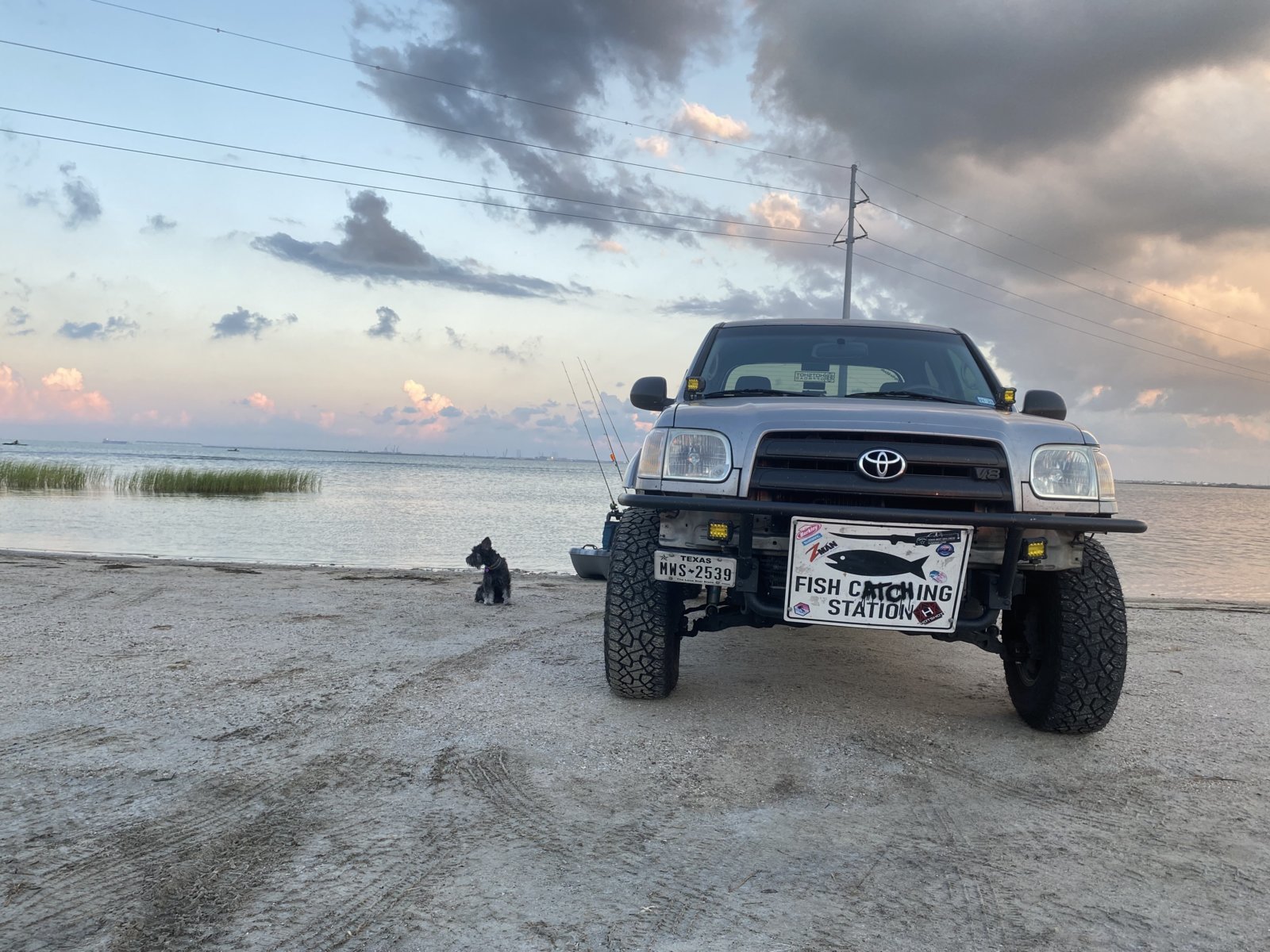

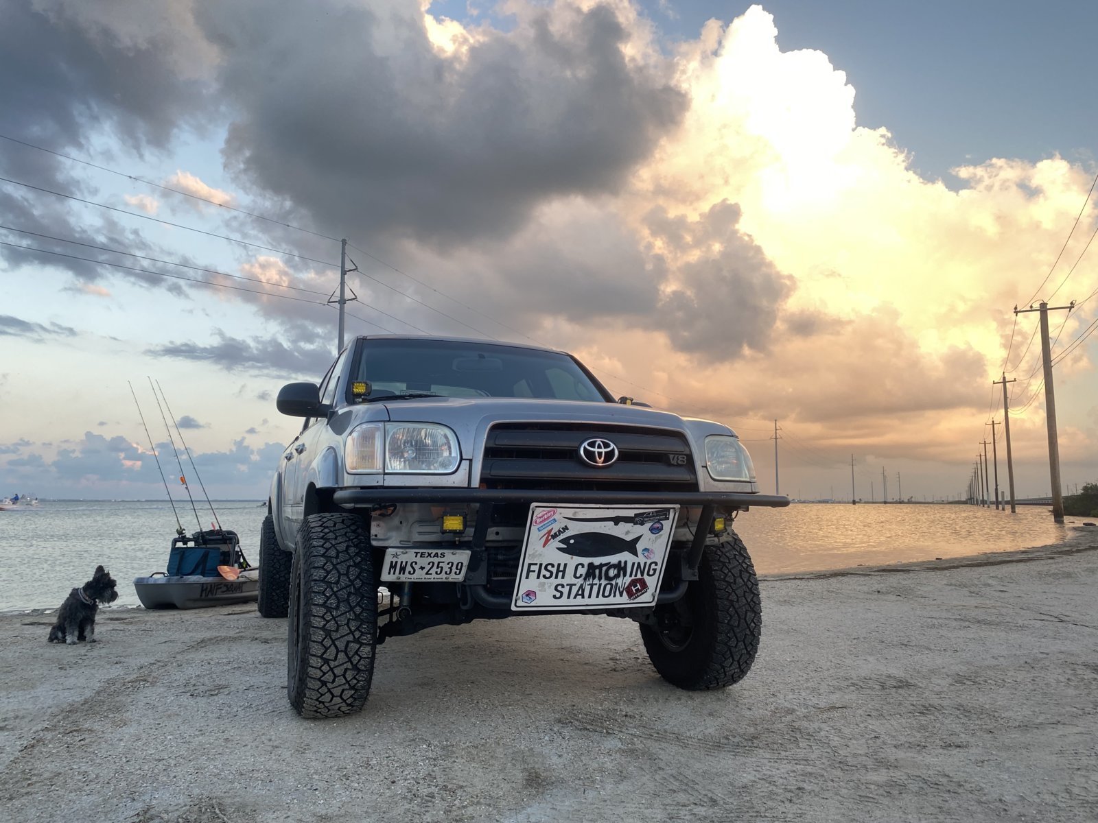

    Did another run to a coast. Took some cool sunrise pics. Slayed some redfish. IMG_4626.jpg IMG_4624.jpg IMG_4623.jpg the truck also got some crazy good gas mileage. I was surprised seeing as everything is oversized, but I'm getting better highway mileage for sure.

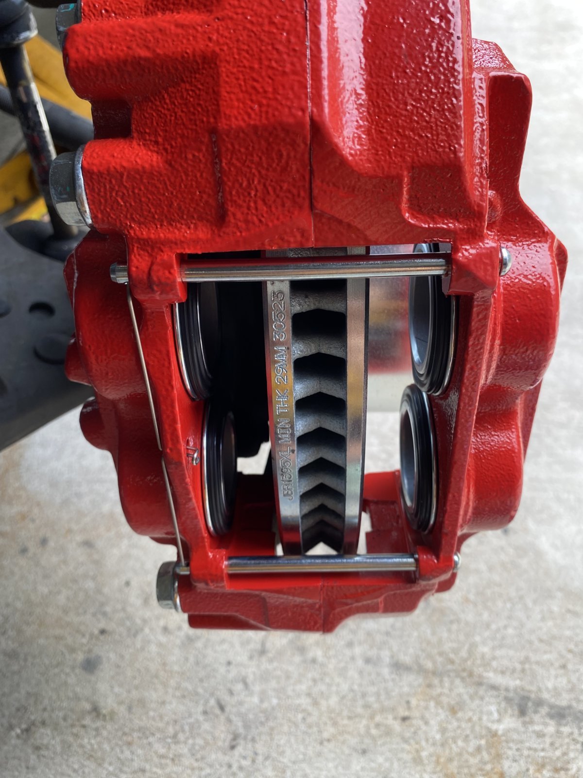

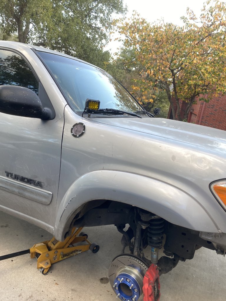

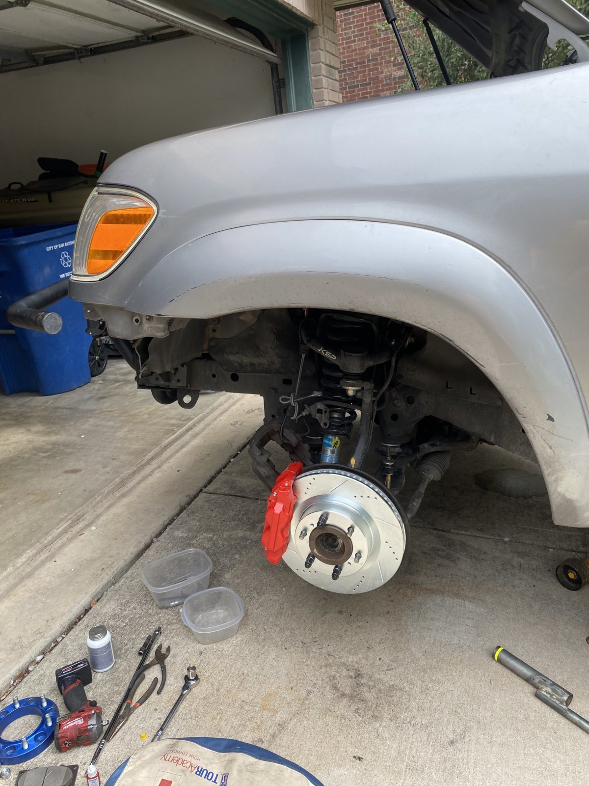

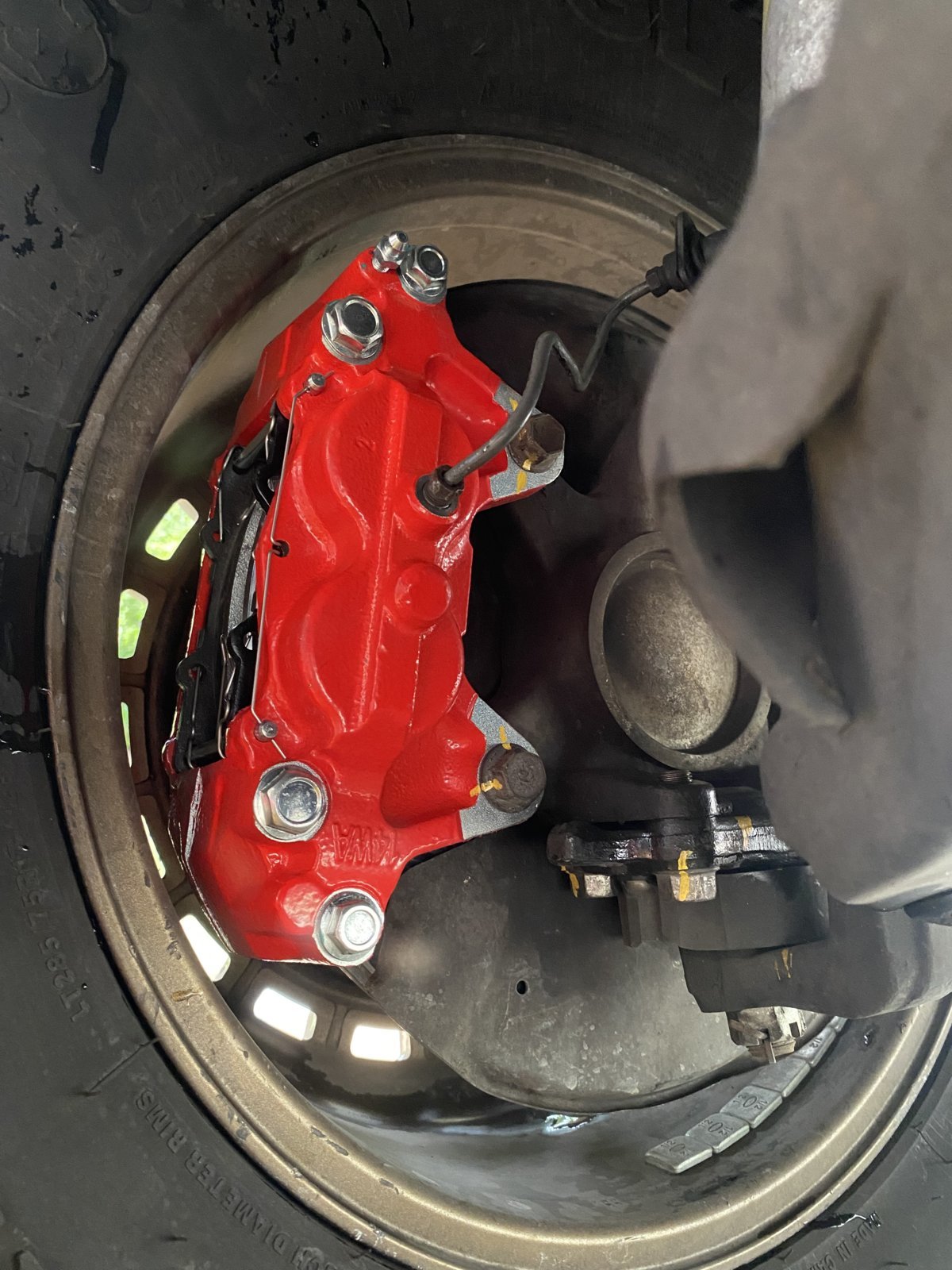

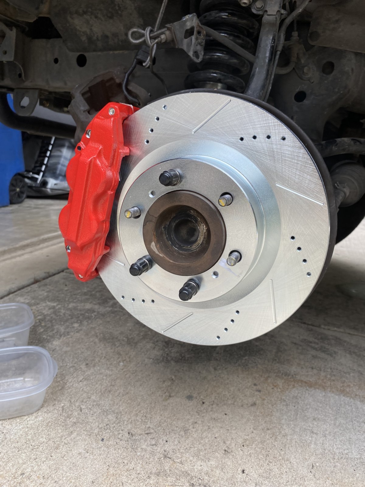

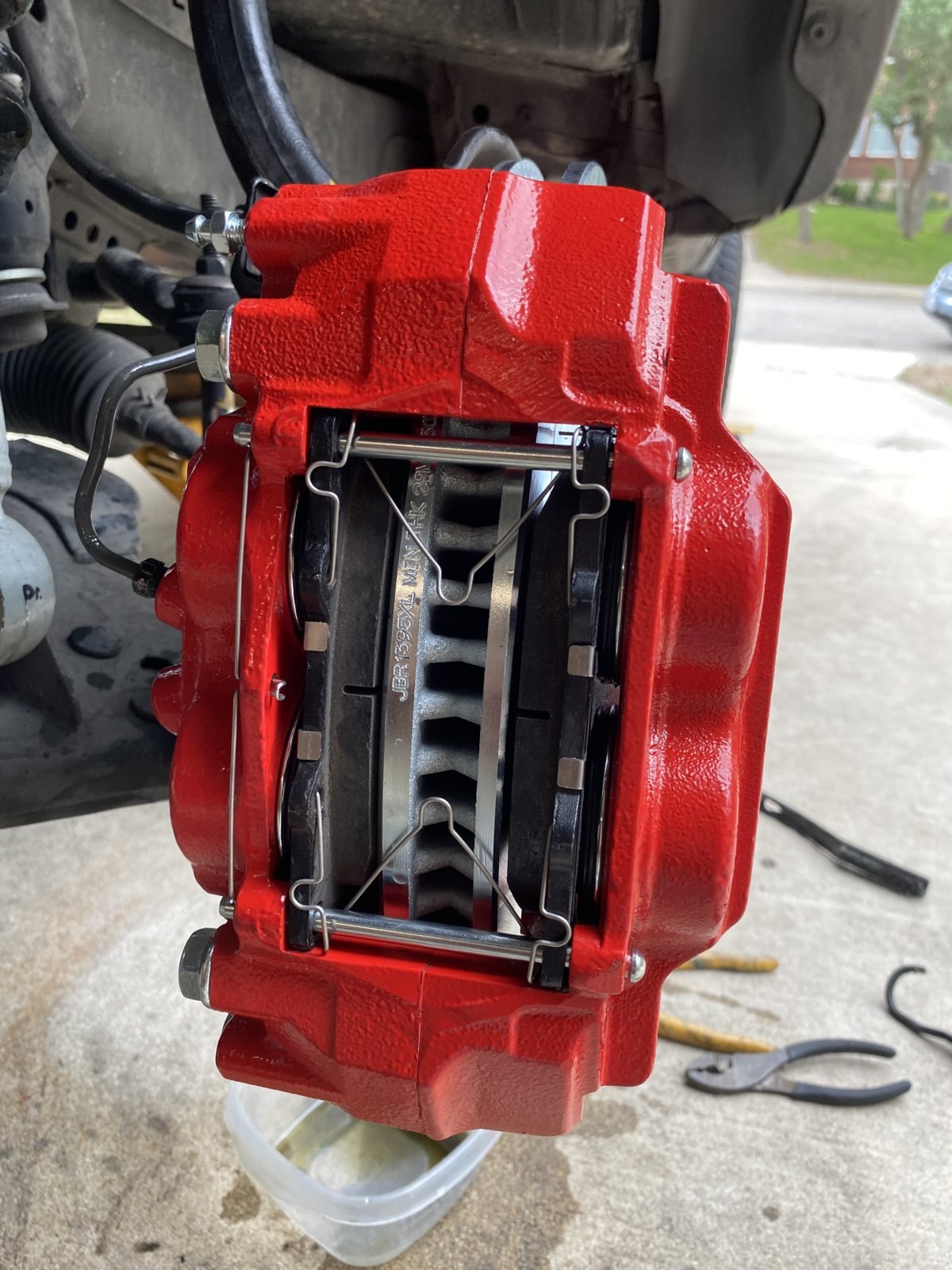

    2010 4Runner/GX460 brakes installed.
    Jim Smola from FB is where I got them milled. You can message him directly. He recommends OEM (duh) but others he recommends are Callahan and TRQ. Cal was out and I wanted the yellow powerstops. He said he had a few start to leak over the 4 years he's been doing this so he kindly recommended not to get them so I went with the red TRQ.
    Rotors and pads are PowerStop Truck and Tow.
    Milled to perfection. They bolted right up with zero issues.
    You do have to "massage" the brake line into place. But it's nothing crazy and shouldn't be too anxiety inducing. The sketchiest part was I took my brake lines off with a 10mm and not a crows foot. THAT was sketchy.
    Then Mother Nature said "you gotta chill, you're going too fast"
    went out to do the "break-in" procedure per recommendation via PowerStop.
    conclusion:: she stops WAAAAAYYYYYY betters. And I'm almost positive my little shimmy while driving is gone. Not 100% sure on that now I'm thinking one of my calipers was stuck or the driver was torqued too tight. (Had to get the breaker bar AND a pipe while the pass. side took minimal effort with the breaker bar)
    and some comparison pics.
    2010 4Runner/gx460::
    Things I would note. Dr. caliper and Pass. Caliper aren't marked sometimes. Just make sure the brake line hole is pointed up; And the bleeder should be at the Top of the caliper.
    I also looked everywhere to see the proper configuration of the pads and it seems that squeeler inside/bottom is how most factory vehicles have it positioned.
    J&ATundra, KNABORES, bmf4069 and 5 others like this.

    2004 DC Limited
    Which ditch lights/brackets did you end up going with?
    FishNinja[QUOTED][OP] likes this.
  20. Jul 22, 2024 at 12:58 PM
    FishNinja
    FishNinja [OP] HIDE YOUR DAUGHTERS
    Jan 3, 2024
    #109562
    2,181
    Lee
    TEXAN....big surprise
    06DC2wd
    '05-'15 Tacoma ditch light brackets from GS power (scAmazon) and NiLight for the lights. Just so you know 1 out of the 4 NiLight LED pods I have has fogged.
    Hutcheson[QUOTED] likes this.
  21. Jul 22, 2024 at 2:10 PM
    Hutcheson
    Hutcheson New Member
    Jun 12, 2024
    #118342
    104
    Caleb
    2004 DC Limited
    Good to know about the ditch lights. Was there any cutting of the wiper cowl involved to fit the brackets? Seen a few cases where that’s required

    negative ghostrider. Bolted right up and clears perfectly. I will say::
    I would 100% recommend you cut slits into where the bolts, half loosen the hood bolts and go to slide the bracket on and bolt it down; as opposed to removing the bolts from the hood entirely to do this. The hood shocks are CRAZY strong and I got the workout I never asked for while trying to do this by myself.
    eventually I just completely unbolted the hood shock and handled it that way. It sucked. 10 out of 10 would not recommend

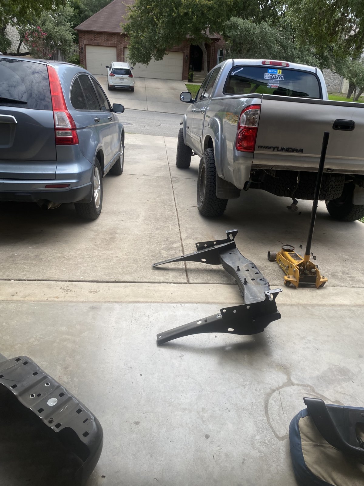

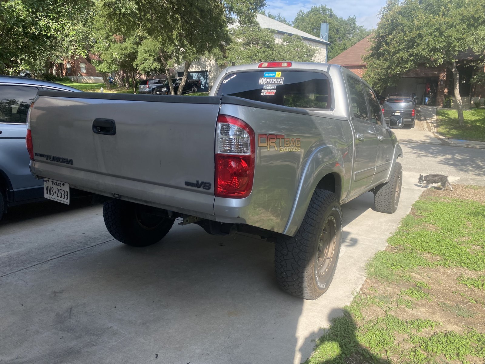

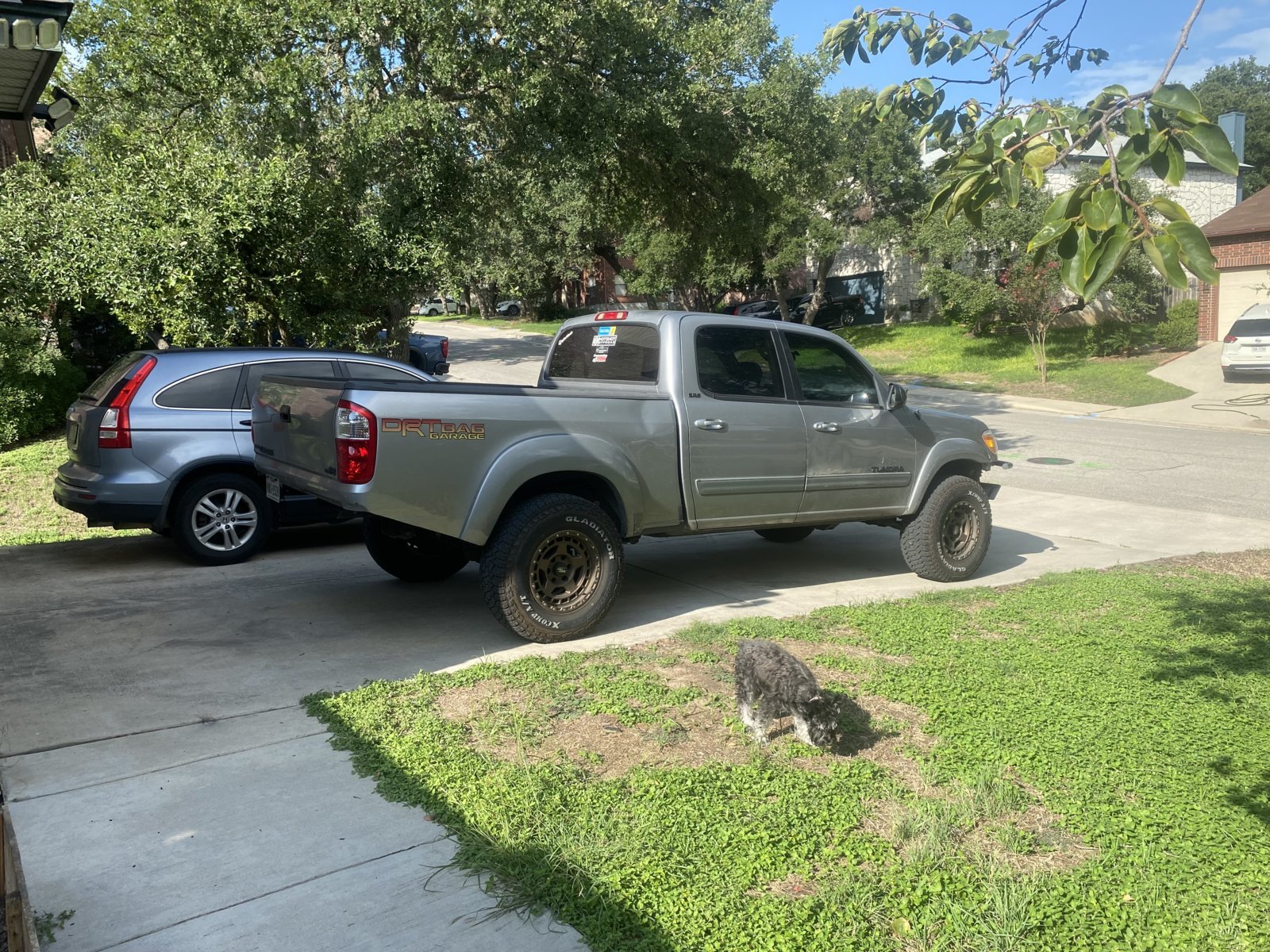

    Gave ole' girl a booty lift. IMG_4851.jpg IMG_4854.jpg IMG_4855.jpg IMG_4857.jpg IMG_4859.jpg IMG_4864.jpg

    Looks great. You planning on a tube bumper or just running it as is? Does anybody make a high clearance hitch for these? I don't tow that often but would be nice to keep the capability
  25. Jul 29, 2024 at 9:06 PM
    #25
    FishNinja
    Jan 3, 2024
    #109562
    2,181
    Lee
    06DC2wd
    I'll make a bumper for it soon enough.
    as far as hitch is concerned; I'm not too sure. I don't tow often either but I got a old hitch, off a ford, I can hack up and make something out of if I really need it
    Tlar25[QUOTED] and FrenchToasty like this.

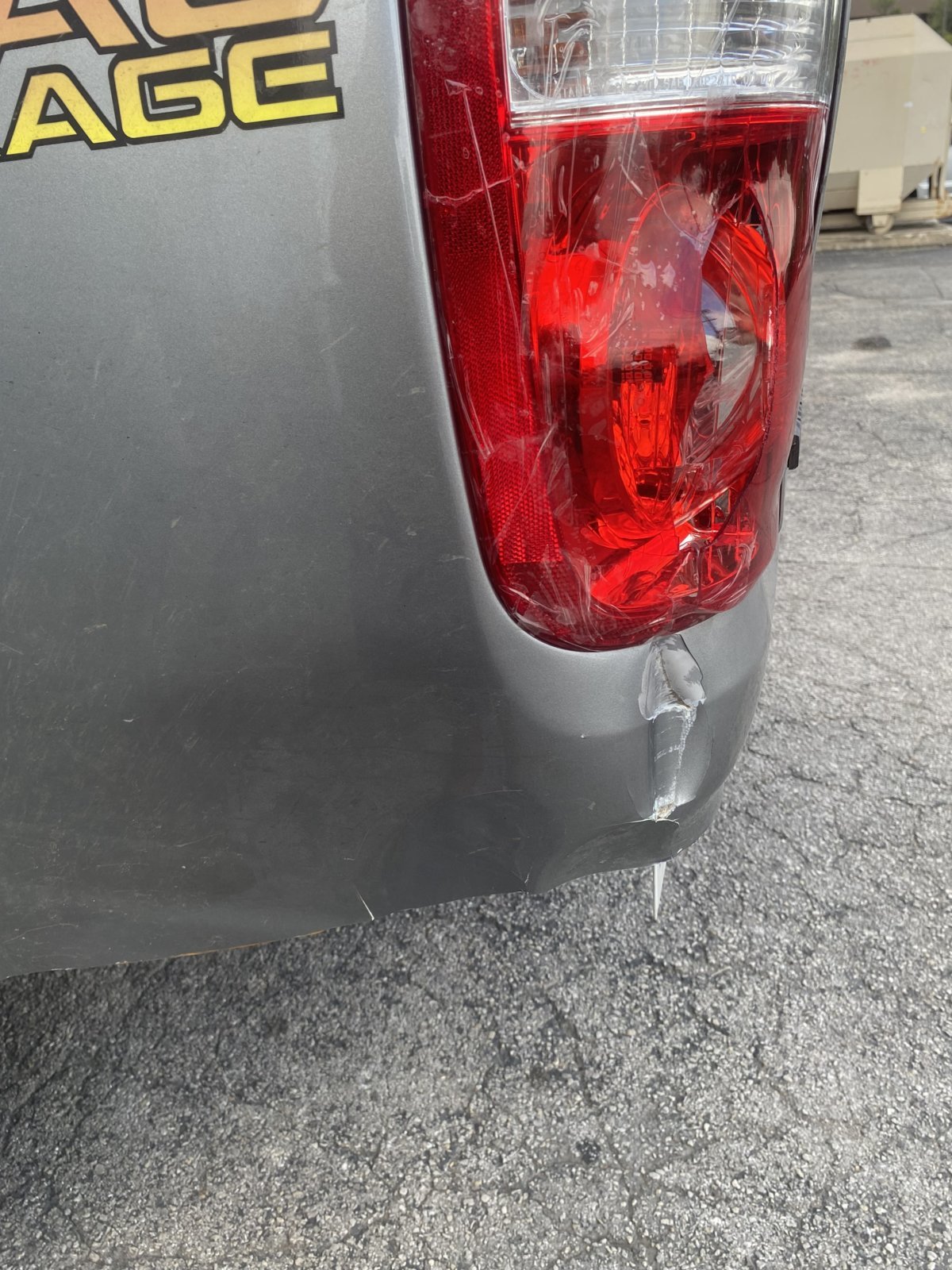

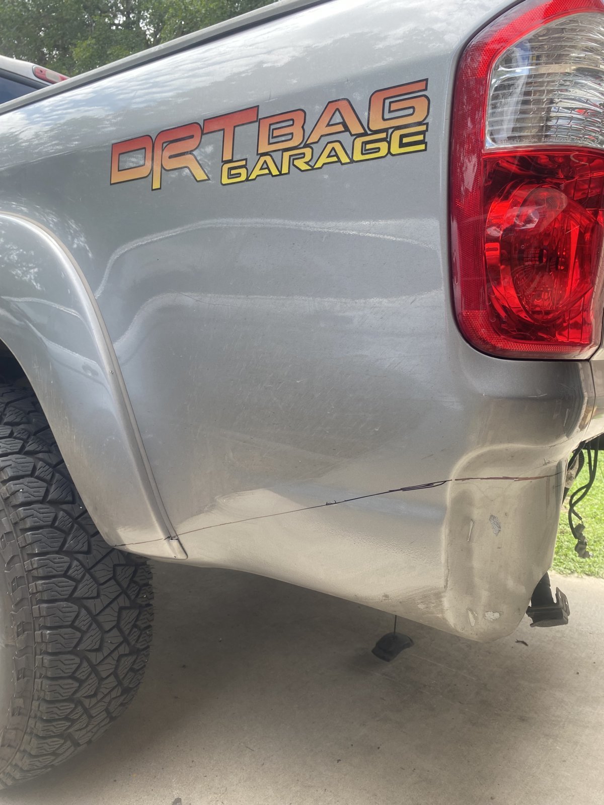

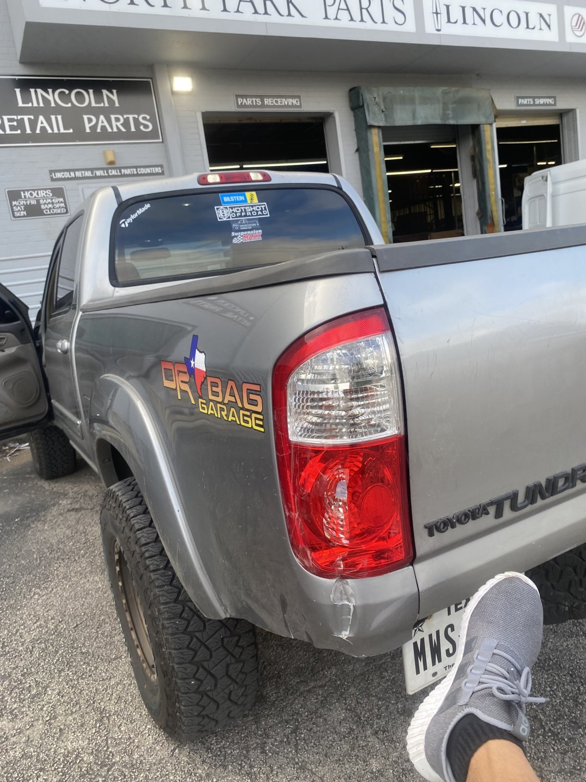

    Lol first thing I thought
    "it would have been nice to have a fuckin' bumper right about now......"
    The Toyota on Toyota violence has got to stop.......

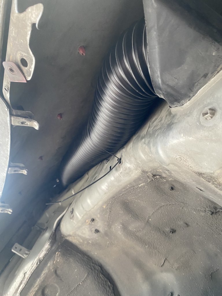

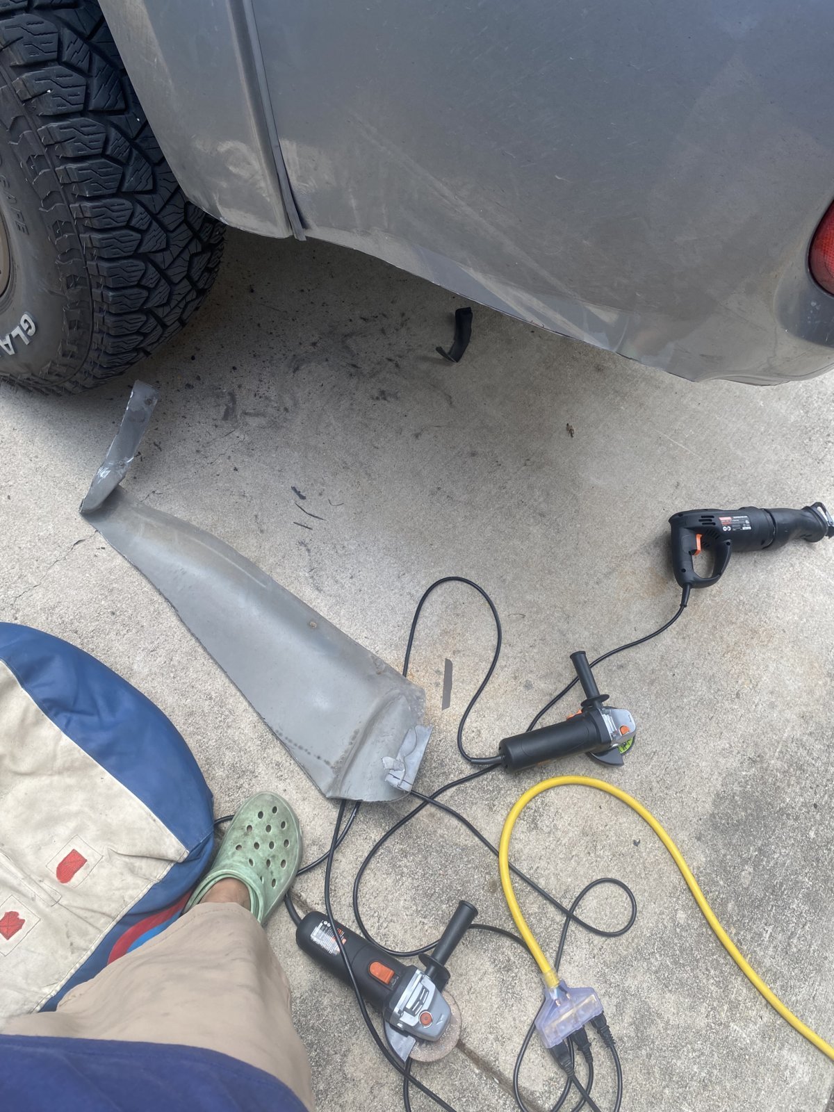

    So I've been up to some shit. And I'm terrible at updating. My dog just died last night. She was the best. Can't stand being in my house So today I went and finally did the spare relocate.
    Ive had to drive on this KO2 once. And I fucking hate it (LOUD) I need to change it out asap. But it holds air and will get me through most shit so it'll kinda just hang out for the moment.
    I also did a "Texas snorkel" since I had to gut my pass. fender well. Did some more sledge hammering and routed some 3" intake tube to a 3" intake duct I got off the zon. IMG_5113.jpg IMG_5115.jpg
    had to cut out a good amount to get the tube to sit IN as you can see. Otherwise I could NOT (for the fucking life of me) get the fender to bolt on.
    it's bolted on now, but fuck me if the gap isn't shit.
    next will be some sort of pre-filter sock that I cut out and adhere to a ring that has some magnets so I can just pop it over the intake duct on the outside of the fender.
    it's rained multiple times and no issues yet. But the pre-filter would be a nice "peace of mind" modification and would also look a little more modest compared to a gaping hole in my fender
