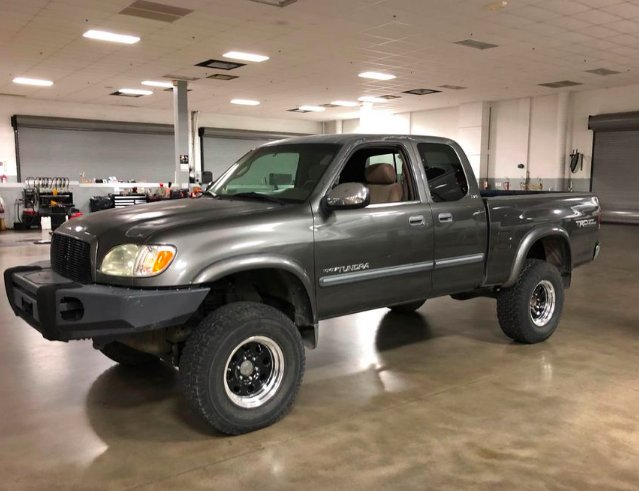

    Here's a photo of it, don't worry I put new shoes on er haha.
    Thanks in advance for any help! Cheers!
