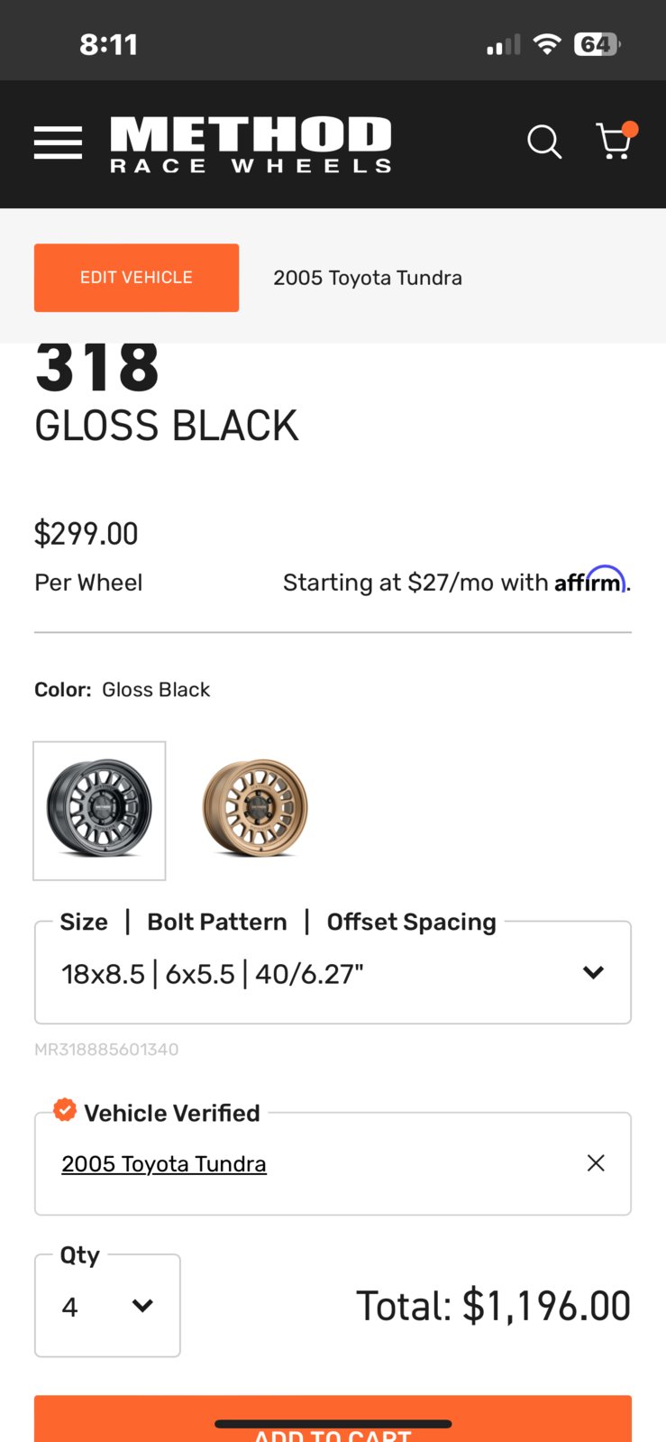

    Hey all. I ended up finding a great deal on some method 318. I know this is a larger diameter and the offset and backspacing are different than the stock 17 in tires I currently have. I don’t fully understand offset/backspacing. I believe the 17 in are +12 offset while these are +40? Is that correct? And if so does that mean the wheel sticks out of the wheel well more or is it tucked under the wheel well more? What tire size would fit without rubbing using this backspacing offset of the method 18? Thanks for all the help and info!

    No way those fit your truck. 8.5” wide with +40 offset is 6.3” backspace which puts you with tire pressing on your suspension and in frame (if no spacer used, and spacers defeat your cost savings). https://www.customwheeloffset.com/tire-wheel-backspacing-offset-calculators
    OEM 7.5” wide wheel backspace is 5”
    Ideal backspace at 8.5” wide wheel is 4.75”
    Ideal at 9” wide wheel is 4.5”
    This is a summary of the general 1st gen’ers collective experience.

    That’s sad to hear. According to their website it says that the wheels should fit the truck.
