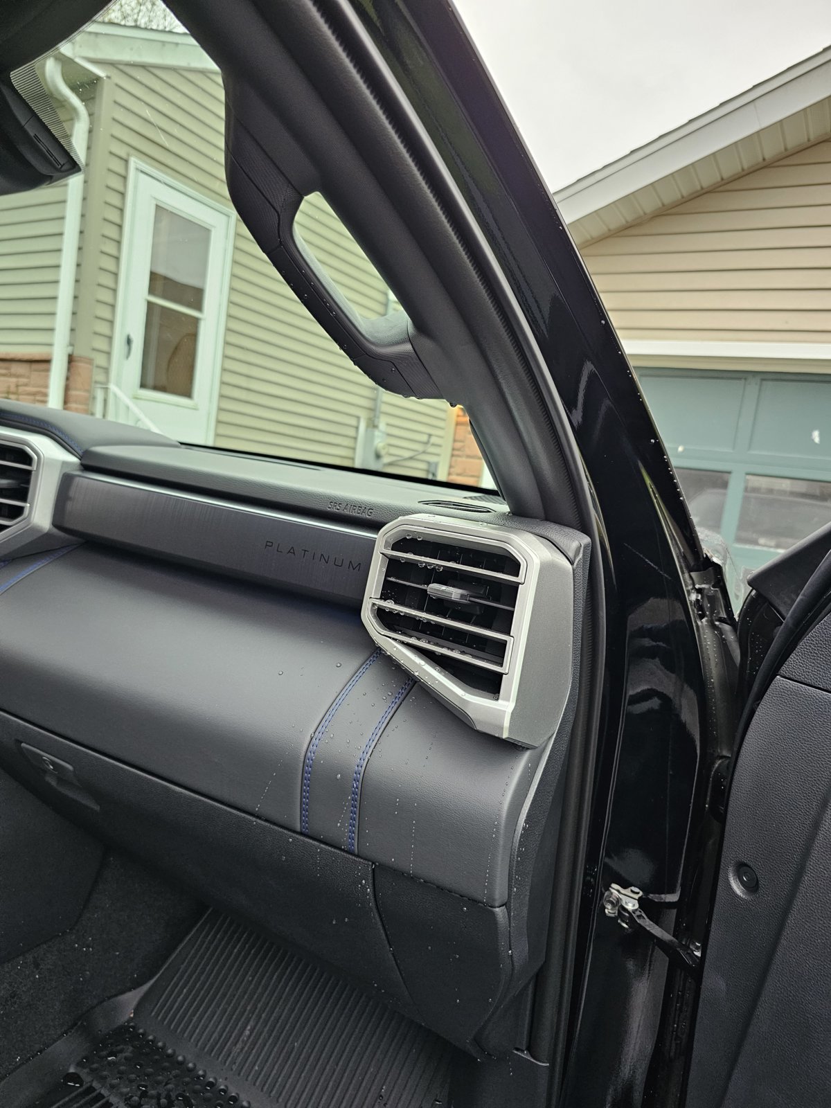

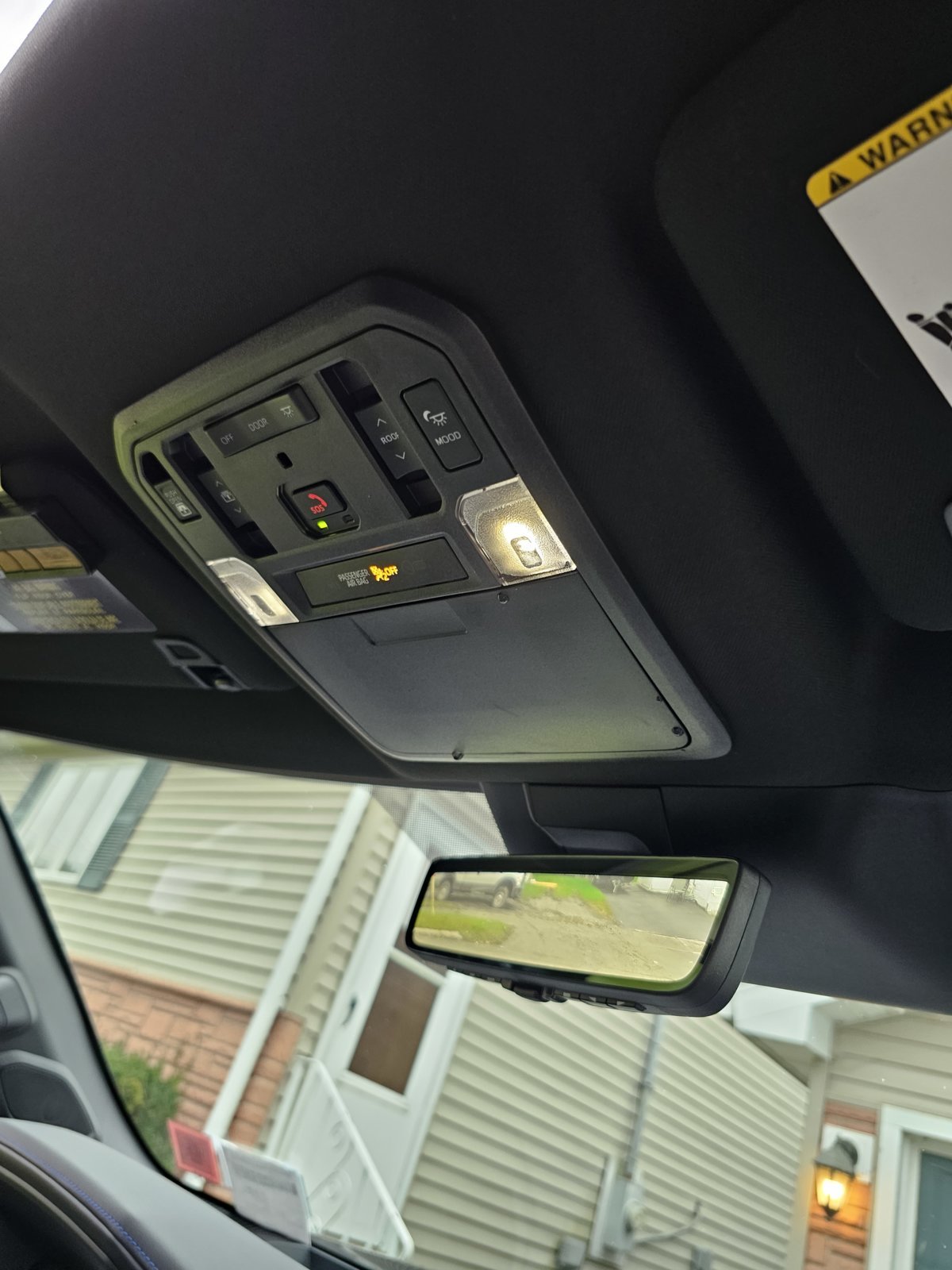

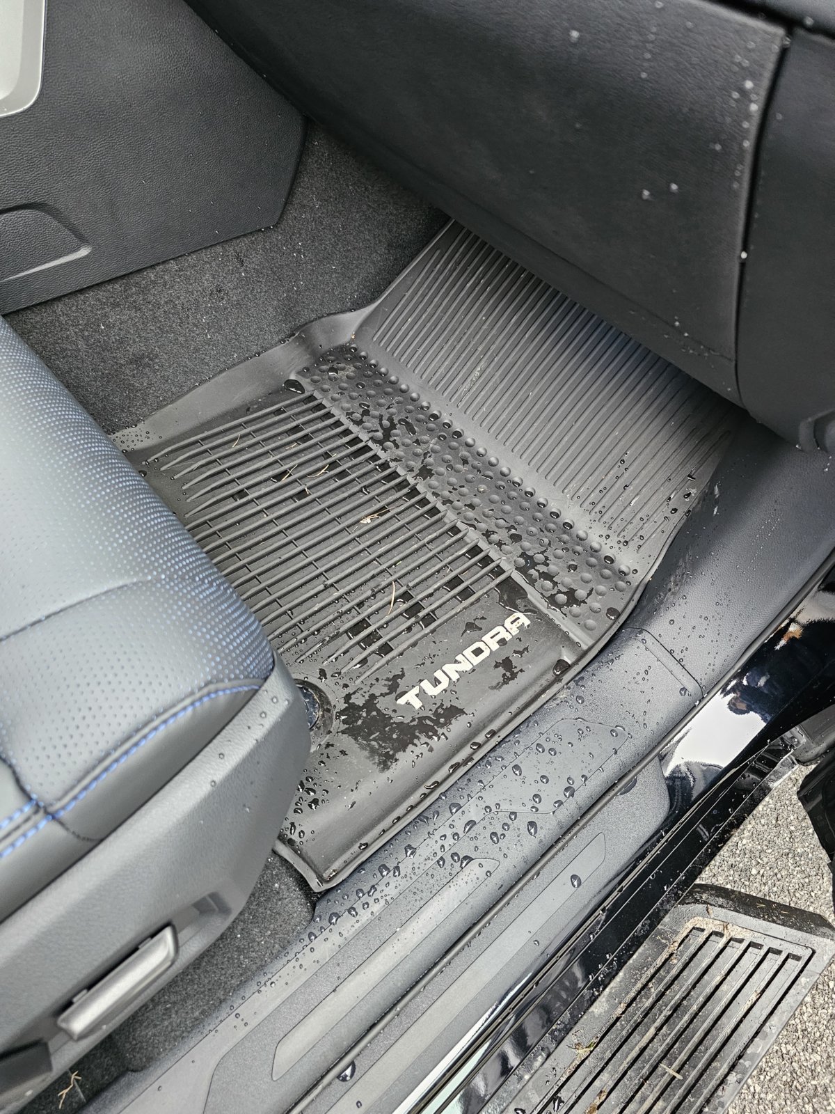

    20231030_155312.jpg 20231030_155314.jpg 20231030_155309.jpg 20231030_155232.jpg 20231030_155316.jpg 20231030_155320.jpg
    2024 Tundra Splash Mountain Edition?
    Deer Hunter, Bakershack, Kap1 and 3 others like this.

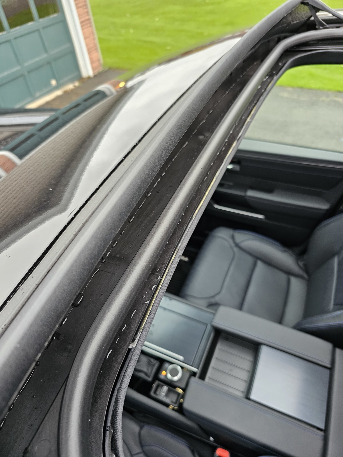

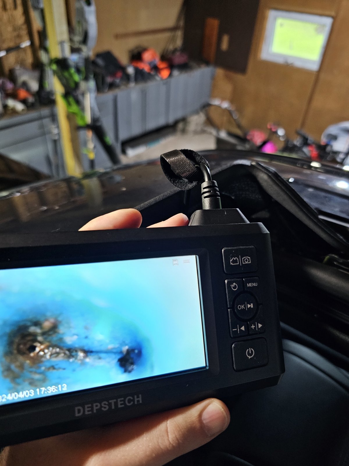

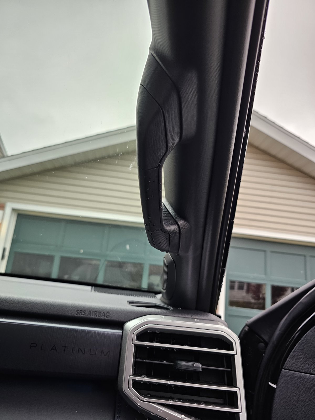

    I guess I never followed up. Later in November 2023 the local dealer said they found the passenger front sunroof drain and the AC condensate lines plugged and they blew them out with air. Fast forward to today, 7/31/24 and the passenger side is blocked solid in the same location based on depth of trimmer line inserted and the same downpour in the interior. I have an appointment with the local dealer again next week. The sunroof pan is absolutely spotless so I don't see how it could be debris and I generally only park the truck outside at work so I doubt it is more "insect nests" as the dealer claimed last time.
    I tried a 1/8" steel coiled drain snake and compressed air neither of which made any progress. The drain snake hit the same point as the trimmer line and stopped and I couldn't get enough of a seal with the air compressor blow gun with a hose on it to do anything. The drain hole is larger in diameter than the slot that you have to pass through to access it so I'm not sure how I could make a seal to pressurize the tube.
    I pulled the A pillar off the passenger side and ran my borescope down and can see the line all the way down to way it makes a right turn and seems to go inside the body. Right around there is where the depth gauges get stuck. As far as I can see from the roof pan down to that point there's no clogs or pinches. I am nearly positive the hose is kinked somewhere out of sight but can't prove it. If I could lower just the passenger corner of the sunroof and pull off the drain hose I could send my borescope down the tube to investigate.
    This marks my 3rd trip in for the leaky roof in less than a year of ownership and under 6000 miles.

    I bought a tiny diameter snake cam and was able to send it down the drain tube without pulling the headliner, behold, the pinched tube of calamity. I'm going to bring this and the camera to my appointment Wednesday.
