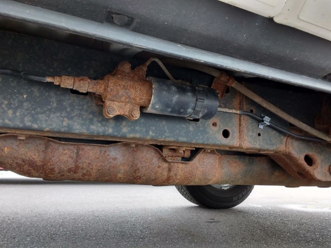

  17. Aug 14, 2022 at 9:04 PM
    BaneBlade323
    BaneBlade323 [OP] New Member
    Aug 14, 2022
    #81916
    34
    2006 Tundra TRD V8
    So , this isnt the truck, just an online image . it looked PRETTY much like this , but hardly any black , Almost all the rust color.
  18. Aug 14, 2022 at 9:06 PM
    NickB_01TRD
    Jun 16, 2021
    #64346
    2,702
    Nick
    KY
    01 Tundra V8 4X4 AC SR5 TRD
    That timing belt wasn't done long ago mileage wise but shows being last done in 2011 so it's time for another one just from age so factor $800-$1000 at least for that unless you're doing yourself.
    I'd be sceptical. Stop buy for a look and get a bunch of pics. Post here and we can help you out. For how much they are asking for it you could be out a hefty sum if you're wrong. Don't just get the outside of the frame rails get the inside of them and get a good one of the spare tire crossmember mounting points.

  20. Aug 14, 2022 at 9:41 PM
    TILLY
    TILLY Gently Used Member
    Sep 7, 2019
    #35797
    4,720
    Massachusetts
    2019 MGM TRD Sport D/C
    Unfortunately, that comparison doesn't really help as some surface rust is inevitable, and not really a deal breaker in most cases. If you really like this truck, have them send you better pics of the frame if possible. Keep us updated if you can.

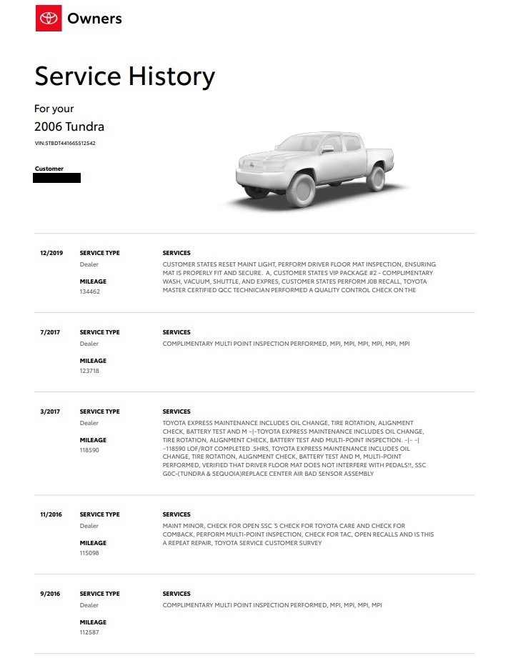

    This should be your Tundra with VIN # supplied 5TBDT44166S512542
    2006 Toyota Tundra For Sale in Chandler, AZ - Auto Hall (theautohall.com)
    As suggested, register an account at Toyota for complete service history and might even consider dropping by a Toyota dealer with VIN and they might supply a more complete copy of Service History.
    Temporarily added VIN to my acct and have now deleted but noticed certain things....
    * Oil change every 5000 miles since new but all Service History stops Dec 2019
    * SSC 70B Lower Ball Joint completed June 07
    * Feb 2015 Performed Frame inspec LSC with Op code 3628C1(Frame Inspected – No Significant Perforation Found)
    * Recall....Front Pass Air Bag replaced May 2016
    This is 1st page of Service record with my name removed....
    Remainder of Service History attached as PDF....

    seems everything after that was done at a tire shop according to the CARFAX. thank you so much though ! thats some great information , at least its been looked at , but ill still ask for pictures.

    Look, I'm gonna be direct: There is a veritable crapload of available, southwestern-only, rust-free trucks within 60-90 minutes of PHX. It's almost as loaded with quality, rust-free trucks as the Atlanta & surrounding area. Why in the hell are you looking at a truck in Utah?
    This thing is rusty. If there's that level of rust already on just the side of the rail, you need to be seriously worried about two things:
    1. What it's going to look like in the areas that tend to hold moisture and salt, if the vertical walls of the frame and weld seams are that rusted?!
    2. You see that part on the framerail? Imagine trying to break free any bolt on there with all that rust mechanically bonding it. That's going to be every part you need to remove, are you up for that?
    This would be a hard pass for me. Seriously. You've got so much in your area, what's stopping you from buying more-local? Price? Mileage? What's your concern here?
    The fact the owner went in for a frame inspection in 2015 should tell OP all that's needed. Someone had concerns 7 years ago that the frame was potentially compromised. While it wasn't then, given the proof of active driving from 2015-2019, that's 4 more years the frame has had to rot.
    I'd be shocked if this was a purely UT truck. Maybe it is, and it was used in snowy/icy areas where salt was utilized. I dunno. I'd hard-pass on this.
