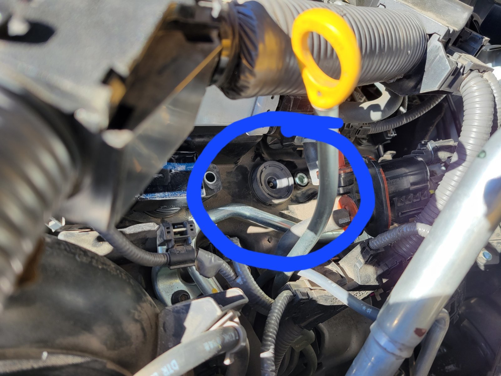

    Pulled & swapped 6x plugs yesterday....one of the coil packs came out it two pieces....here goes $125 on a new one
    Here's the factory plugs with 78k miles on them
    Here's the coil pack in two pieces
    Took 2.5 hours to do.
    A professional mechanic or someone who has done plugs on the new 3.5l power plant more than once could easily do it in 1.5-2 hours.
    Here are all the tools you will need
    The baby sockets are 8 & 10 mm
    Note- you will need 9/16" magnetic spark plug socket...5/8" is a no go
    Additional note- I took 1 plug out 10 days ago to take a peek at plug condition & the coil pack for the cylinder also came out in two pieces.
    This was the driver side cylinder closest to radiator. I replaced the coil pack 2 days later to be safe
    Yesterday it was the center cylinder on the driver's side that produced the issue (two piece coil pack upon removal, pics above)....
    Luckily all the other coil packs, including the one I replaced 8 days ago came out smooth & easy yesterday
    Good luck to yall when you swap plugs....toyota did not R&D this very well

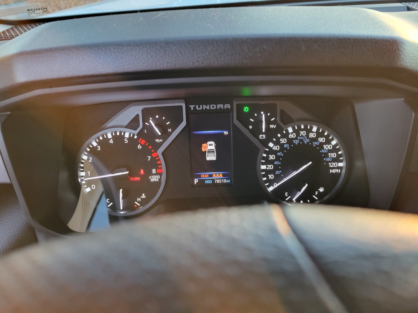

    & the odo---->

    Correct me if I’m wrong but the coil pack wasn’t broken. The boot and wire just came off without the pack. You are apparently supposed to replace the boot and wire combo when you change spark plugs so you are supposed to be able to just pull them off the coil pack. I didn’t do that on my 5.7 and it runs just fine but they are cheap enough so I ordered them when I did the 5.7 hemi on my wife’s Durango and they looked exactly like that. Pulled them off, put new ones on, works perfect

    I replaced 2 total
    I did reconnect the two bad ones & drove on them for a short distance...seemed okay
    But I drive 1000 miles in 3 days very regularly & can't afford the downtome with a breakdown so it was cheap insurance to replace both questionable coil packs for $250
    I had a 2013 tacoma, put 395k miles on it & never changed any coil packs,
    so swapping 2 of them on the tundra is kinda frustrating....sadly this past summer 2 additional coils went bad on the tundra & the dealership replaced both on the house as i was significantly over factory warranty coverage by over 20k miles
    So I have had 2 bad coils causing CEL error last summer & over the past few weeks found 2 questionable coils upon spark plug swap
    4 total bad (two dead ones, two separated ones)
