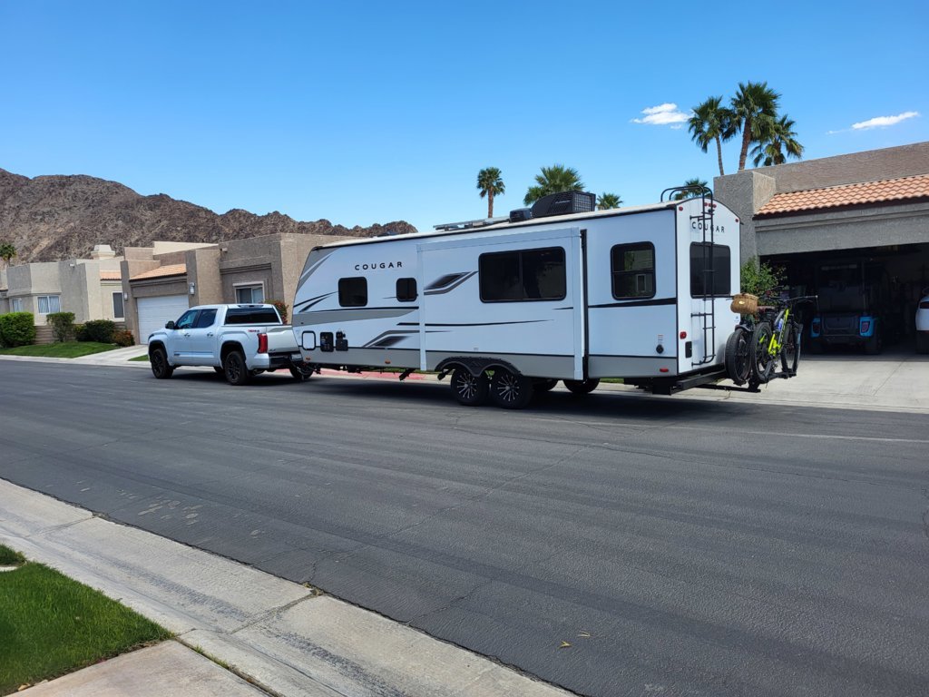

    Leveled it out with 35 psi. First trip with the new air bags.

    That’s a monstrous trailer, how’d the truck handle it?

    Its a cougar 26rds actually about 29' and probably 7K lb as shown. Truck pulls great, power is no problem. We were in about 20 to 30 mph gusty winds yesterday near Palm Springs, i had to hold steady but it did ok
    A 3/4T would have been better. Wife would have been a bit sketched if she had been driving. All said it does great for a 1/2 T. This is what we bought it for and it fits the job.

    was that picture taken in PS/PD? That background looks familiar.

    Picture was in La Quinta.
    The Air bags are Load Lifter 5000 ultimate from e-trailer installed them in about 2-3 hours. 20 psi no trailer, with the trailer loading it down they are at 35 psi.
    Just factory sway control. Not even sure if it is turned on or how to do it. I just configured my tow settings for a hitch towed <30' 2 axel trailer with electric brakes that weighs 7K lb. I have my brake gain set at 3.5. i run in Tow+ and it shifts well and does engine braking automatically. My milage is up from 7.9 last tow with about 1.5K on the truck to 9 with 4.5 K now.
