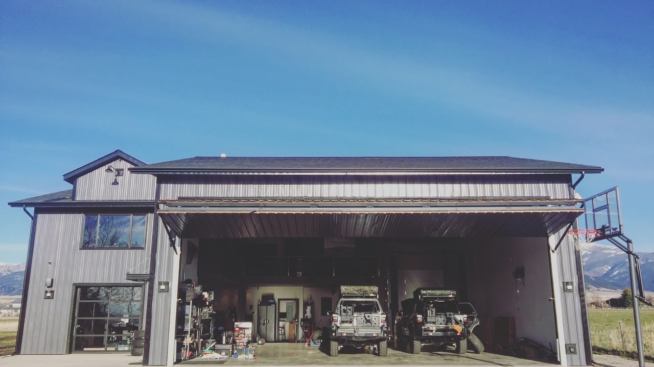

    You need an aircraft hangar door:

    There is no such thing as a garage that is too wide, too tall or too deep. And seriously, a hanger door garage with no aircraft in it? The horror!
