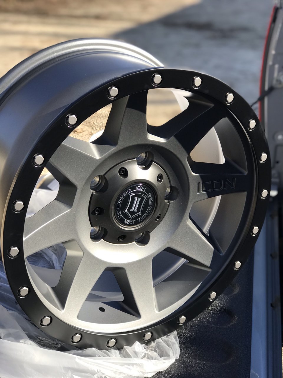

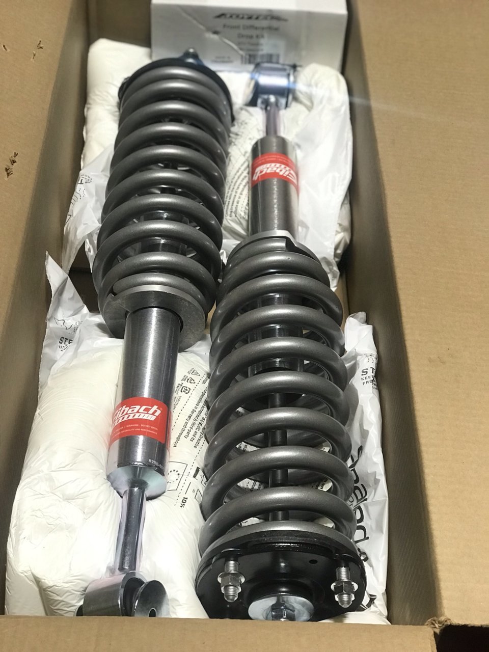

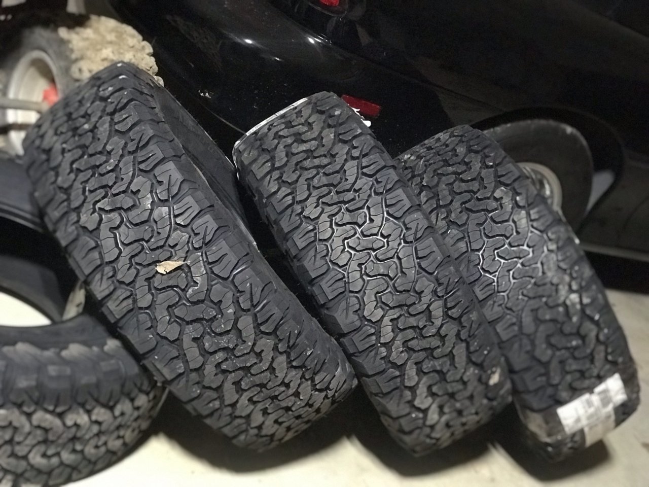

    I’m one oil change in and I have a few parts for the new rig.
    Tunebcs 3” from the Toytec boys
    Some Rebounds from Icon
    And some BFG rubber

    Nice! Love the wheels man! What color truck?

    Congrats - looking forward to seeing some photos. Is the top hat bearing installed on the Eibach coilover the KBY unit?

    Totally dig those wheels

    Nice! Those rebounds looks awesome!

    Very nice! Love those coilovers, I ended up going with the Boss but you will like them:fistbump:

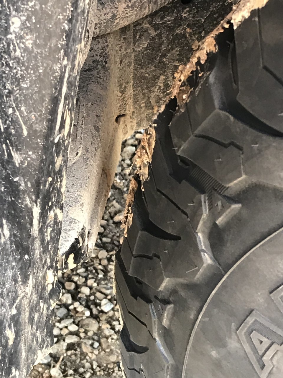

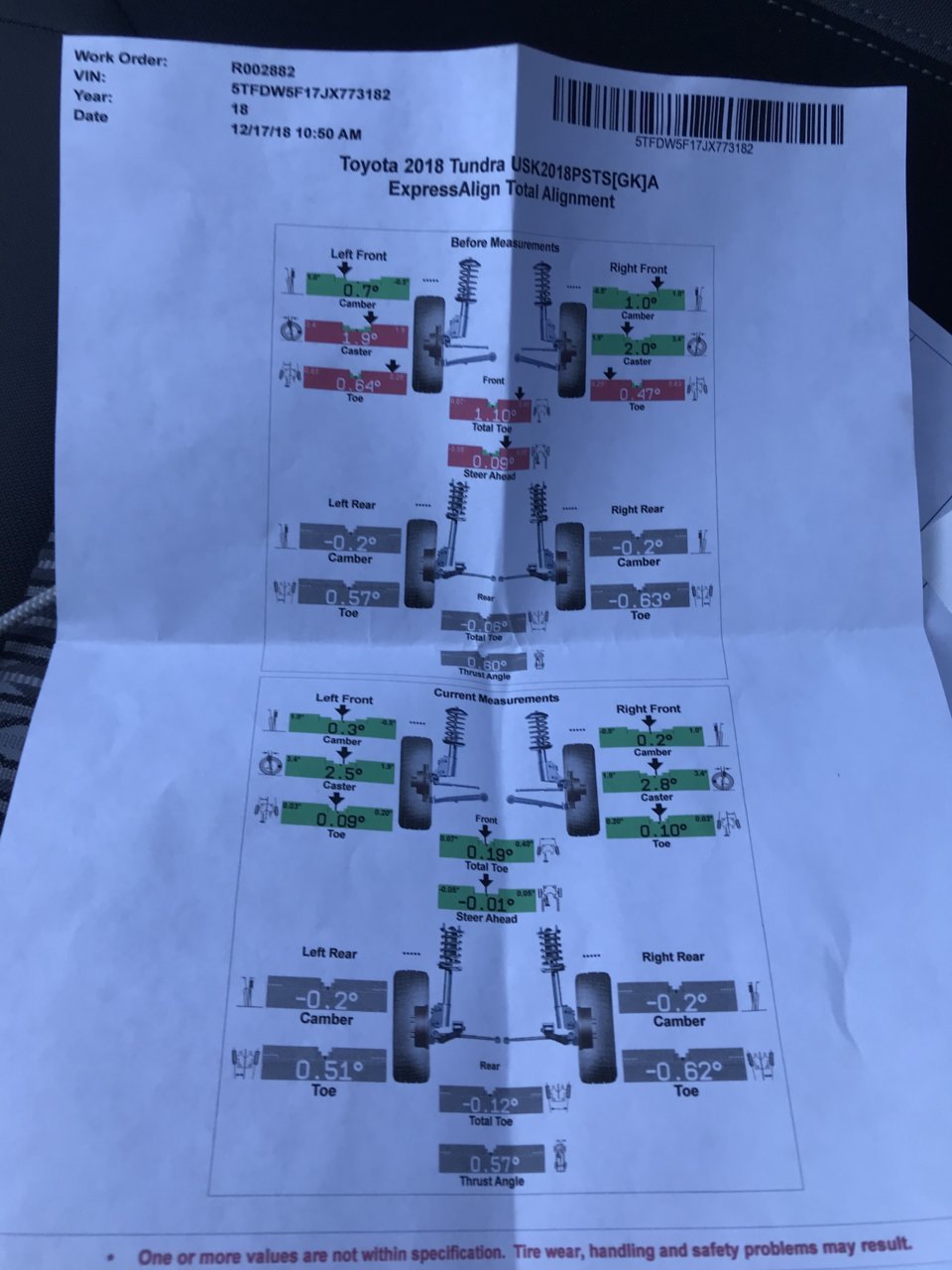

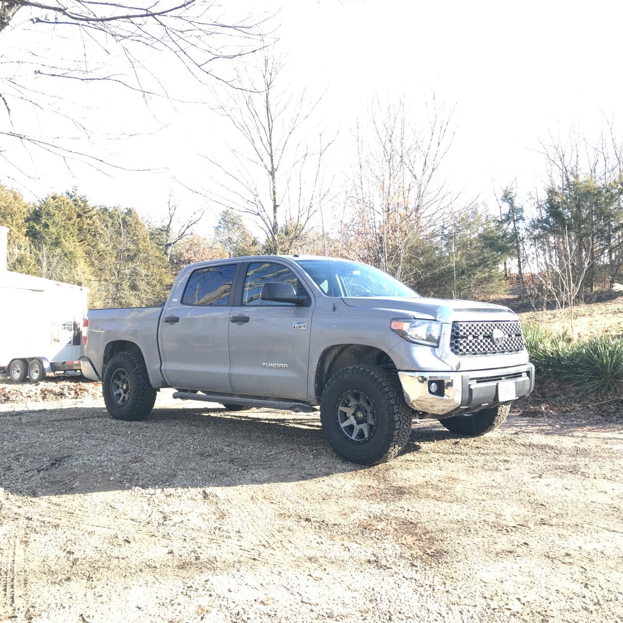

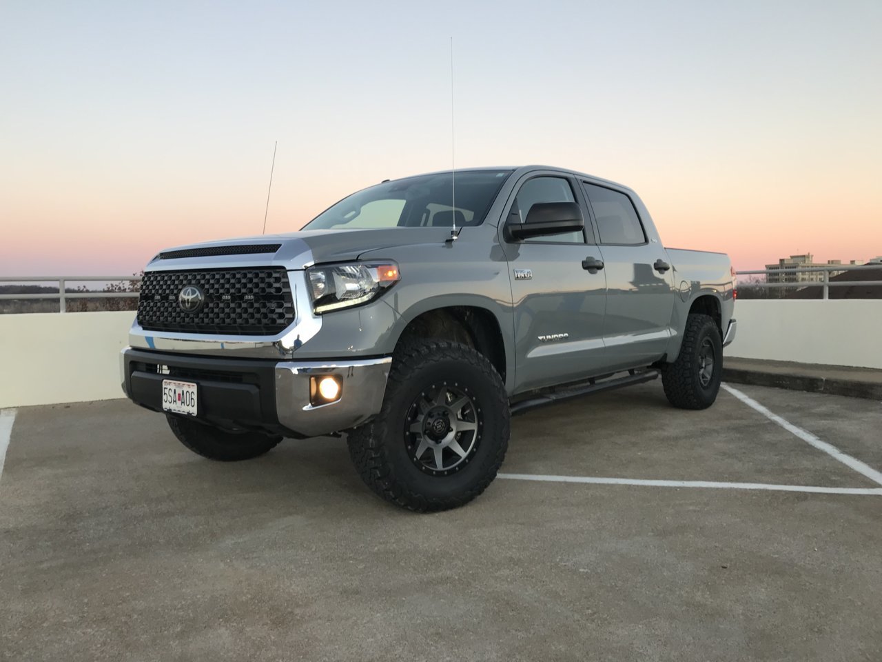

    Here we are with some pics. Coilovers installed like a dream (I did them in 1.5hrs), it aligned fine with stock UCA’s. Still no rear lift yet I wanted to see how much it “needed”. 315/70/17s ZERO rub and no body mount trim. (Mudflap and front splash guard is removed). I couldn’t be happier with the fit and ride. Honestly a near perfect install and go setup!

    Beautiful ride! Do you have any feedback on the ride vs stock? I was thinking about the exact same suspension setup.
  15. Dec 18, 2018 at 5:05 PM
    LSX
    LSX [OP] New Member
    Sep 17, 2018
    #19510
    11
    Well to be honest I think it rides very well. The difficulty in that judgement lies with tire choices. Obviously the stock tires are different than an E rated All Terrain so by nature the tire is stiffer but it’s also a much larger sidewall. The ride is not harsh by any stretch, I would say it’s firm and controlled.
