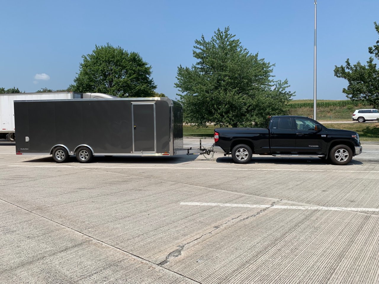

    I towed a 4000# car in a nearly 3500# trailer from Massachusetts to Murfreesboro TN and back with the Tundra. For anyone interested in my set up, I had about 850# tongue weight plus 80#'s of hitch. Just a floor jack and a couple light things in the bed and a suitcase, cooler and small things in the cab.
    I have air bags and had 15# in them and a weight distribution hitch. You can see the truck is sitting level. I probably could have gotten by with just one or the other but I liked the potential sway control of the hitch. The trailer manufacturer, ATC, says you don't need a WD hitch with their trailers and suggests not using them. I felt better having one. Also have 8 ply tires on the rear.
    The Tundra pulled the load well. I had no issues with sway, even when a semi raced by me. I averaged 11 MPG. Much of the time you wouldn't be aware there was a trailer behind the truck.
    I have the tundra tow mirrors and liked them. I know some don't like how narrow the parabolic mirror is but I did like how wide it is. I also have a wireless camera on the rear of the trailer and a 5" screen in the cab and liked being able to see what was behind me.
    I tested this set up with the factory brake controller and even after the brake controller "update" was still unhappy with it so I used the Tekonsha P3 often recommended here and thought it worked great.

    Great example of how these trucks can be very capable tow pigs with preparedness and a well thought out towing setup. :thumbsup:
