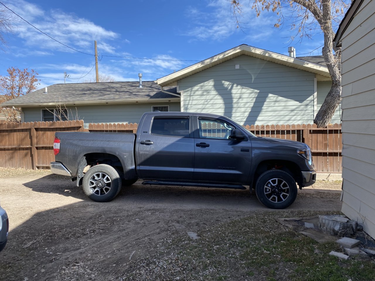

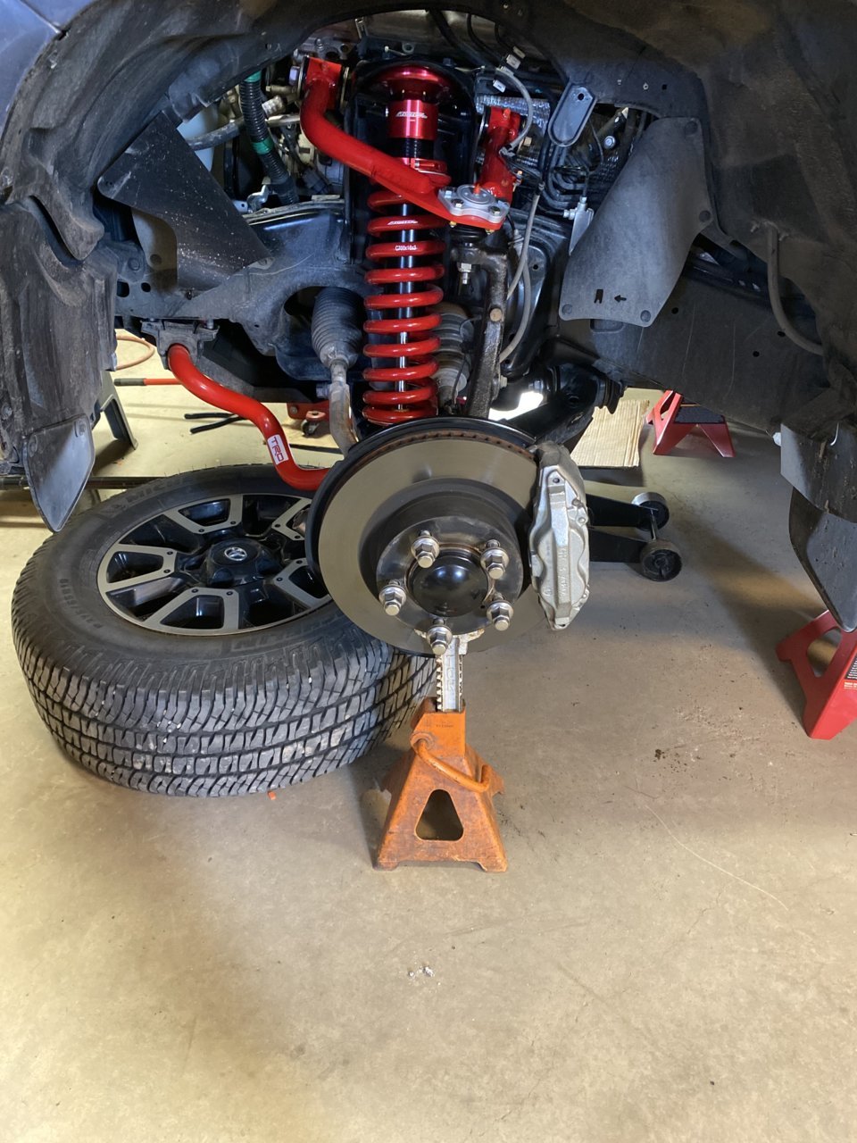

    2021 Gray TRD
    Do it! Did mine a couple weeks ago, and I’m old! I had fun and mostly the satisfaction of knowing I did it right. Read all you can, watch all the videos you can. You’ll need tools, jack stands, floor jacks yada yada…44C77E36-2719-491A-9553-2CFE080085C3.jpg8CD88AC2-FE2C-43D2-A65D-3F3026C34322.jpg
    Just finished and sitting about +4” in the front. I have dialed them down to about 2.5” since this pic. Toytec Alumas and shackles, JBAs, DuroBumps, you get the idea…Doing just the coil overs and rears, Do it!
