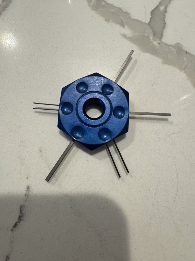

    Here is a picture of the depinning tool I found works well to de-pin our connectors.upload_2025-8-9_19-43-46.jpg

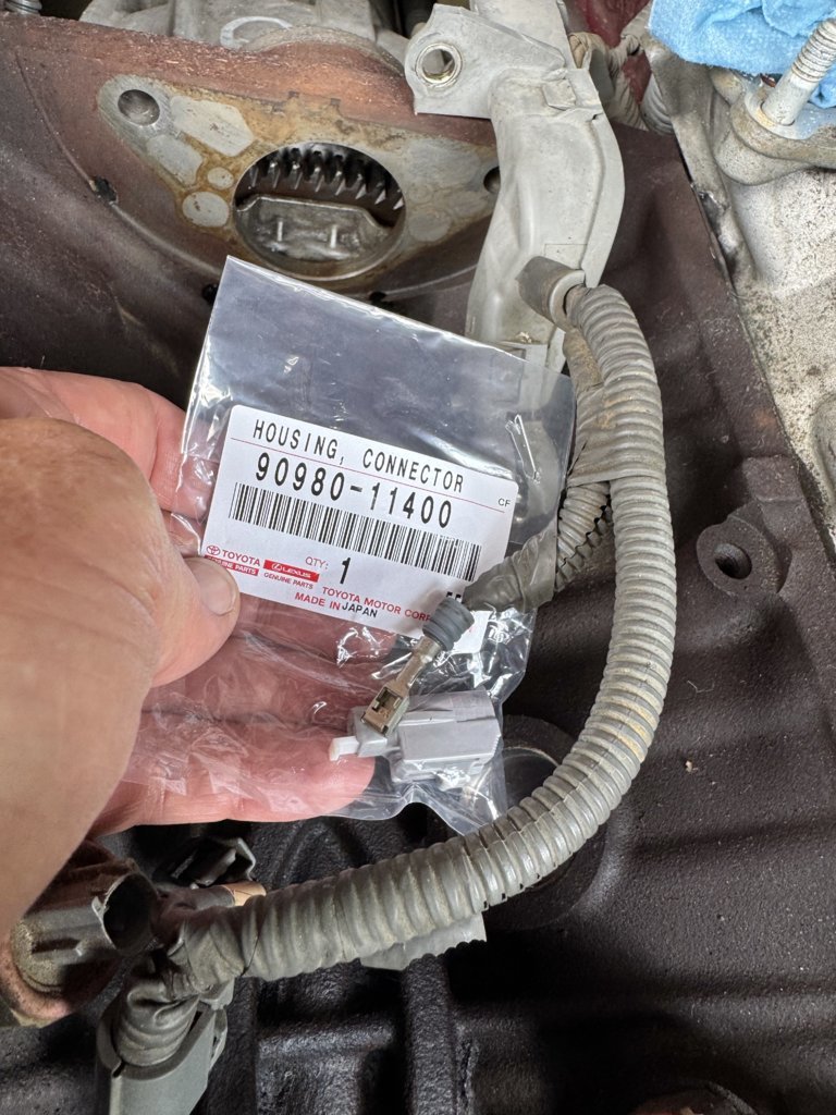

    2000 AC 4.7 Starter Signal Connector. Attaches next to the +12V lug.

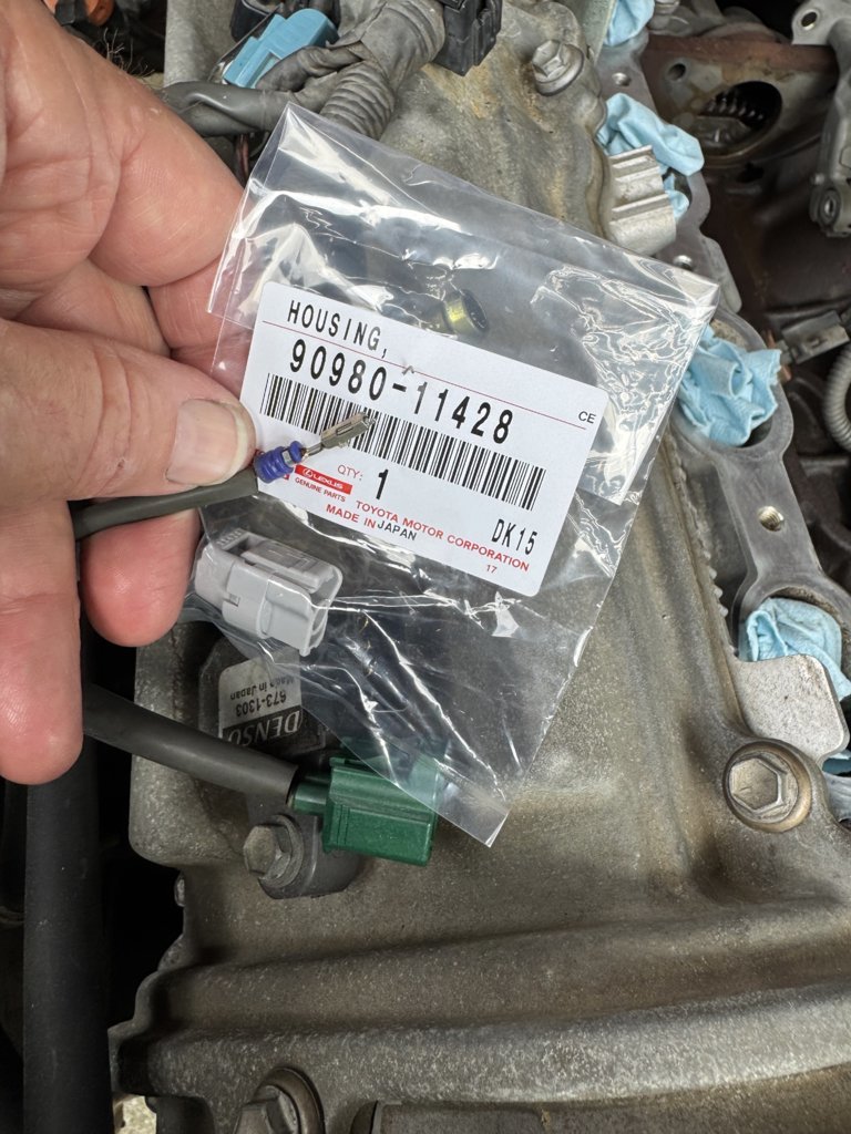

    2000 AC 4.7 knock sensor connector in the valley. There are two of these here. Note Toyota OEM replacements for some connectors are different colors. Original was gray and new one is white.

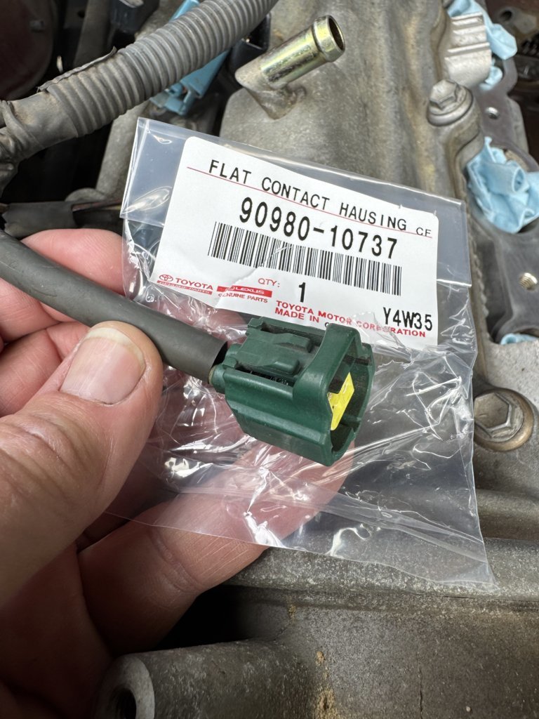

    2000 AC 4.7 green temp sensor on front water crossover

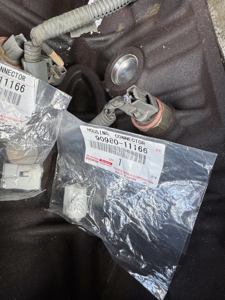

    2000 AC 4.7 gray temp sensor attached to front water crossover.

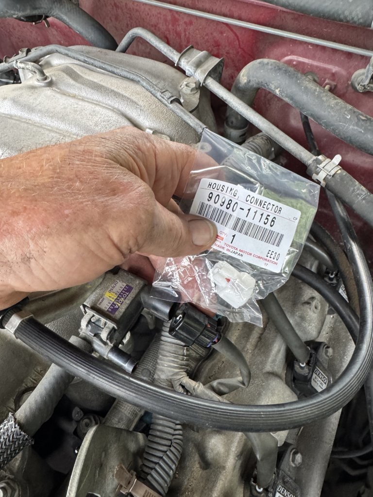

    2000 AC 4.7 Evap Solenoid on driver side of intake manifold
