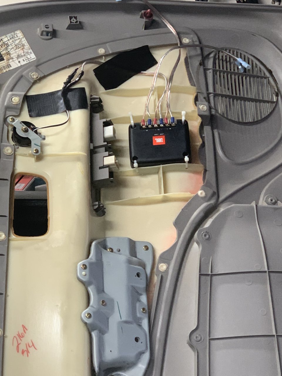

    For instance, the 06 FSM shows the location of your JBL Amp as mounted where @weadjust shows above. This is somewhat important to know because if your wish is to also update to a more modern headunit, you'll be running a new cable to the rear Amp that then plugs into your existing speaker harness.

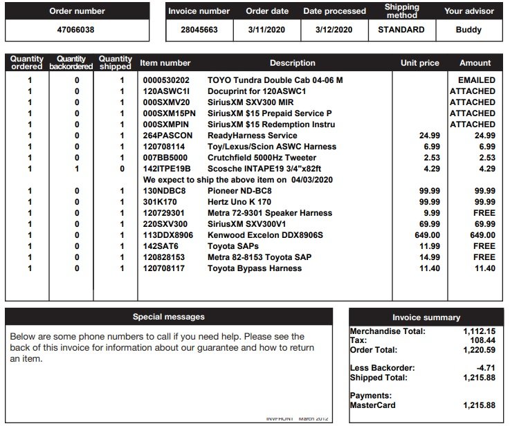

    I'll add a few things to give you an idea of what I did on my 04 DC limited when I did my install by purchasing everything from Crutchfield. Working with them was best decision I made. They provided 99% of what I needed, they were prompt in answering emails and were very support base. Usually able to talk to one support individual throught the whole process. The install was not that involved even tho I had the background.
    YMMV
    Items below in a nut shell allowed me to have new Head Unit and Speakers, bypass my Amp on back wall, retained Steering Wheel Audio Controls, new to me BckUp Camera

    There is no question. If they have the JBL system and the head unit is original, there's an amp. If double cab, it's (I believe) on the wall behind the driver's side rear passenger seat. If access cab, it's under a plastic cover in the cubby under the passenger side rear seat. Honestly don't know where it is in newer regular cab trucks.
    @arbizu44 seriously. Go to Crutchfield. Not only will they give you the perfect-fit stuff but they'll give you ALL the adapters you need for a plug-and-play experience, AND they'll give you free unlimited phone support for installation. You're going to need at least the amp bypass adapter.
    Thing is, Crutchfield doesn't charge outrageously more to get you this. Can you get it cheaper elsewhere? Yes. But time and hassle you spend equal money lost.

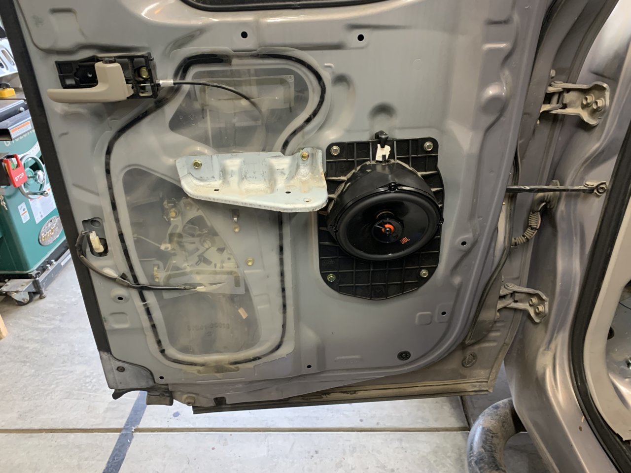

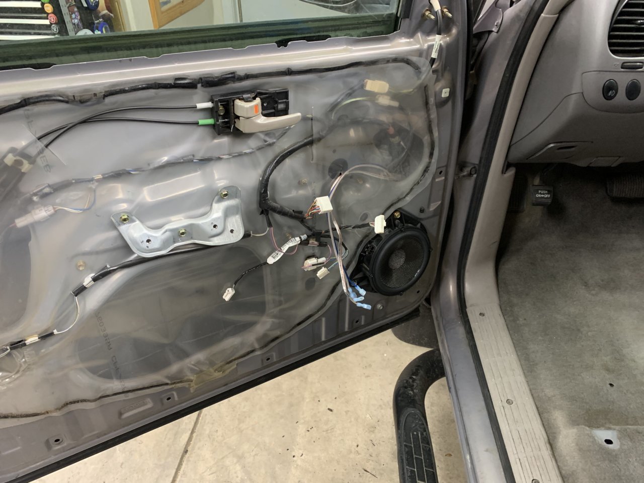

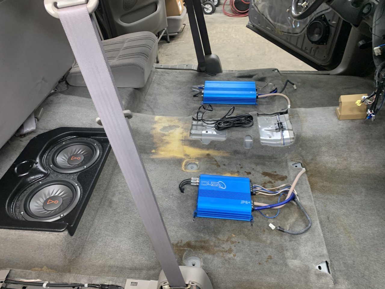

    Just put a Sony unit in my sons ‘00 Access cab. Not JBL. It wireless Apple car play and it is awesome. I want one now for my ‘06 Tacoma. his amp was behind the heater controls.
    Sorry no pics of everything buttoned up. They are on my sons phone. 9A591F10-CDF5-424E-8DEE-314E21DD686B.jpg43A4CCAA-8BFF-481B-8B6A-22BBE1210203.jpg 4C4EDDB5-6847-408E-A27D-234E8C600EDA.jpg4EFE7EB5-0C81-48E8-B3AD-11D1374A8C3B.jpg
    I have used Crutchfield many time and can’t recommend them enough.
    We did it all. New head unit, two amps, Qlogic box with 2 8” sub, 6 1/2 components I. The front, 6 1/2 coaxial in the rear doors and two amps.
