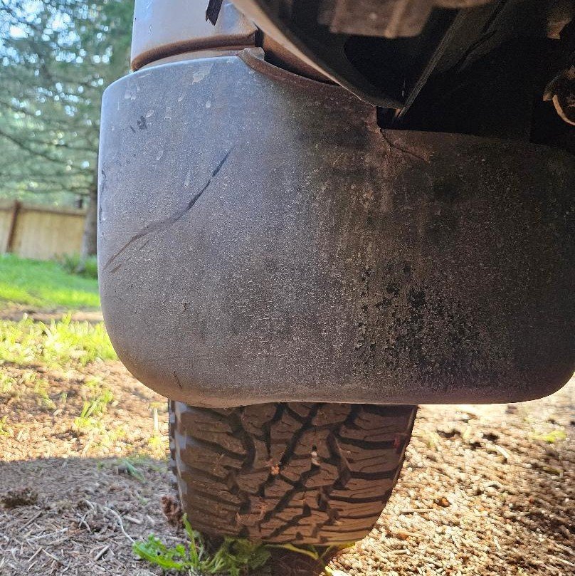

    I have a 2000 Toyota Tundra. Needing Mud Flaps, I bought some off eBay. The ad listed them as 2000 - 2006 Toyota Tundra. The new ones look nothing like the shape and hole pattern of mine. The listing said the eBay mud flaps were OEM. The seller said that I can return and be refunded. Are my current mud flaps aftermarket? I have been searching all over the web for mud flaps that resemble mine. Any Suggestions?

    I am not 100% sure whether they are OEM or not. I am however 100% sure never to trust "OEM" when shopping on eBay. Sometimes deals are too good to be true, and it's usually when they're from that site lol

    Your mudflaps go with the TRD package. The clean ones in the second picture are for the non TRD trucks with mud flaps. There's also a different set (that's far less common) that came on trucks with flares but without the TRD package.
    You can still purchase these new I believe. @shifty` replaced his.

    @lobosobrio those look like mine, the ones on your truck. These were my part numbers. Verify with pictures before ordering. I don't have time right this minute to find pics of mine here, but ... they'll be somewhere in the lunch table thread.
    Mud flaps
    Front R: 766210C020
    Front L: 766220C020
    Rear R: 766250C020
    Rear L: 766260C020
