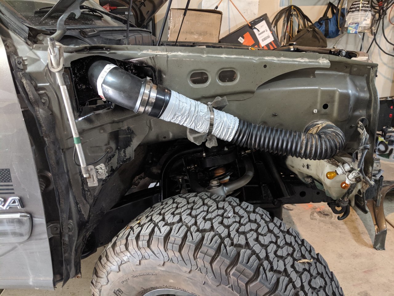

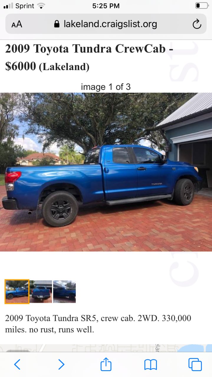

    Saw this today
    SprinterAE86 likes this.

    Some junk
    I think lower gears would really help me around town and on hills. There's times when I need a bit lower gear than drive. Then again if it's windy at all or I'm climbing a hill, chances are I'm in 4th which is my 1.0 ratio drive gear.
