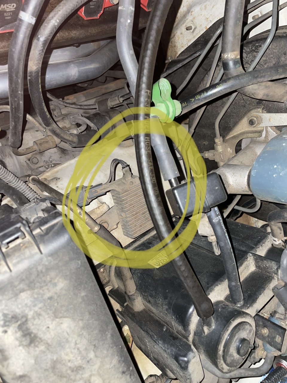

    In the 2002, I believe the fuel relay is the finned device mounted to the top of the driver's fender, below/between the brake master cylinder and fuse/relay box.
    I'd confirm, but I think it has 2 wires going to it. Shoot me a pic.

  16. Jun 26, 2023 at 7:00 PM
    Brynden29
    Brynden29 Just a guy who works on cars
    May 16, 2020
    #46632
    355
    Brynden
    Bellville, TX
    1999 Mustang GT
    I’ll get one tomorrow. Thanks for the help.

  17. Jun 27, 2023 at 3:54 AM
    Brynden29
    May 16, 2020
    #46632
    355
    Brynden
    Bellville, TX
    1999 Mustang GT
  18. Jun 27, 2023 at 3:54 AM
    Brynden29
    May 16, 2020
    #46632
    355
    Brynden
    Bellville, TX
    1999 Mustang GT
    I assume that is it?

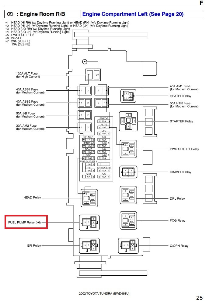

    Negative, that's the fuel pump resistor.
    Fuel pump relays are located in Engine bay fuse box as shown in below pic from 2002 EWD.

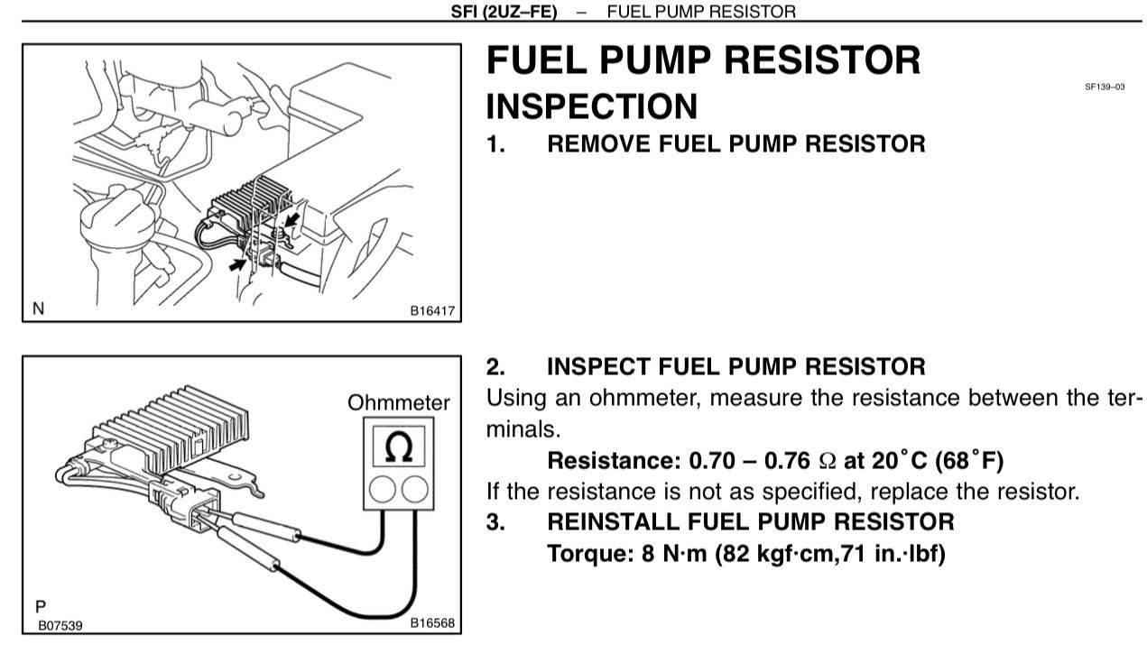

    1999 Mustang GT
    Can anyone tell me how to bypass the resistor?
  27. Jul 1, 2023 at 5:46 AM
    #27
    Mr.bee
    Mr.bee King Turdra
    Jun 4, 2022
    #79178
    6,424
    SATX
    '02 AC TRD
    BubbaW and Brynden29 like this.
  28. Jul 1, 2023 at 5:51 AM
    #28
    Brynden29
    May 16, 2020
    #46632
    355
    Brynden
    Bellville, TX
    1999 Mustang GT
    I found that image to test it, I guess it’s pretty simple just to jumper across the terminals with alligator clips to test it out.
