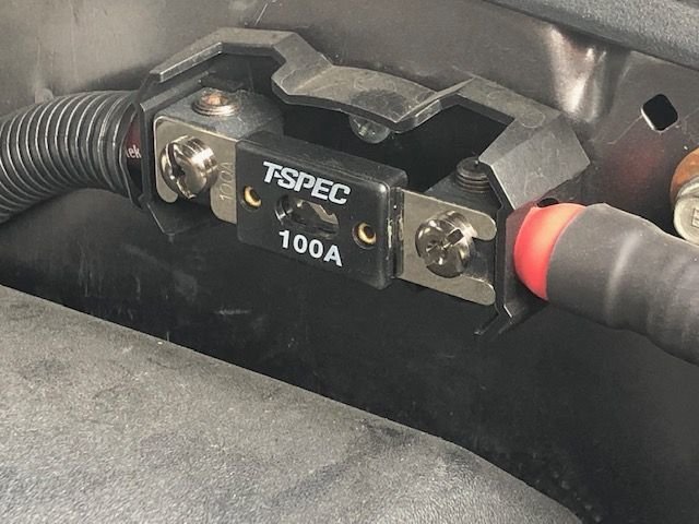

    Slit the grommet, tape (electrical tape) an HVAC 3 foot zip tie to your wire, spray it with silicone spray, and pull it through from the engine compartment to the cab.
    Or even a smaller long zipties for smaller wires..
    I've pulled many a wire thru that grommet.
    Including a 0ga amp power wire..

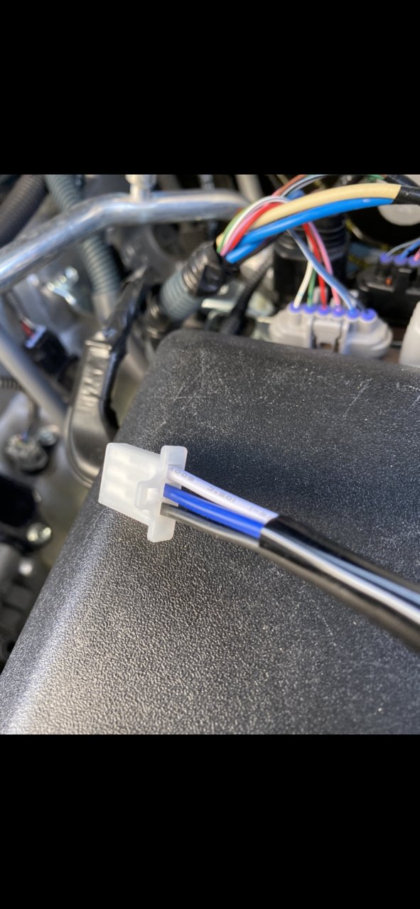

    In addition to all the great suggestions, I went ahead and de-pinned the little harness. This allows for a way easier time to bundle and pull through.

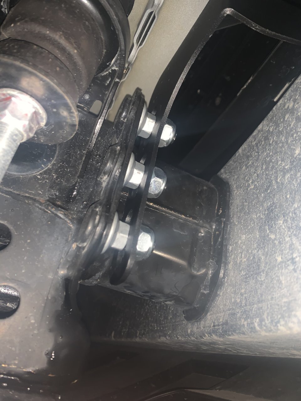

    I just received this light bar, and the only concern i have is, how far will the bar mounting brackets stick out since my bumper is shimmed?? Im thinking I’ll have to remove my spacers because I barely have any meat left on the studs…. But i could be wrong…

    If the bumper is shimmed, it would depend on the size of the shims; just from looking at the studs, I think if you had 1/2" bumper shims (I think the Toytec shims in my garage are 1/2"?) you wouldn't be able to use the lightbar brackets at all, or maybe 1-2 threads?
    I'll be pulling my lightbar (and bumper) off tomorrow or Tuesday as I install my ARB Bumper and will try to remember to measure the length of remaining threads on the studs

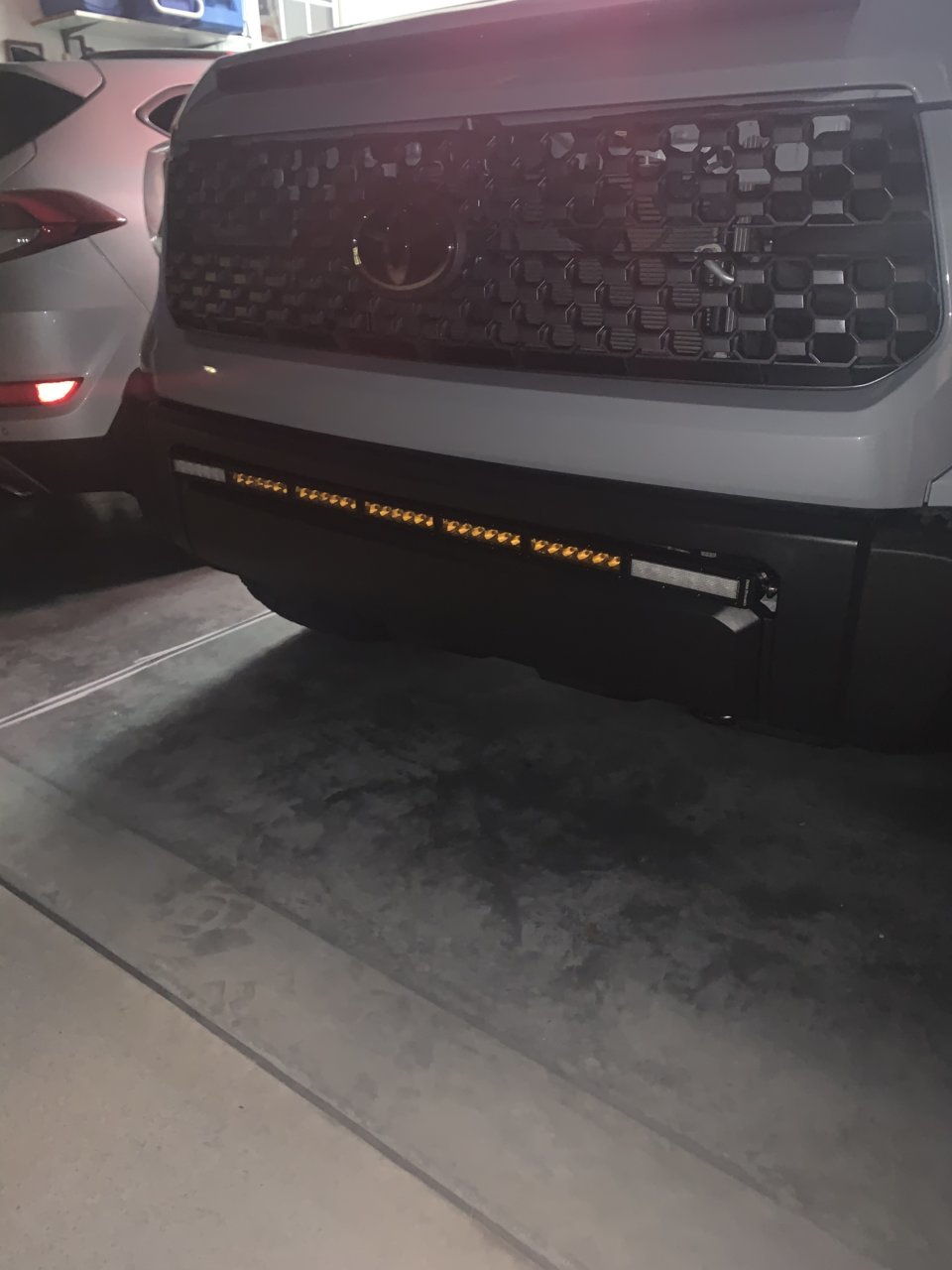

    Side note, how did you order the bar with yellow and white, unless I'm blind and don't see something on the website
  29. Jul 18, 2021 at 7:38 PM
    #29
    Mallcrl
    Mallcrl New Member
    Dec 27, 2020
    #56690
    269
    Anand
    Maryland
    '21 DC SR5 SX
    You can order replacement lenses in either clear or amber, and change the beam pattern or color of each module

    I have eight 3/8 washers per stud. That measures out to 1/2 inch.
