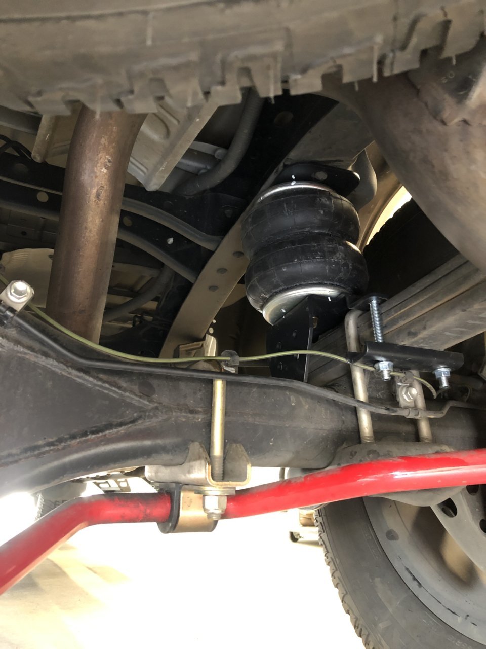

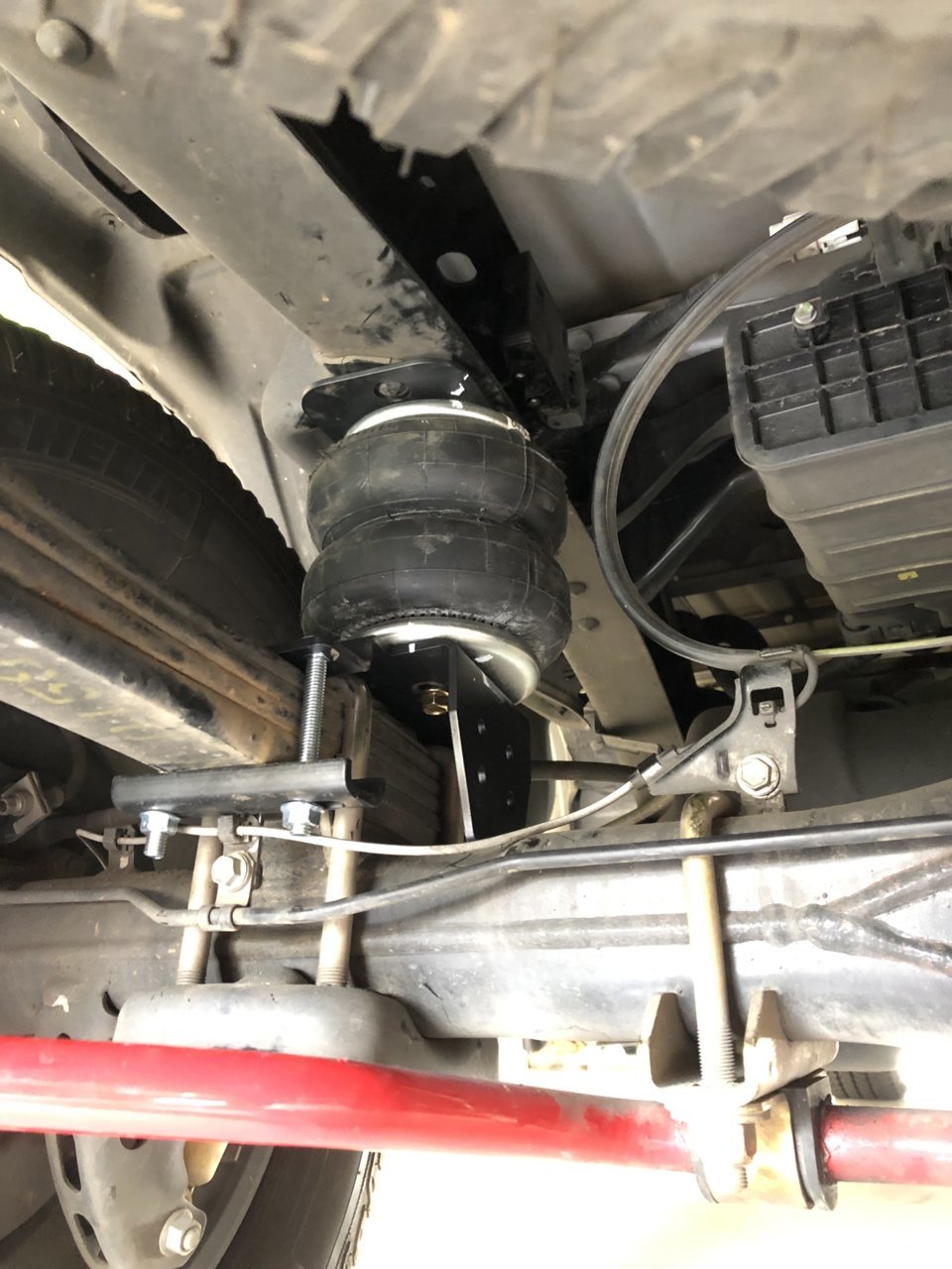

    I received the correct airbags and installed them. The install is pretty straight forward and I was able to get them in without putting the truck on a lift or removing the tires. eTrailer makes a good tutorial. The hardest part was cutting off the bump stops. I had to use a hacksaw, so it took a little longer.
    3E98B974-9CCF-470F-9DC3-0504F013F895.jpg EC259734-5A08-4249-A0F9-7DC231BE6B66.jpg
