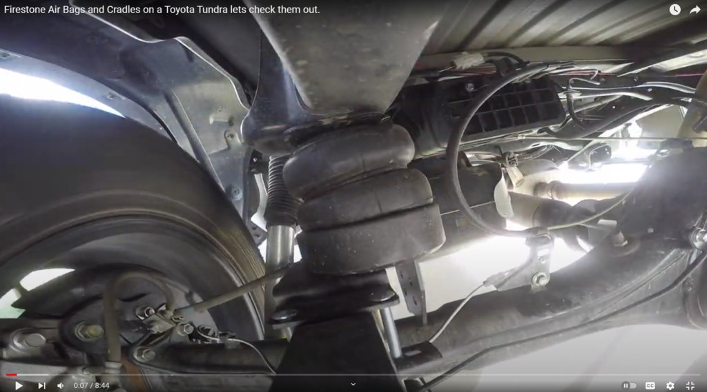

    How come when ever I see pics or videos of firestone ride right air bags on a tundra, it looks like the air bag isnt centered (lower leafspring to upper frame) it looks like its working at an angle , especially when watching video of them in action.
    if you look at their lower bracket , the mounting hole on the top of that plate is not centered on the leafspring , it is located at least 1" toward the center of the truck causing the angle on the installed bag.

    I found this video that I think demonstrates what you are talking about.
    https://www.youtube.com/watch?app=desktop&v=WDtRxstFjDQ

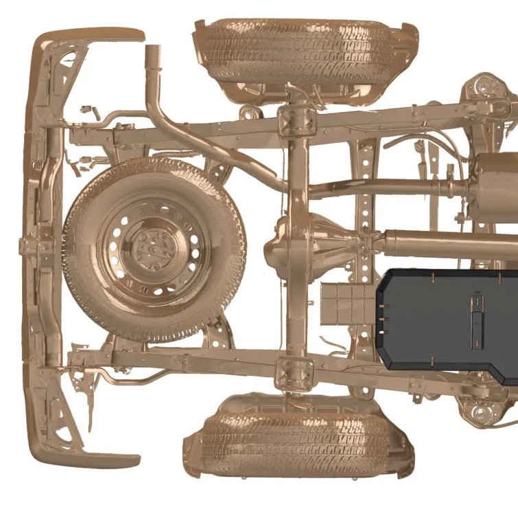

    As for why it is off center from the leaf spring, that is just the way the tundra frame is shaped. The frames narrows in the rear and the leaf springs also are not parallel so the geometry all changes as the truck squats which also probably adds the angled look

    Yes that video and pics are the same ones I was refering to.
    Im no rocket scientist, but anything working at an angle will not work as well and will stress parts if it not squared up.
    Without cradles its probably nothing to worry about , but I could still see stressing the bag if working at an angle.
    But with cradles, in the events when your bag travels out of the cradle , the bottom of the bag is returning back in to the cradle at an angle, and just seems wrong. In a rare situation I can see that bag missing the cradle or folding.

    Nope, the factory bump stop does not align with the frame rail either. There is a bracket that hangs off the side of the frame where the bump stop contacts.

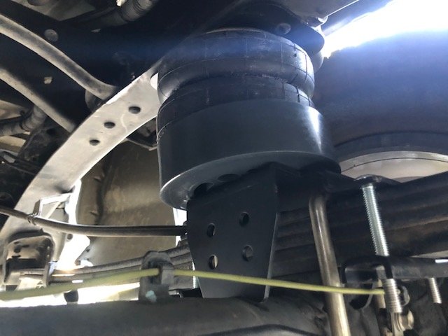

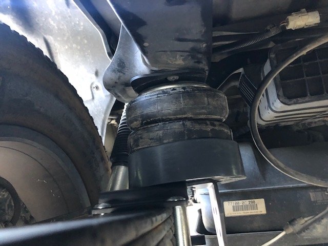

    UPDATE: just finished install, thought id follow up.
    I did totally remove the bump stops instead of cutting them .
    I did not drill a new hole in the lower support bracket.
    I installed the kit and I dont have any complaints regarding left to right angle of the bag assy.
    My lower bracket plate did have a slightly slotted hole that allowed a small adjustment forward / backward which came in handy as I did some fine tuning.
    I was able to move my cradle slightly forward for better alignment with the bottom of the bag, all while everything was still installed.
    I kept the tires on the ground, but put a jack and some blocks under my tow hitch and get the suspension pretty high (with tires on the ground) lifting the bags out of the cradles, then with a wrench in one hand and ratchet in the other, I was able loosen the nut that holds the cradle to the lower plate bracket, then slide the cradle forward a little for better alignment.
    Firestone Ride Rite must have re designed there lower plate at some point , because in some of the videos Ive watched some people had the lower plate (plate #5928) with a single round hole and NO verticle support that goes down to the top of the axle tube, and others had a slightly slotted hole like mine (plate #5543) and it DID have the verticle support that rests on top of the axle tube. I dont know which is newer or older , But I bought my kit in June of 2020 and it does have slotted hole and verticle bracket as shown in my second pic.
    I zip tied the cheap plastic bracket to the tow hit frame as suggested, but didnt like its position or how weak the attachment was , I ended up drilling 2 5/16" holes through my rear bumper just under my towing electrical plugs, so they are now easy to get to and mounted very solid.
    Also, the new Daystar cradles KU09140KV are now made with Kevlar, They are grey and have almost a rubber feel to them, you can dig your fingernail into them, they are not a hard poly
