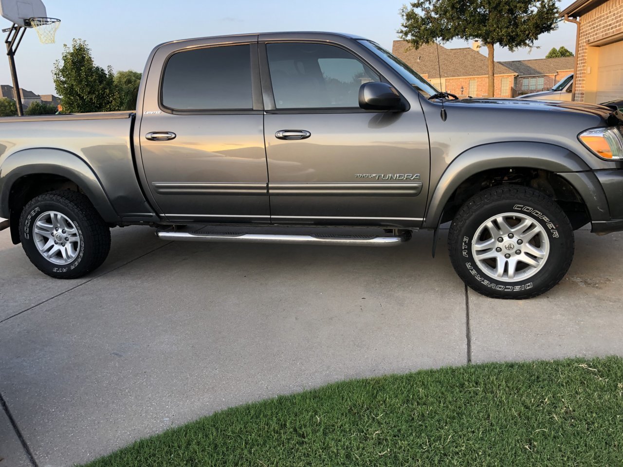

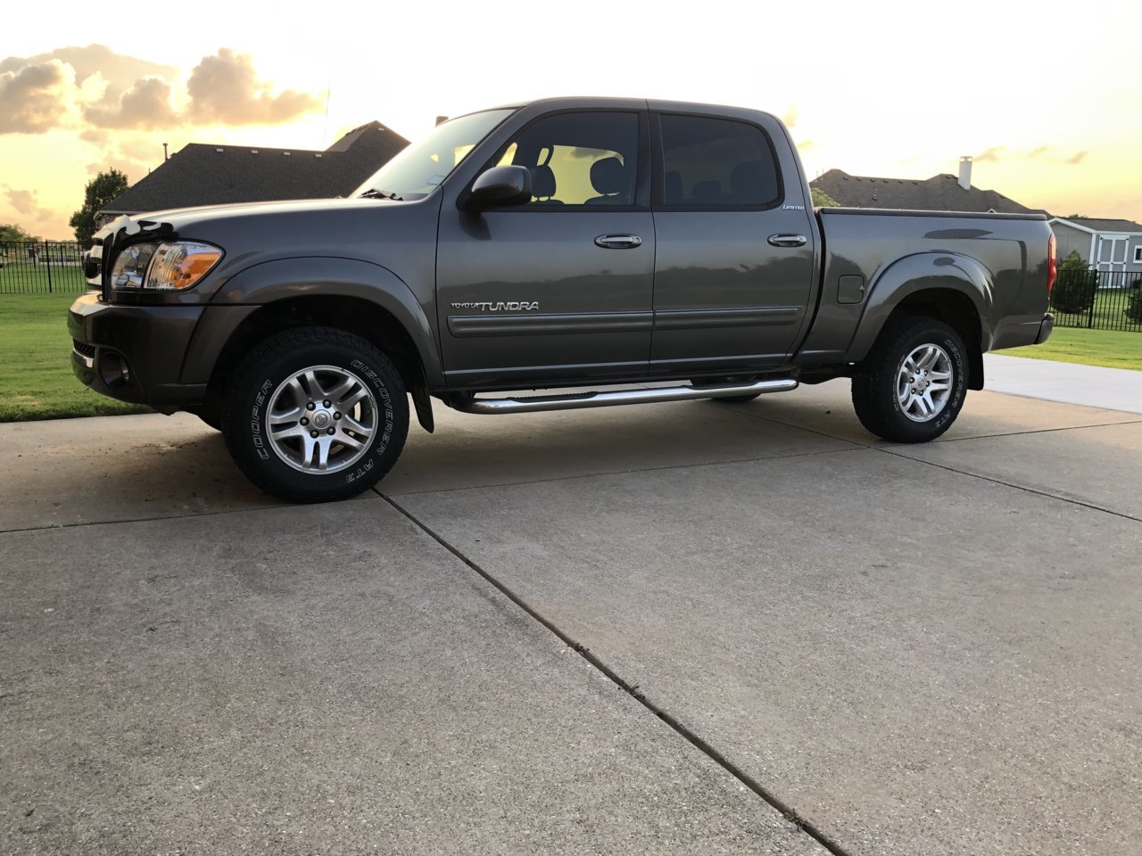

    Working on it part time in the Texas heat I finally got the 5100s installed on all 4 corners. Fronts were of course the hardest. While the original KYBs with 156k miles came out pretty easy the Bilstiens wanted no part of this install on the front. Finally had to drop the lower ball joint to get the clearance needed for installation.
    These are the standard 5100s on the front and rear and went back with the OEM spring. Had a shop down the road do the swap over. The ring on the front is in the middle position. Ground to bottom of fender measures 35" in the front and 37" in the rear. Placing a level on the truck bed shows it to be pretty level.
    Going for the alignment in the AM. Have not had it out on the road yet.
    Pics are post install.

    looks good. measurements are usually from the center of the hub to the fender if you ever wanna compare to others fyi.

    Truck looks great. Post up your impressions of ride and handling with them on the 3rd notch after you've logged a few miles.

    Looks nice... i liked how mine looked more when I had it on that setting. That being said I put mine on the third position to start. My shop couldn’t align them correctly on 3rd slot. Next alignment I did 2nd slot and they were able to get it barely into spec. And now after the third alignment I’m going to the bottom setting so I can get a better alignment and not go through tires so fast. My ride height might be different though. I have an ac cab and lift springs.

    Thanks guys. I did use my sawzall and cut through one of the bolts on the rears as it would not come off. Using the vise grips shared off that part of the bolt and left me with nothing to grab. Let me get those new measurements from the center hub to the fender. Overall, very pleased with the new appearance and removing the rake. Jury is still out on the ride improvement as I've not had time to get it out yet.
    Checked the measurements from center hub to fender: Front: 21" and rear 22.5". Both driver side and passenger side measured the same.
