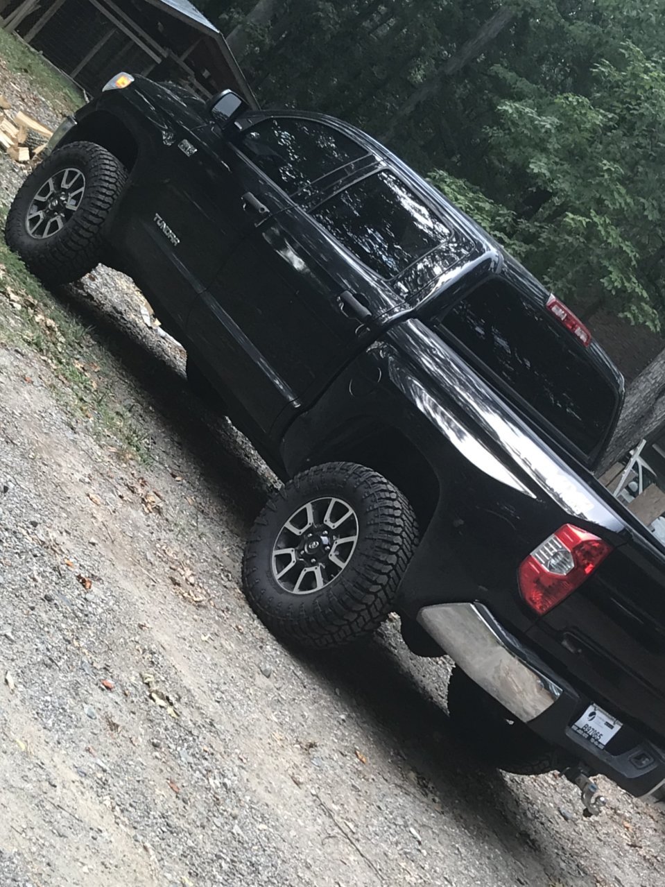

    8C23DA21-F579-49E4-A14B-844FEA7E93D6.jpg Finally got my 2014 done, 35x12.50x18 in the stock sr5 wheels, 1.5” wheel spacers, moved bumper forward 1/2” and aligned 3 times to minimize rub, still need to do the cab mount chop and it’s complete, I really like how it all turned out, if anyone has any questions about how I did I can fill you in on the details

    Looks good. What brand tires?

    Nice....but 12.5" tires on 8" rims ??? :notsure:

    Radar renegade r/t I got the whole set for $759 mother in law gets a discount where she works, I was also nervous about the rim width but have yet to run into any problems, just adjusting air pressure to get a good contact pattern, tires did take a bit of weight to balance but truck is smooth as glass and not much noise from them at all

    I don’t think you’ll have an issue with 12.5 on 8s. Nice rig. But, can you really say “done”? Lol

    12:50 on 8 inch wheels is fine. That is actually the rim width 4wheeler mag used to recommend if you went off road much- keeps the bead tight and helps protect the rim from damage, also allows for lower air pressure off road. 8 to 8.5 inch wheels with 1250s used to be the "thing".
