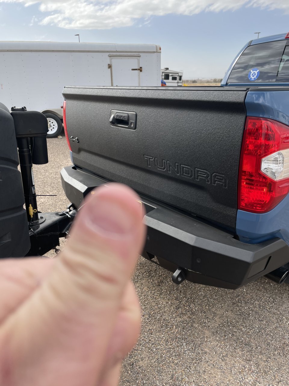

    Finally finished what I started on my 2021. 30k miles as of yesterday.
    Camp trailer weighs approximately 6800lbs wet and loaded with a 6-7 hundred pound tongue weight.
    10ply Michelin’s including spare I keep locked down in bed.
    Tow mirrors
    Transmission cooler
    Bilstein front and back

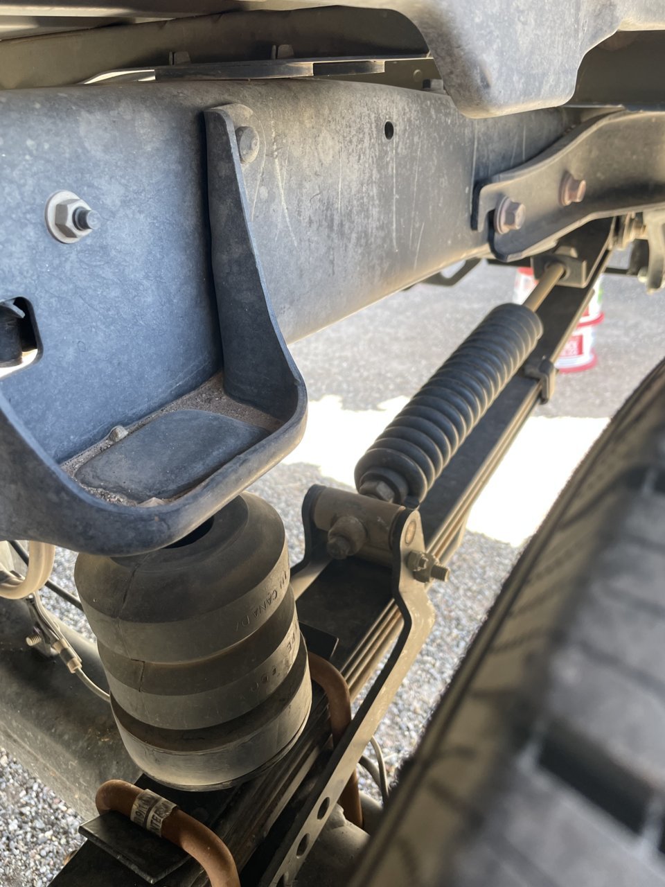

    RAS springs rear set at 40%
    Timbren bumstops front and rear
    Steelcraft bumpers front and rear
    Line-X sprayed front grill and tailgate
    All AMSOIL w/exception of brake fluid, engine coolant and transfer case.
    Runs great, rides awesome, tows better than my old 2018 Chevy 3/4T!

    Pain in the neck getting the rear suspension just right but worth it.

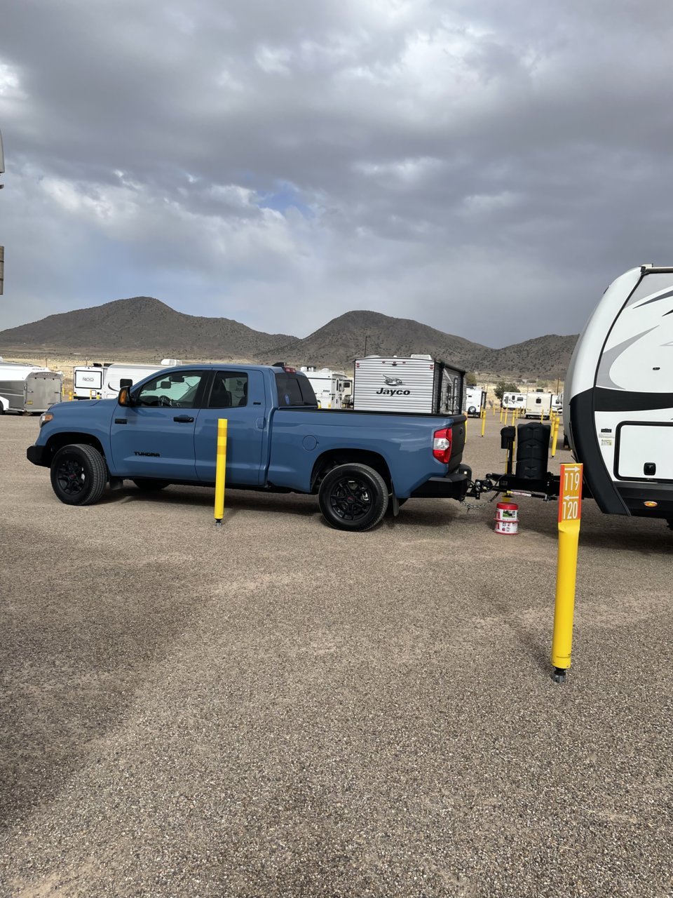

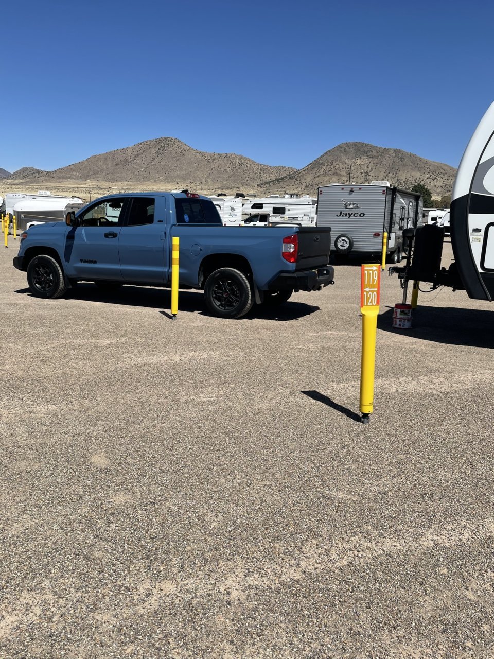

    C8F0E307-ECC4-4A24-9B17-524C31BD20E2.jpg D9493B94-C77B-4BAE-AD5B-55ED00E9E7C7.jpg Here’s the truck with a load, without a load and the rear suspension.
    I did try air bags but could not get a decent ride even deflated down to 5psi. 8E073457-2E0C-4048-9BA8-9A11F7D4AEA6.jpg
