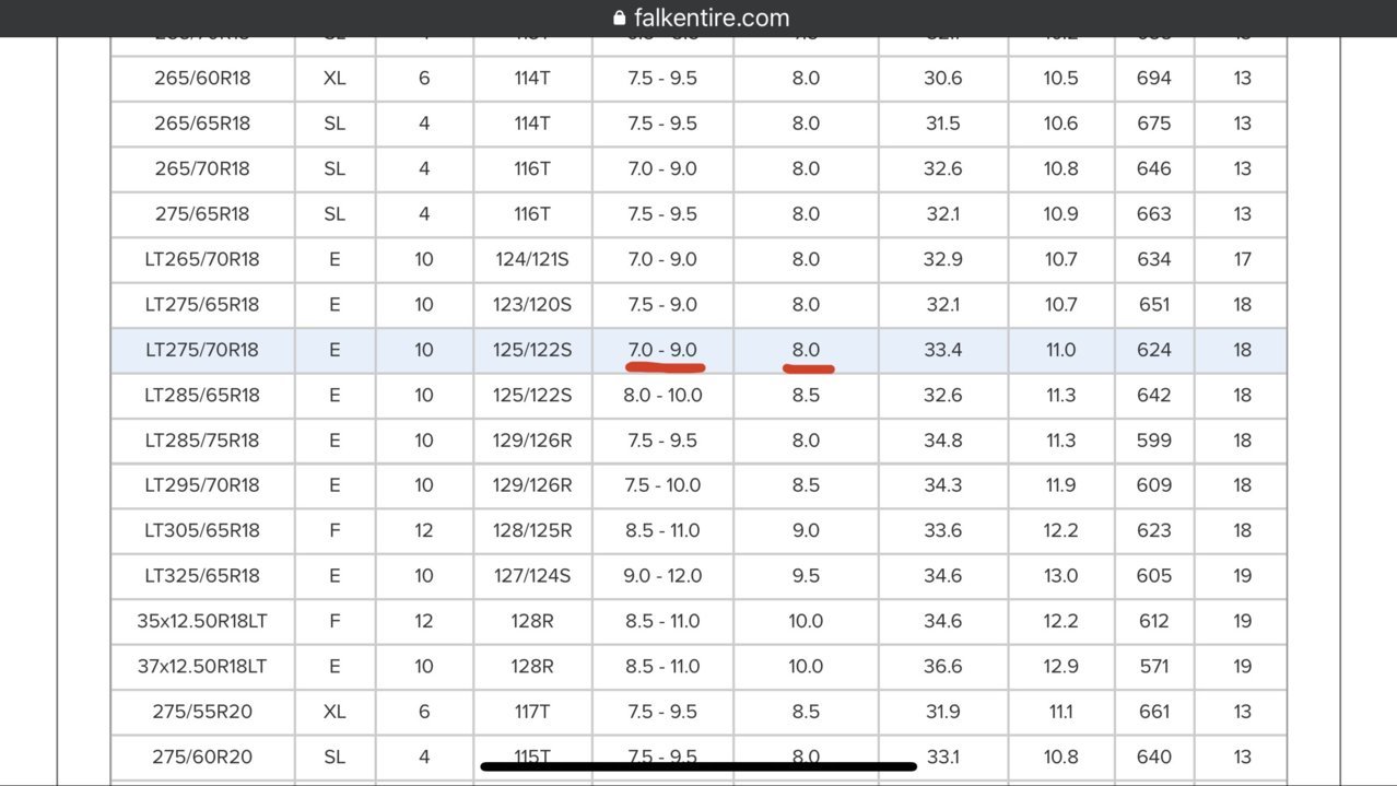

    Look up manufacturer specs for the exact tire you want to see the recommended wheel width as well as acceptable wheel width range per the manufacturer.
    Example for Falken Wildpeak AT3W tires:
