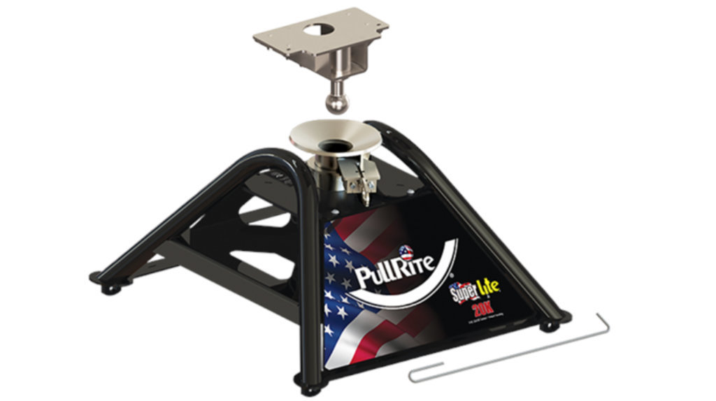

    Well I went with the Pullrite 2400 hitch. Basically it’s an Anderson hitch upside down and made of steel. I liked that the locking mechanism is located on the hitch and not on the king pin adaptor. Amazon.ca have these on sale at an amazing price. It was half the cost of the Anderson and Curt.
