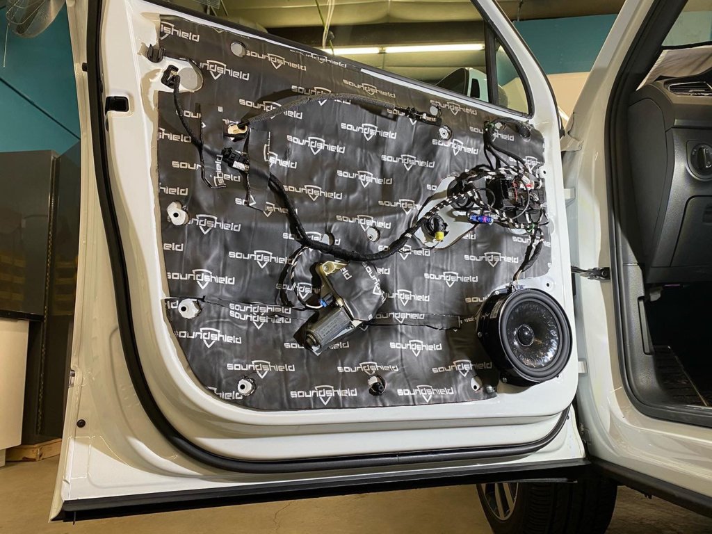

    Yeah, just know, you DO NOT need to do this. You'll get more benefit from slapping a fat sheet on the inside of the outer door skin will provide good reduction.
    What you see here is overkill.

    That pic, isnt that mis-placed?
    Isnt the idea to place on inner surface of [metal surface] door?
    Also, @Shifty , youre saying cover parts of the inside surface of plastic door panel?

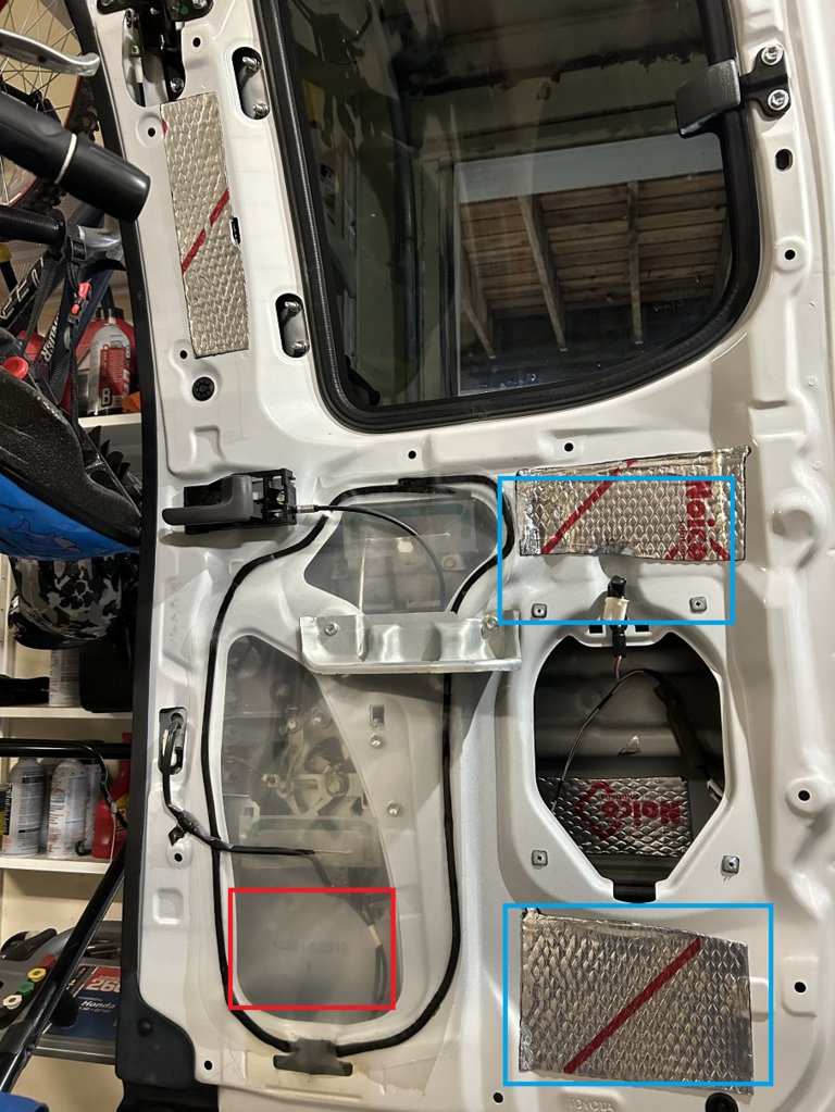

    Take another example from my rear door, ignore the measurements, this is satisfactory and does the job. Where your door has substantial structure (bends etc.), it won't be as prone to vibration. Stick to the larger open spaces to stick your sheets.
    I could've used some behind the plastic sheet in the door here, but notice I've got it on the open panels here, and also put it on the outer door skin above/below the supports, big slabs. The outer door skin has much less structure. You want to stop that from vibrating sound into the truck.
    Max 40-50% coverage is fine. 60%+ is overkill.

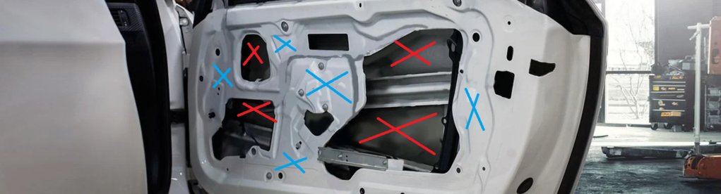

    Note on my rear door above, the interior door skin has tons of bends in it, the only place I bother with sheets on that part of the door is any place that has more than, say, a 2x2 flat area with no backing. I'll run around tapping everything and if the panel sounds hollow and tinny, it gets a slab of deadener.
    Say this was our door. The red X's are going to be my primary target. The blue X's are going to be my secondary targets behind the door panel, the flatter they are, the higher of a target they are. But you really want slabs on the inside of the outer door skin where the red X's are.

    And I would just add, I *do* have slabs of material on the outer door skin where you see these blue boxes on my rear door. That's a horizontal steel brace welded into the outer door skin, just inside that speaker opening, so no point in applying anything to that, it's rigid and heavy as hell.
    Had I not been lazy, I'd have done myself a favor to put a slab where the red box is showing here, but I think it was wintertime when I took this pic, and the tar sealant was hard as a rock, it's a pain in the ass to peel back when it's like this.
    You should be able to notice an audible difference tapping the panel with a fingernail before/after. It should go from a high-pitch tip tip tip tip sound to a tup tup tup tup.
