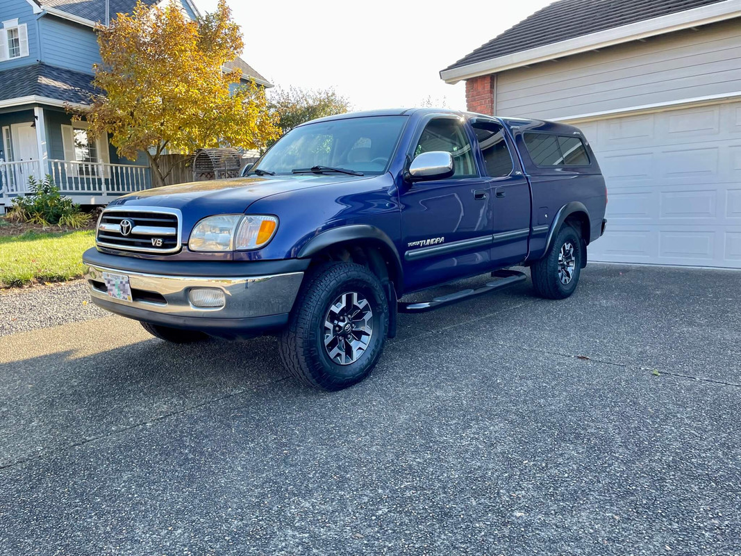

    We've replied to each other many times but I don't think I had seen a pic of your truck until now. Truck looks real nice. Good wheel choice :thumbsup:.
    I think the other option could be to just remove them from the rest of the truck and just have none at all.

    So per @NickB_01TRD I went ahead and removed the fender trim on both sides. It's symmetrical now, but looks too bare to me. It's throwing a bit of road debris onto the front fenders now too. The old ones left the paint a bit etched and then there's the holes the previous owner drilled into the passenger side front fender to keep the trim attached. :mad:
    I think I might opt for these flares. Not sure if I want the faux pocket bolts or smooth. It's not worth painting them so they'll be black either way.

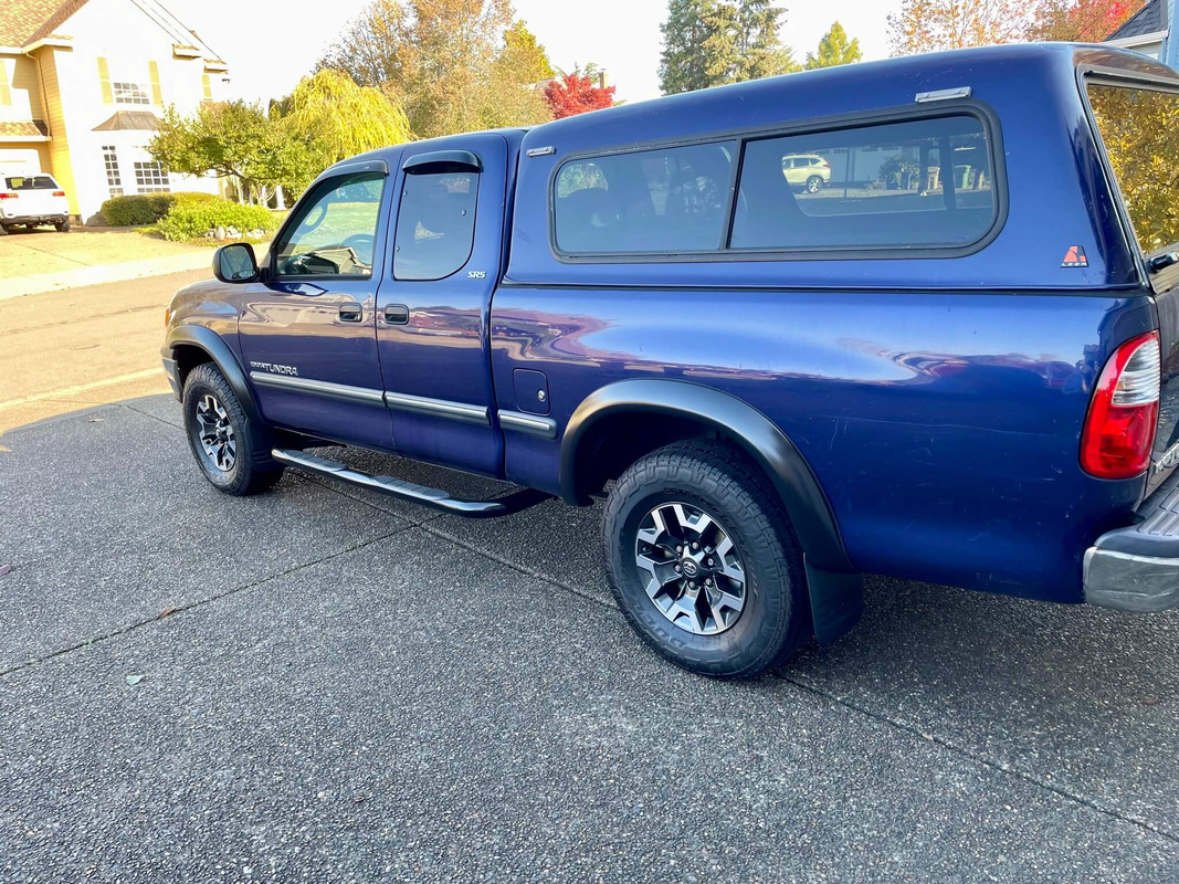

    After not having any luck finding the front trim pieces, reaching out to Rex (never heard back) and finally removing them all (didn't like how plane Jane it looked), I went ahead and bought the fender flares I linked above.
    To keep it from rusting I filled in the three holes the knucklehead previous owner drilled into the front passenger side trim to hold it on when a few of the mounting bolts fell out. I used Permatex 25909 Liquid Metal Filler and it worked great.
    Per @NickB_01TRD, the new flares fit fine, just didn't use the small front bumper/fender piece. I told the seller that he should update his listings to 2000 - 2006 year models with that notation. That should increase his sales.
    I don't know if other flares are like these, but they have a small rubber seal around the top edge to keep water, dirt, etc. out. It's held on with 3M adhesive strips. It comes with the flares but you have to install it yourself. It is small, uncooperative and VERY tedious to install. Per the video I posted above you have to carefully push it onto the edge of the flare and it's a royal pain. It took more time to put the rubber seal on the flares themselves than to install the flares! I also told the seller that having them pre-attached would be ideal, but if not, if the inner part were wider it would be much easier to do. Let's say my cuss jar gained some value.
    Finally, for models that had the chrome trim like mine, the kit uses three brackets each on the top side of the front fender for mounting. The instructions show them, but they don't specify when to install them. I tried doing it with the flares attached to the fender at either end and it was a nightmare. Finally I pulled the flare back off, installed the brackets first and then put them on. They're still a bit of a pain, but that worked much better. I told the seller that he should update the instructions to include that. Would have saved me a good 45 minutes or more. No idea if he'll take any of my advice, but I wanted to add it here for anyone that follows.
    Overall, not terrible to put them on once I figured out the easiest way to do it by trial and error. For trucks that have the chrome trim, they use all of the original mounting holes, work with the OEM mud flaps, etc., no drilling required. The flares themselves are very good quality and should last many, many years. They can be painted, but it's not worth it for my truck. I like how they look as-is anyway.
