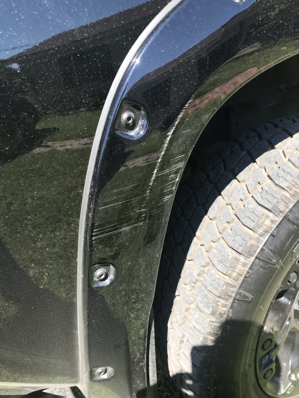

    Any ideas how to get this scuff off my fender?

    Clean, clay, try a polish first with a DA, like meg's 205. If that doesn't do it try a more aggressive compound then polish. Then clean again and last protect with sealant or wax.

    This would be worth a shot, especially if it's just some paint transfer. Good idea
