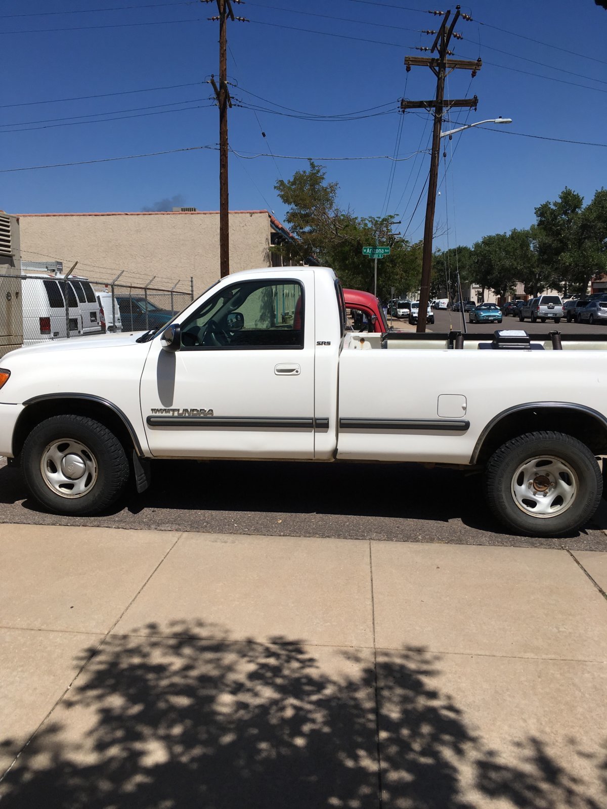

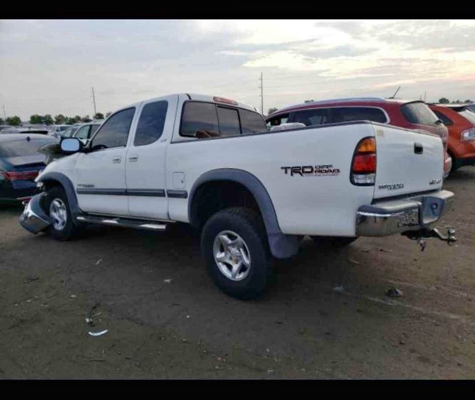

    Mine versus the possible donor.

    your fenders don't have the square holes for the mounting clips, so you will need fenders too.
    FJ432[OP] likes this.

    Well that makes it a deal breaker. The right fender is wasted. Thanks for the info.
