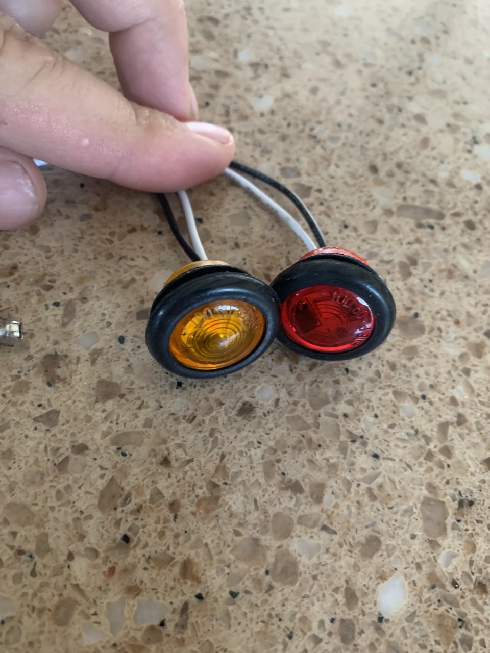

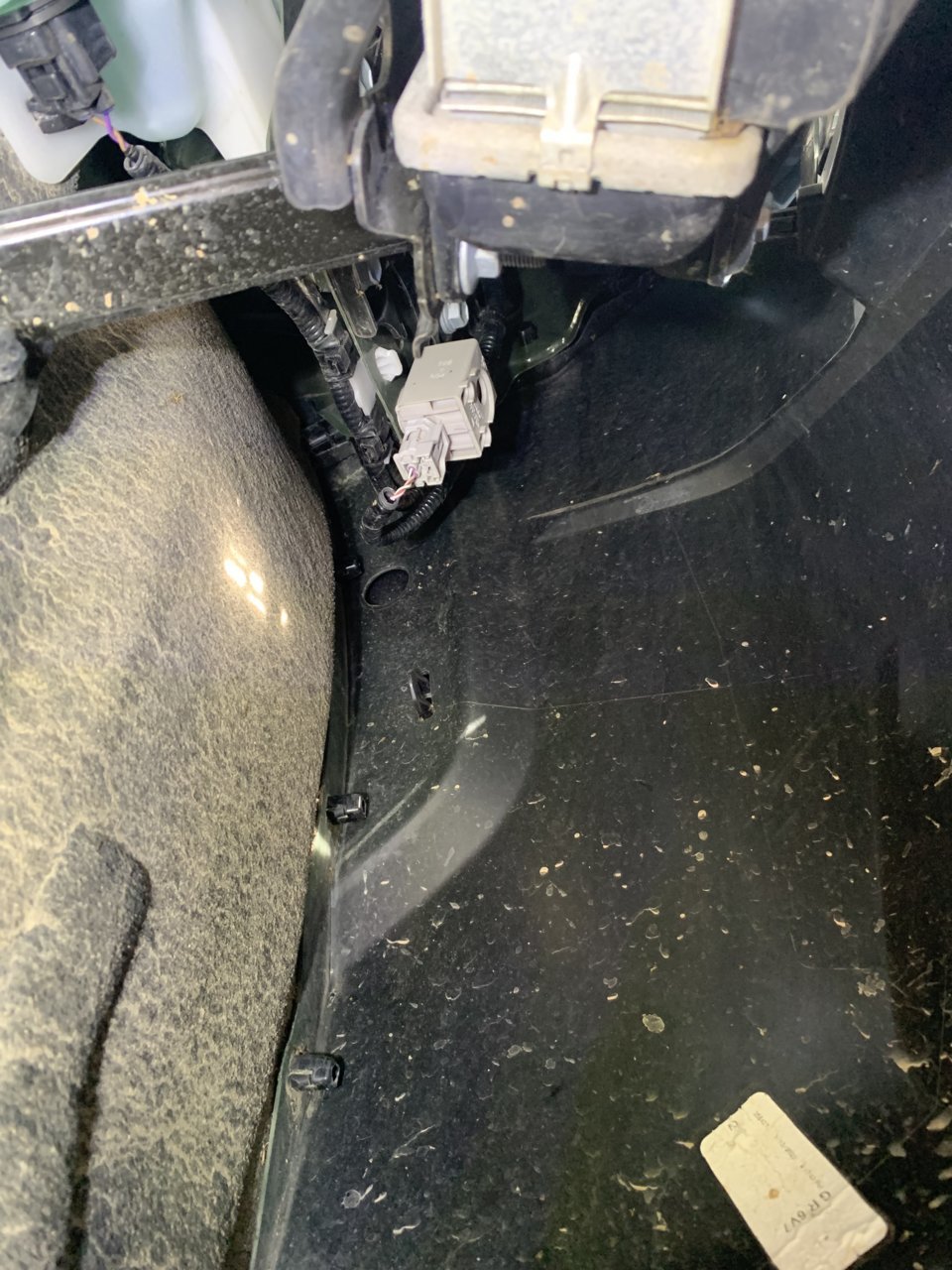

    Anyone install clearance marker lights in the fender flares like the PRO?
    I picked up 3/4” LED penny lights, that I’m going to put in shortly. The holes are already in the panels behind the flare, just have run some wires unless someone with a PRO can show where they plug in? ;)
    I might smoke them with some flat black, so not so noticeable, I was thinking of just ordering the pro flares but not a fan of the camo pattern and texture of them.

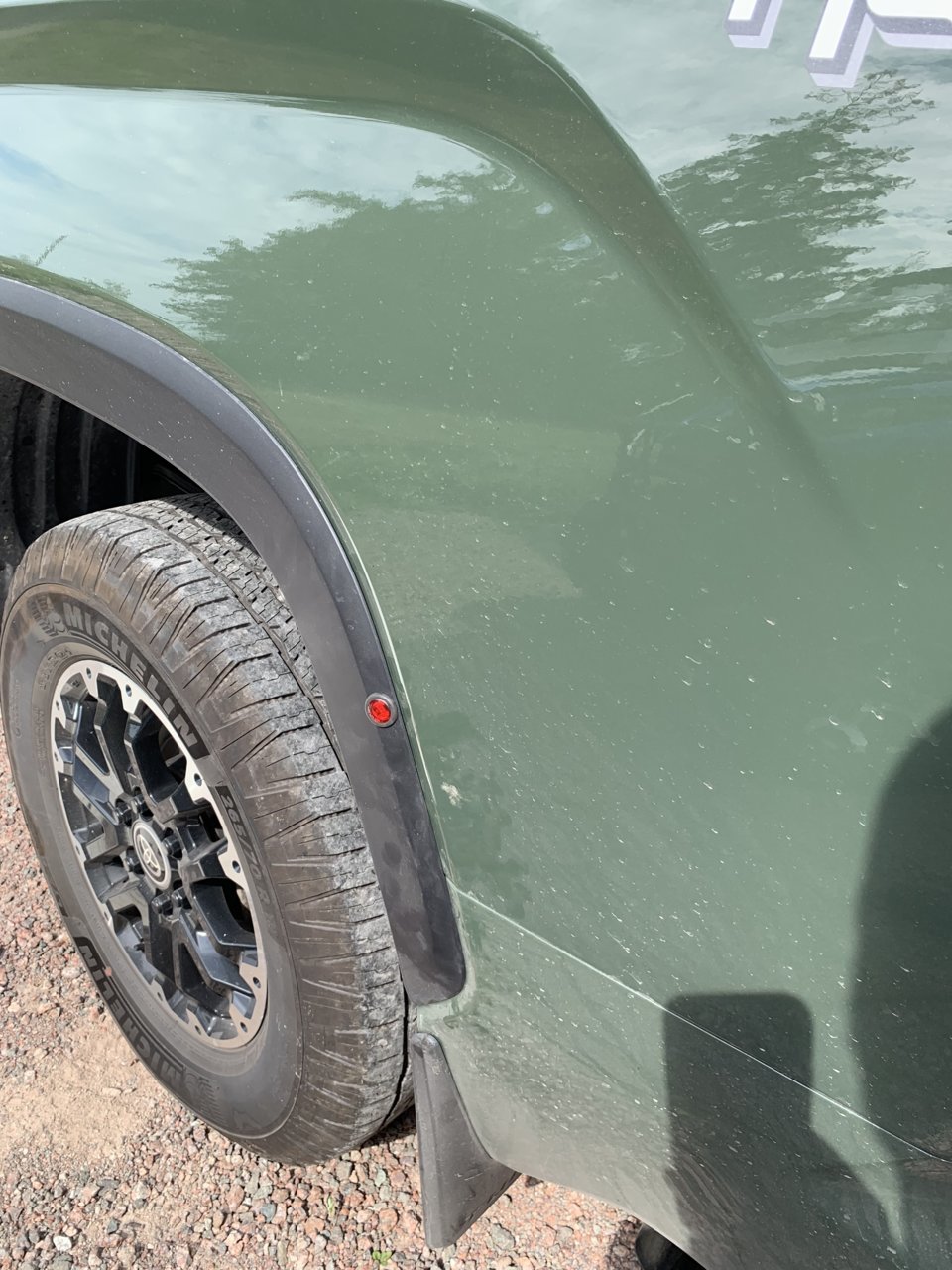

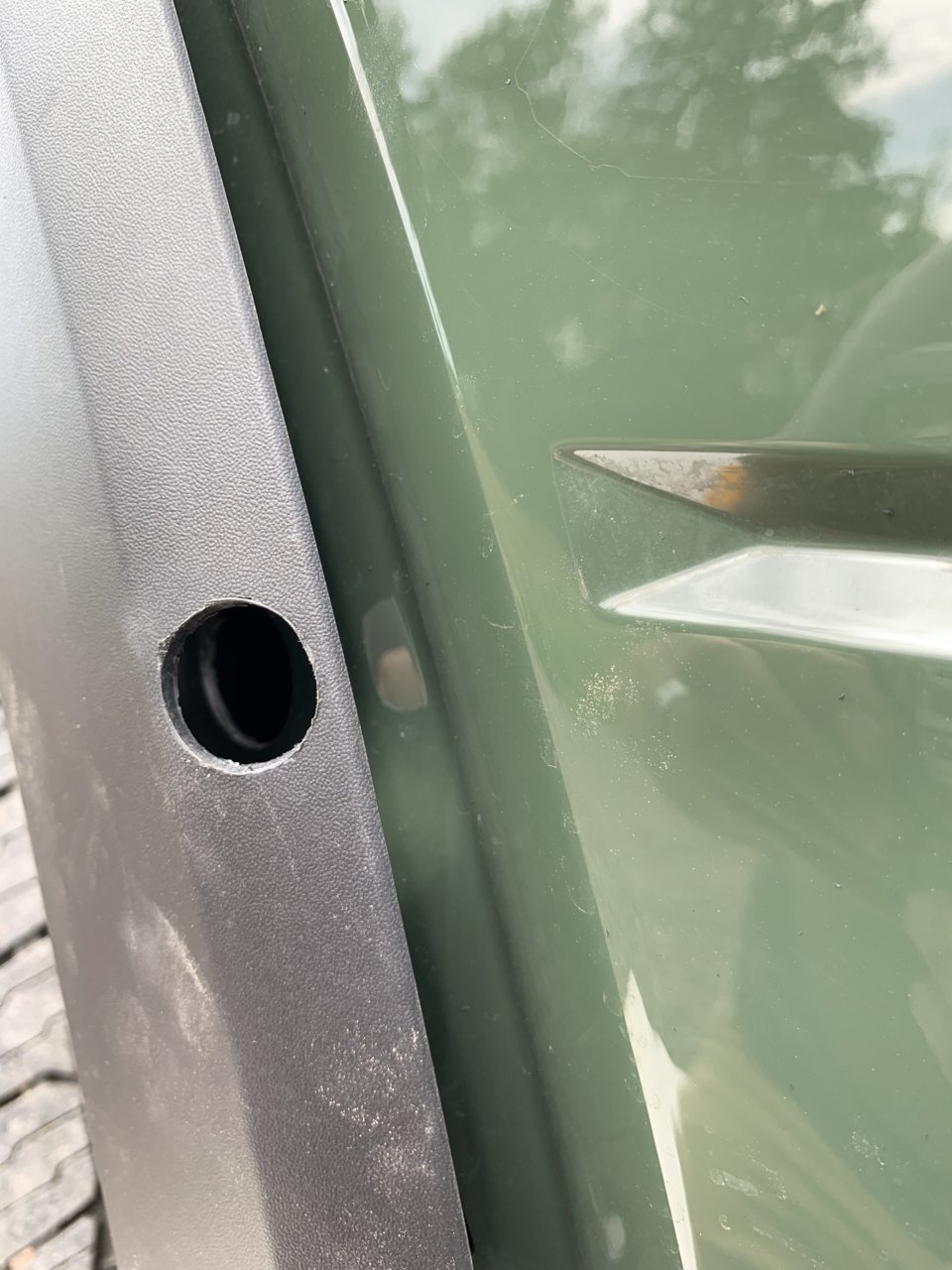

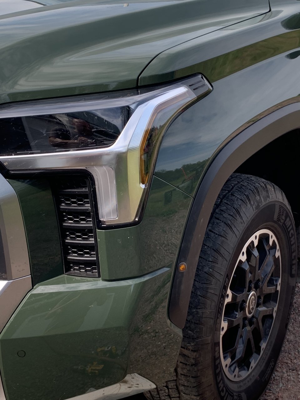

    Well bit the bullet.. started drilling my new truck lol
    first one in.. get them all mounted then start wiring them. See what they look like finished in the dark and decide if I need to smoke them with some black paint.

    Looks good. I've seen people do it on Tacoma's. I think they wired to the tail light fuse so comes on when parking lights are activated.

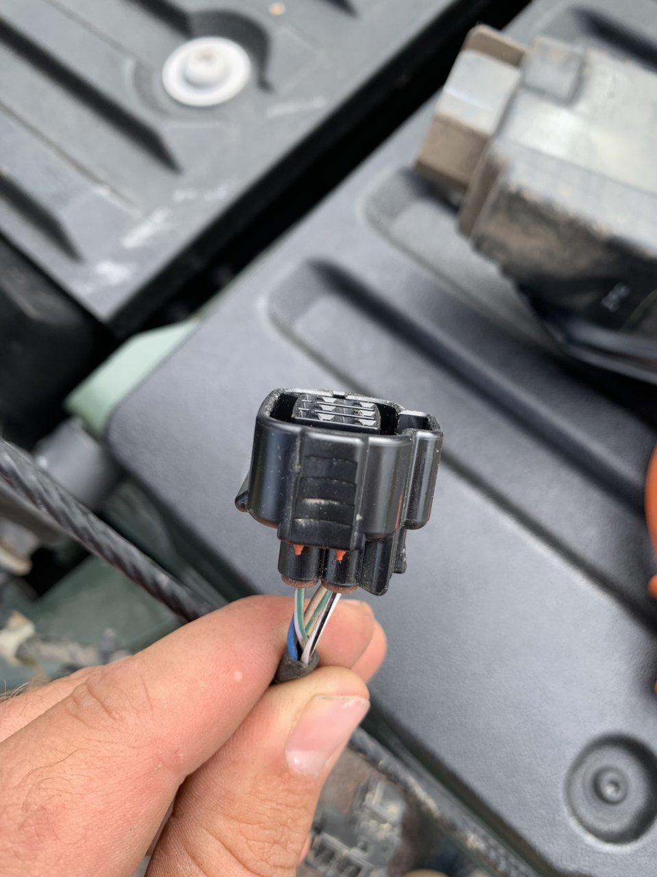

    Yup that’s the plan cut splice and double layer heat shrink lol to try and stop corrosion..

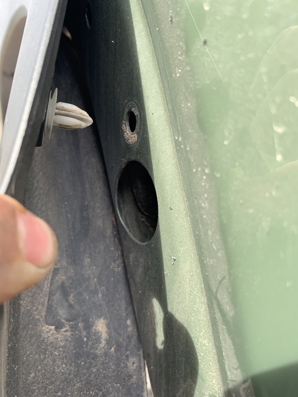

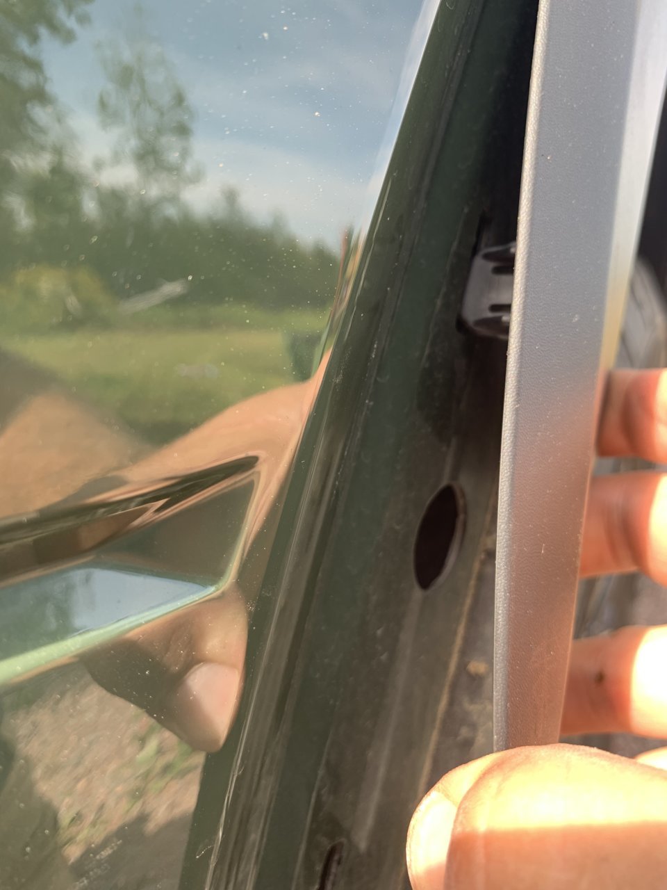

    Back one in… had to shave down the back of the light, not much gap behind the flare, maybe 1/2”. And the hole for wiring is on an angle towards the front of the truck from where it mounts.

    Wiring hole alignment
    White wire/green stripe is parklight power supply for rear
