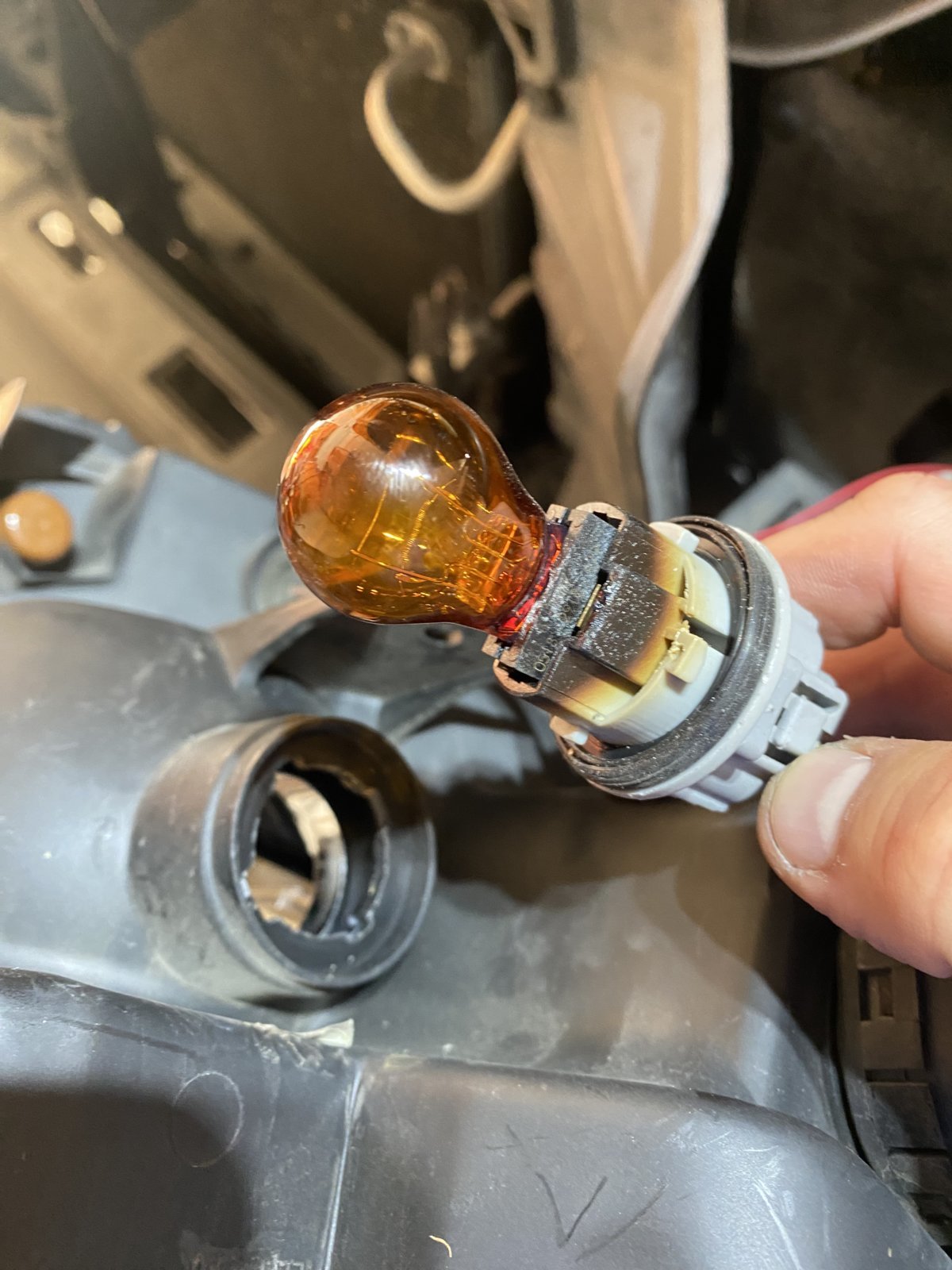

    It’s been some time since I was into the headlights and forgot the Alpharex uses the OEM amber marker light as well. The harness plug has seen some heat over the years and torched the bulb. Replaced it and all is well.
    I’m either going to pull them out and seal off the hole then tie the harnesses up after painting the bulbs with high temp paint. I will either do that or find some LED bulbs that will run cooler with internal resistors that prevent (hopefully) the quick flashing thats indicative of replacement with LED.

    That looks bad. Is that a dual filament bulb?

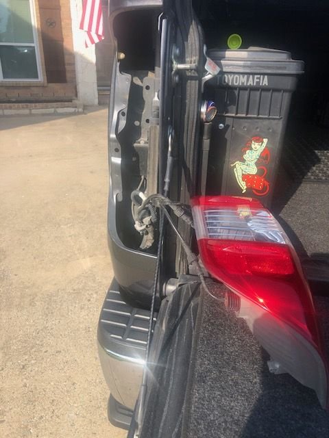

  11. Jul 18, 2024 at 5:35 AM
    1lowlife
    May 4, 2016
    #3296
    10,690
    DADA
    THE GREAT STATE OF TEXAS
    2014 MGM DC SR5

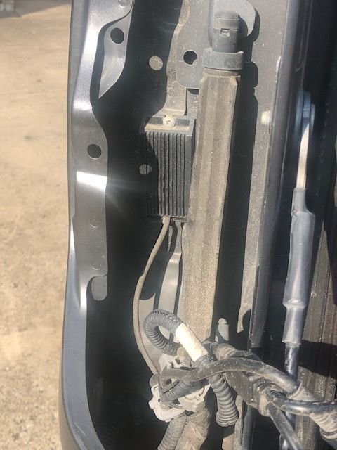

    A cheap LED bulb with an internal resistor may end up just like your halogen bulb.
    If you decide to go with external resistors and LED bulbs, VLED makes some nice ones.
    They are big and will dissipate heat much better than a bulb with an internal resistor.
    VLR Resistors - Parts (vleds.com)
    VRL3 will cover front and rear on each side VLR-3 RESISTOR WC STYLE (vleds.com)
    VLR6 will cover just front or rear if you only want to do the front. VLR-6 RESISTOR WC STYLE (vleds.com)
    Looks like the tap adapters are sold separately now. DUOTAP HARNESS WC STYLE CONNECTOR (vleds.com)
    I mounted mine behind the tail light.
    g0uw0iy9_cb97e2ca21c32f29848c5903dea93b9505ce7a8c.jpgwnmu2z5a_cbfd61148927f48fe11b9e53938f0477943ae036.jpg
    Good luck..
    iHacker and Retired...finally like this.

    Yes, DRL and front turn signal..

    Is the DLR using the brighter, higher current filament?

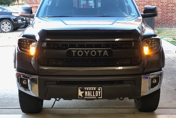

  14. Jul 18, 2024 at 6:17 AM
    redrdr67
    redrdr67 New Member
    Aug 17, 2022
    #82055
    55
    SoCal
    2007 White Tundra RCSB 2wd
    Have you looked at your driver's side turn signal bulbs carefully? Could be a filament that has severed but is still making contact, until it vibrates enough. I've had this happen a couple of times I the last couple of decades. Ohm meter will help

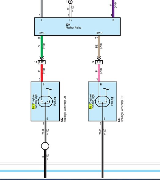

  15. Jul 18, 2024 at 6:36 AM
    1lowlife
    May 4, 2016
    #3296
    10,690
    DADA
    2014 MGM DC SR5
    Yes, it just blinks for the turn signal.
    The dim one comes on with the parking lights.
    Screenshot_2024-07-18_083921_71c4cda1ea088fcc0887520f5385bfc2074de365.pngScreenshot_2024-07-18_084051_36af5d572a85abbf2d89f1eb46bbb5d375520528.png
  16. Jul 18, 2024 at 6:38 AM
    Retired...finally
    Retired...finally Utilizing that doctorate of procrastinatory arts
    Aug 6, 2021
    #66426
    3,274
    Dan
    2021 Barcelona Red SR5 Crewmax
    Custom bug spat pattern hood, grill & bumper. Dead Live Oak leaf collection under hood, cowl and lower fenders. Beach sand custom floor covering.
    Ouch. Don't think the socket is designed for anything more than intermittent use of the higher wattage filament.
    1lowlife[QUOTED] likes this.
  17. Jul 18, 2024 at 6:45 AM
    1lowlife
    May 4, 2016
    #3296
    10,690
    DADA
    2014 MGM DC SR5
    It is on all the time..

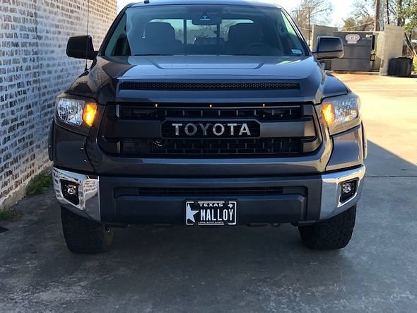

    I've been using LED bulbs for years for the front turn signal and parking lights..
    Old halogen headlights w/ LED turn/DRL
    OEM LED headlights w/ LED turn/DRL
    I had @iHacker wire it to keep the amber DRLs
    iHacker likes this.

    LED bulbs pull much less current. The picture posted above looks like an incandescent bulb.
