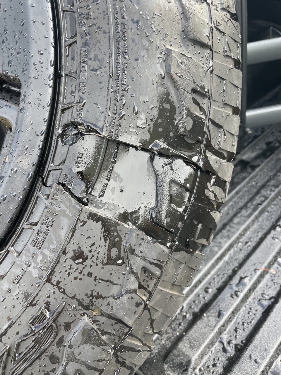

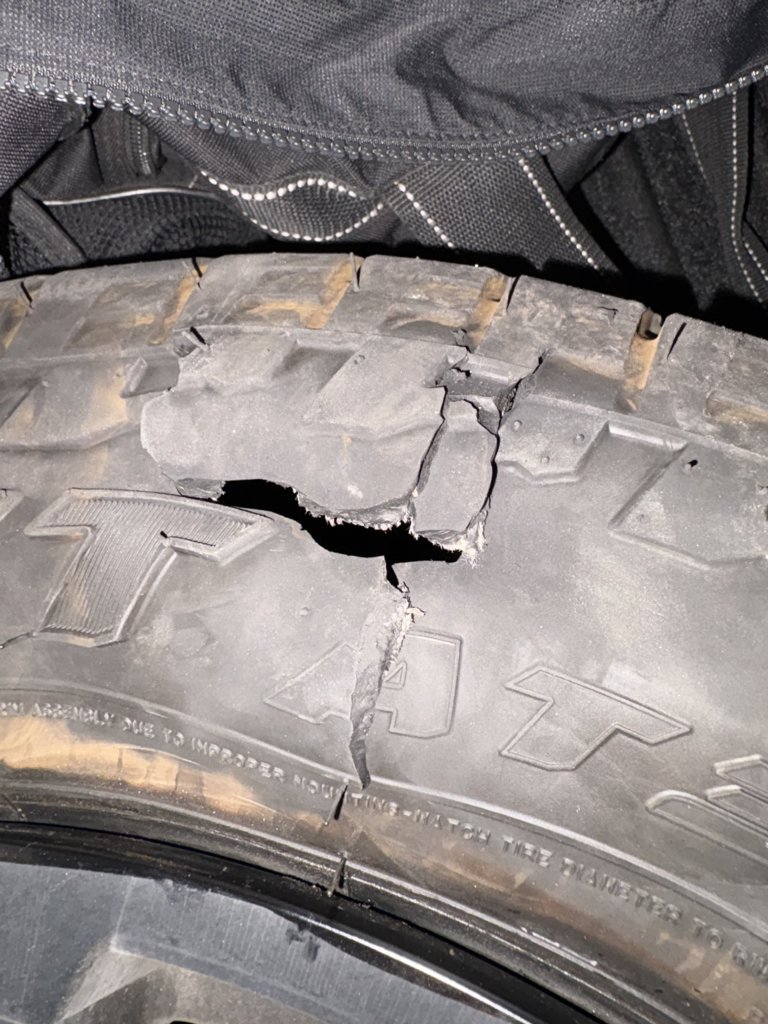

    Ok. Proud owner of a 2022 TRD pro. Had a total blowout last night with my 14 year old son.

    May want to contact falken, unless you drilled something in the road. That sidewall blowout looks suspicious if no contact with something.

    luckily op seems ok after the incident. Would had been so dangerous if he was going freeway speeds. I wonder how that sidewall cracked open like that too. It does look like it might have came into contact with something.

    Nothing in tread, total blowout

    55 to 60 mph. 308 Winchester went off it sounded like. Pouring rain, made to a safe pull off and changed tire in the rain. No damage on tire surface whatsoever. Swervin Mervin

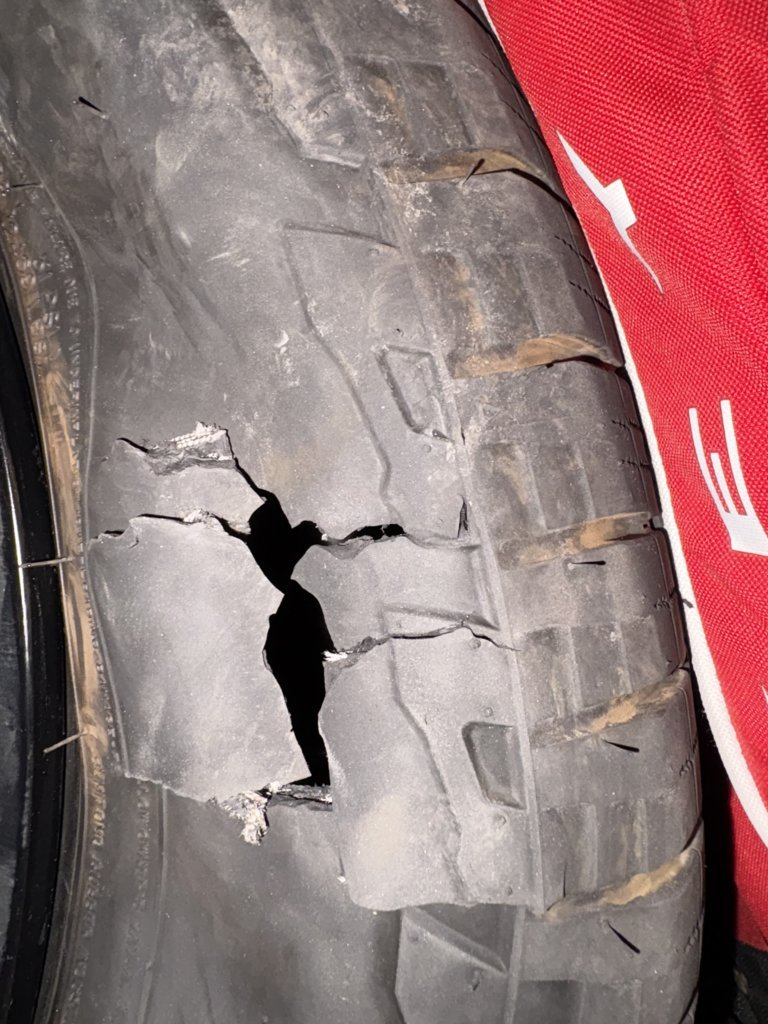

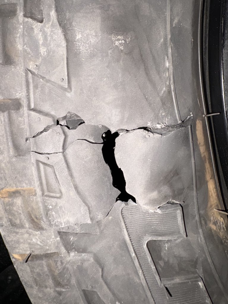

    Geez! Appears to have ruptured in three different places around the tire.

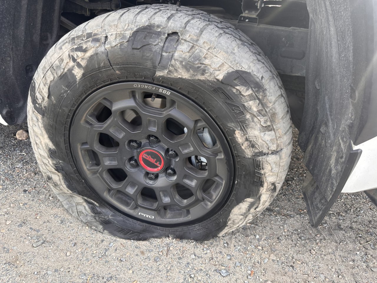

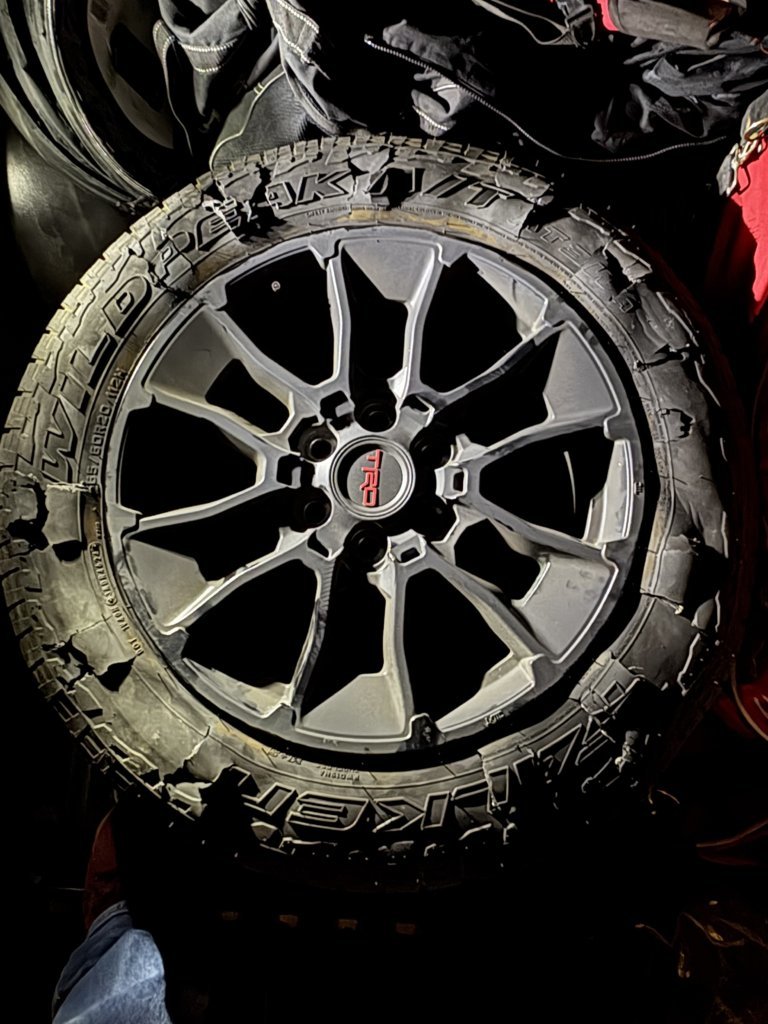

    The same thing happend to me today, but with 11 year old son. 2023 TRD Pro is two weeks old and at 1,000 miles. Driving the HOV lane on Central Expressway in Plano, TX and boom!...the rear driver side tire blows out. @Falken QA please help make this right. I guess I'll look cool for the time being with a tire sitting in the bed...

    I know the perceived 'lack of accountability' is frustrating to you and a blowout is never fun to deal with; especially when family is in the car with you or by themselves when it happens. The tire may, in fact, have failed on it own; but, that is not common.
    Something to consider, is that blowouts to tires can occur subsequent of the damaging event. In other words, a sidewall may have sustained damage from a previous incident w/something in the road, a curbing, etc. and that injury may have gone unnoticed at the time, but in fact the tire may have sustained enough impact to cause it to be 'bruised' or mitigated the sidewall's integrity. This is especially true w/P rated tires that are only 4/2 ply rated (4-tread / 2-ply sidewall).
    C, D, and E load range tires are heavy and provide more resistance and resilience to damage from curbs, rocks, and crap in the road that may impact the tire (especially in the sidewall where it is more vulnerable).

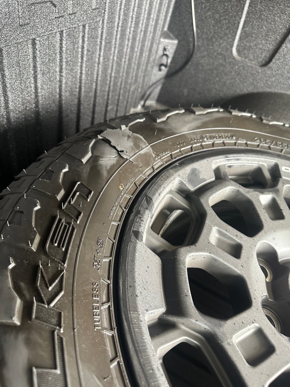

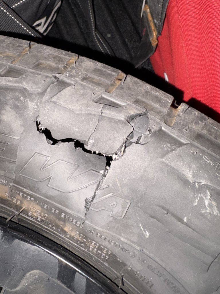

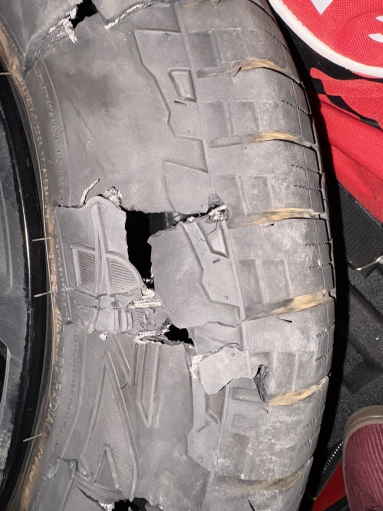

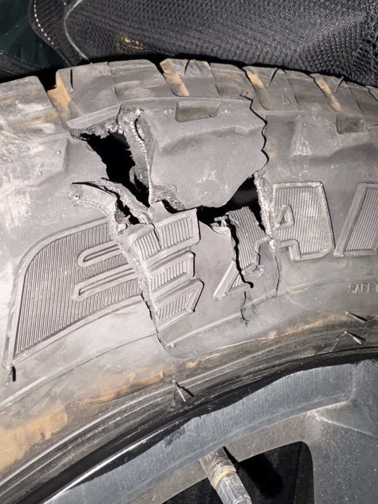

    Wow! Cruising on freeway yesterday about 70 MPH. Falcon Wildpeak A/T3W, 2022 Tundra TRD Pro, complete blowout on driver rear. Looks just like the picture above. 20k miles on truck.IMG_5644.jpg

    I took it in for 20K service and expressed concern with how tires were wearing at 18k miles. They told me I probably needed an alignment. Had 4 wheel alignment with very little adjustment on front driver. The problem was all 4 tires are wearing the same. At 7 K mikes had 1 of the Falkens replaced due to a nail. My advice is don’t trust them. They are too soft and wear fast. Found many similar failures searching the web. Good luck and Godspeed! Think I am going with the Toyo Open Country A/T III.
