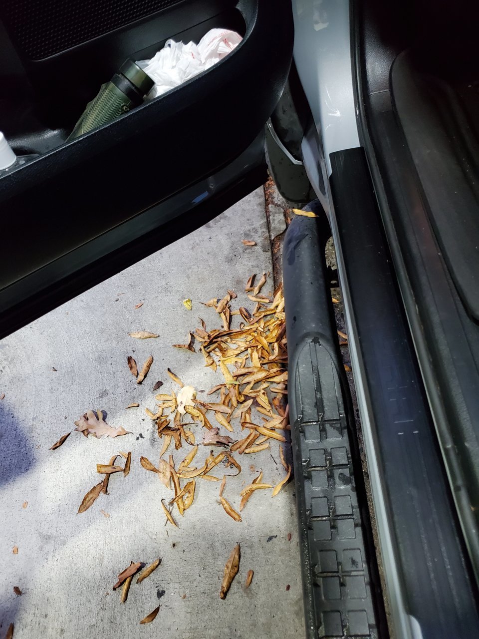

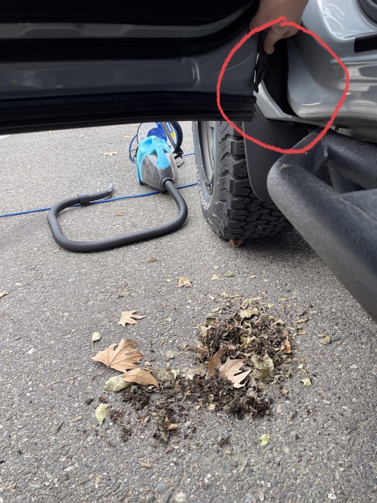

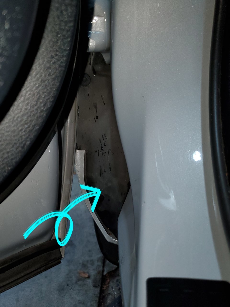

    Always amazed at how much leaf debris gathers here. Pull back this flap and clean out all the debris that gathers:
    This much debris gathered over only two weeks:

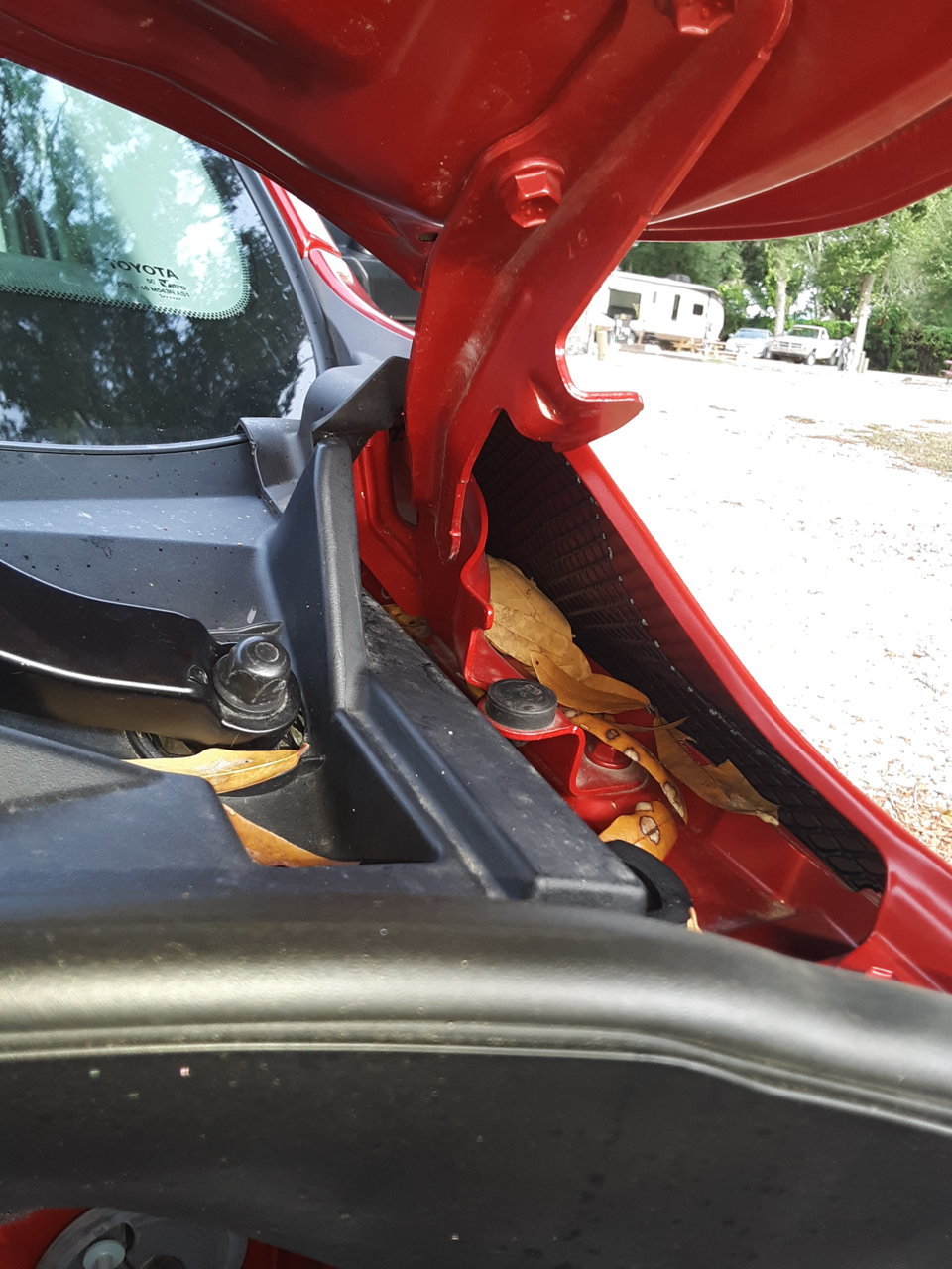

    I'd like it if mine were fu..ll of aspen leaves and not these dang pin oak leaves. They are the worst.
    Thanks for sharing! I'll give this a try.

    That's slick! Did you find the material at a hardware store and just cut to fit and stuff in the corner?

    It's some cheap gutter screens from Amazon.
    https://www.amazon.com/gp/buyagain/search/?q=gutter
    It was cheap. I think I paid some ridiculous price like 19¢ when I bought it.
