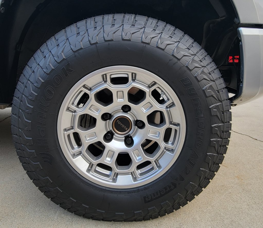

    I recognize those AGP wheels! How you liking them? Any issue with sling on the side of truck or balance issues?

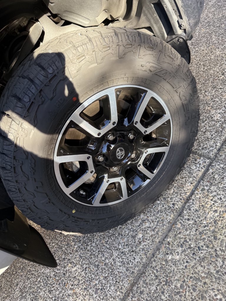

    C rated is more plush feeling and better ride comfort. E rated will be stiffer, but more capable for tow feel and side wall protection. I personally have Falkens Wildpeaks AT4Ws in E range, love them. I like a stiffer ride, but I also tow more. I like that they can handle more pressure and range for PSI.
    Also, if you want triple side wall, their Duraspec, you need to specify it. E range doesn’t automatically come with it, most are 2 ply side walls otherwise. Each e range tire I believe can handle 3,600 pounds each! Very capable tire. 60k warranty and 18/32 tread. I vote E rated. It’s a super quiet tire, I don’t ever hear it. C load range is 65 k warranty and not much more for the E rated one. If you off road once and it saves your tire, it’s worth it to me.
    I would make sure to get a cooler too. Genuine transmission cooler is what I installed.
    here is a pic of my wheels

    No balancing issues. I have driven 500 miles with no vibration.
    As far as slinging...I had 0 offset wheels before and it was annoying keeping the truck clean.
    I bought Ark Mud guards for them but was lazy installing them. I barely got these wheels last week and a couple days later I installed the mud guards. So I wouldn't know how bad they are. It shouldn't be too bad though.
