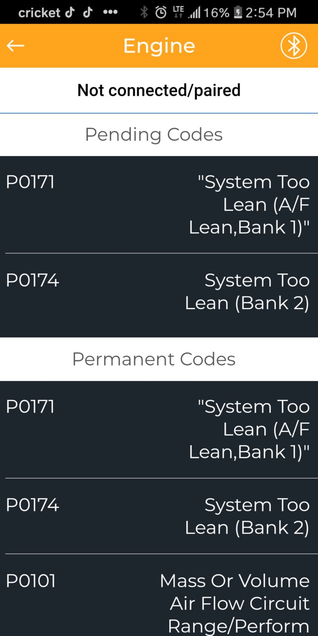

    And Bleach, i dont guess i was thinking at all. Of course i got rid of the cats for 400$ and bought the device that was supposed to "fool" the ecm to thinking cats were still there. Guess what. It dont work. Lol. My yota runs very very rich and the trac off light, engine light, and 4lo flashing stay on. I attached a pic of the codes. Ive gotten used to it , Screenshot_20200612-145438.jpg

    I am not an expert but that is showing you running too lean not rich. You better be very careful with that as lean can cause excessive heat and burn up your pistons.....
    not saying that would happen, but I would be going back to stock ASAP.
    One person on here who could help is @dirtydeeds
    He is a resident expert on exhaust and would probably steer you in the right direction of getting cats or making what you have work.
    Did you replace the whole exhaust system or just cut it off?

    My Cat recommendation would be a "MagnaFlow high flow universal cats " their about $86 to $156 apc depending on size , might need to add a extra $20 for extra pipe as their length might be shorter unless you already have pipe in place of the existing space of the oem cats.
    Recommend places:
    Summit racing
    Jegs
    An dont forget the correct i.d /o.d .
    An welcome
