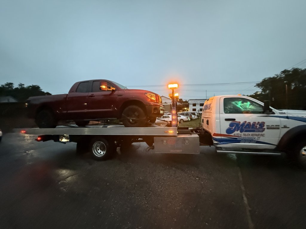

    Accelerated pretty hard onto the highway and the engine gave out abruptly. It didn't completely stall, but was hovering between 750 and 1500 RPM and not responding to the gas pedal.
    4LO was blinking.
    I pulled to the shoulder and had no power at all; the engine was running but truck wasn't moving. I turned it off and on again and 4LO was still blinking. It cranked for 4 seconds or so before stopping on its own.
    So I got it towed to a local shop, but it'd be great if y'all had any idea what might have happened.

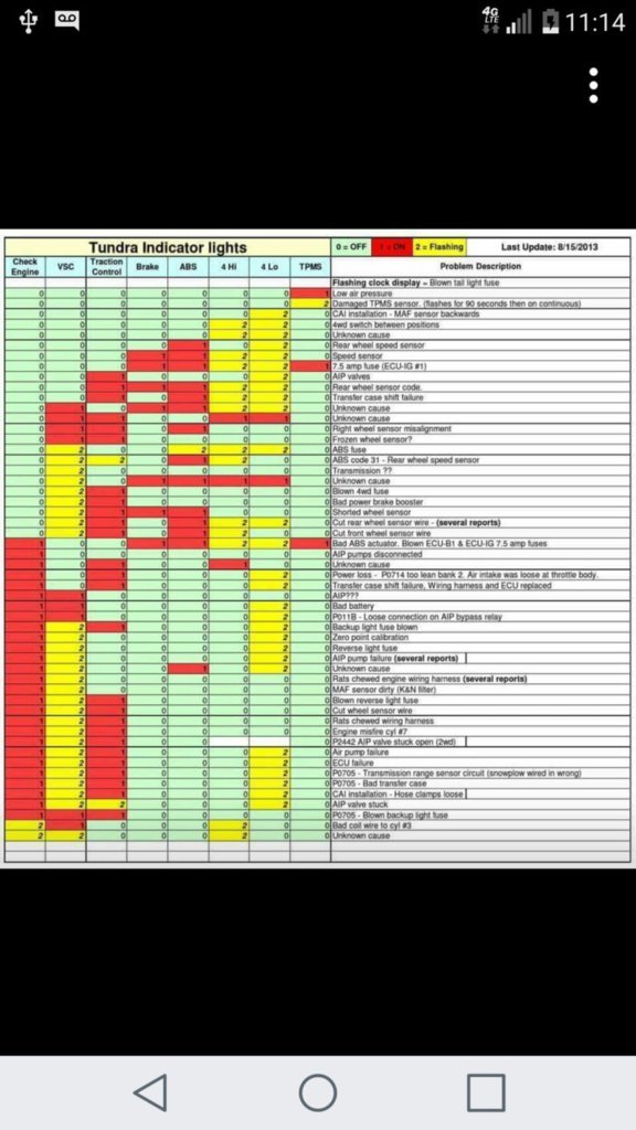

    This says only 4 lo flashing is CAI/MAF sensor related. Have you done any work to the truck recently? I remember a thread years ago where a guy was off road and his truck died with the same symptoms. Turns out the tube from his airbox to the intake came loose. I think he just put it back on and tightened the clamp and was good.
    A loose intake tube would correlate with it happening when you were accelerating. Maybe the MAF sensed too much air coming in.

    Not my diagram but it’s been floating around here for years. It’s helpful as a first start when you have a dash light.

    Thanks, I'll check it out.
