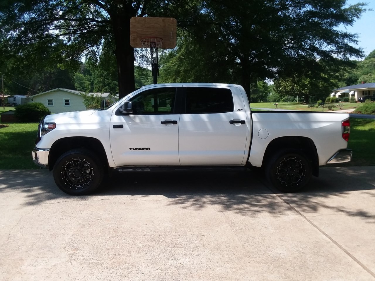

    20190111_131453.jpg This is what mine looks like with an 1 3/4" rough country leveling kit.
    TOYOTRD8 likes this.
