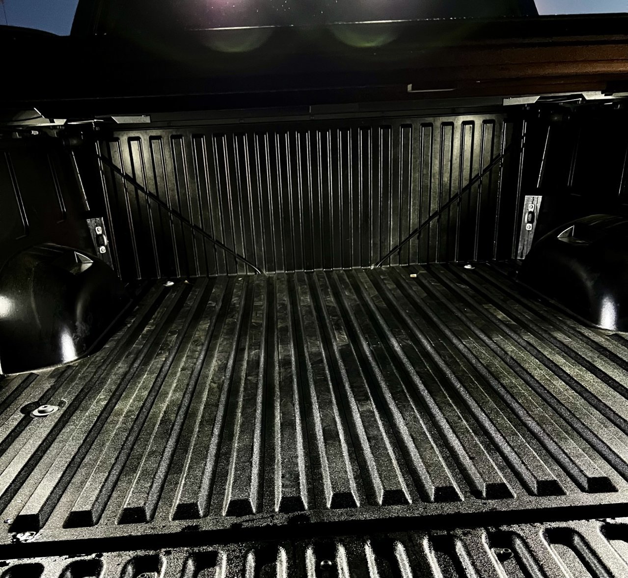

    So after weeks of conversation with Toyota about the excessive amount of water the tonneau cover allows in the bed, i was told by a senior member that they are pleased with the design and it is functioning as intended. Unless there is an outcry from owners, i am the proud owner of a $1300 cover that only prevents my belongings from flying out. Anyone else having issues and have you reported with brand engagement?

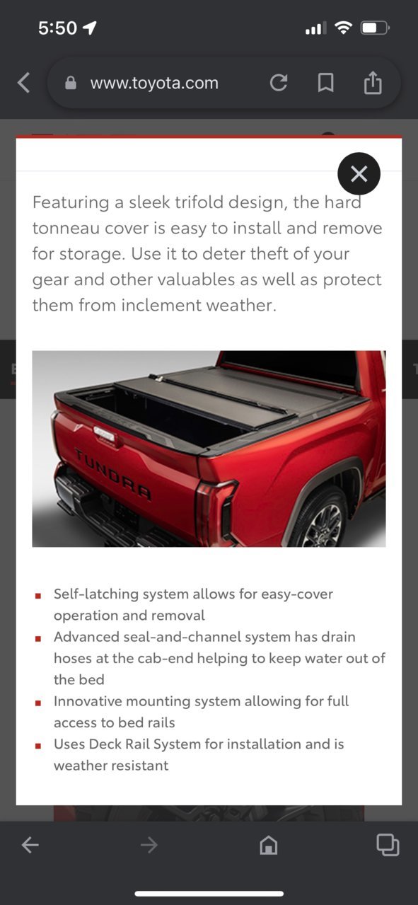

    Is it advertised as waterproof?

    When i purchased in May there wasn't any mention of waterproof or not. Just protection of valuables.Even the dealer told me it was the one i wanted to protect my gear and valuables from the elements.Fast forward a few months later and the language on the build website has completely changed. Here's the original below.I even mentioned it/uploaded it to my case file and they said volume speaks

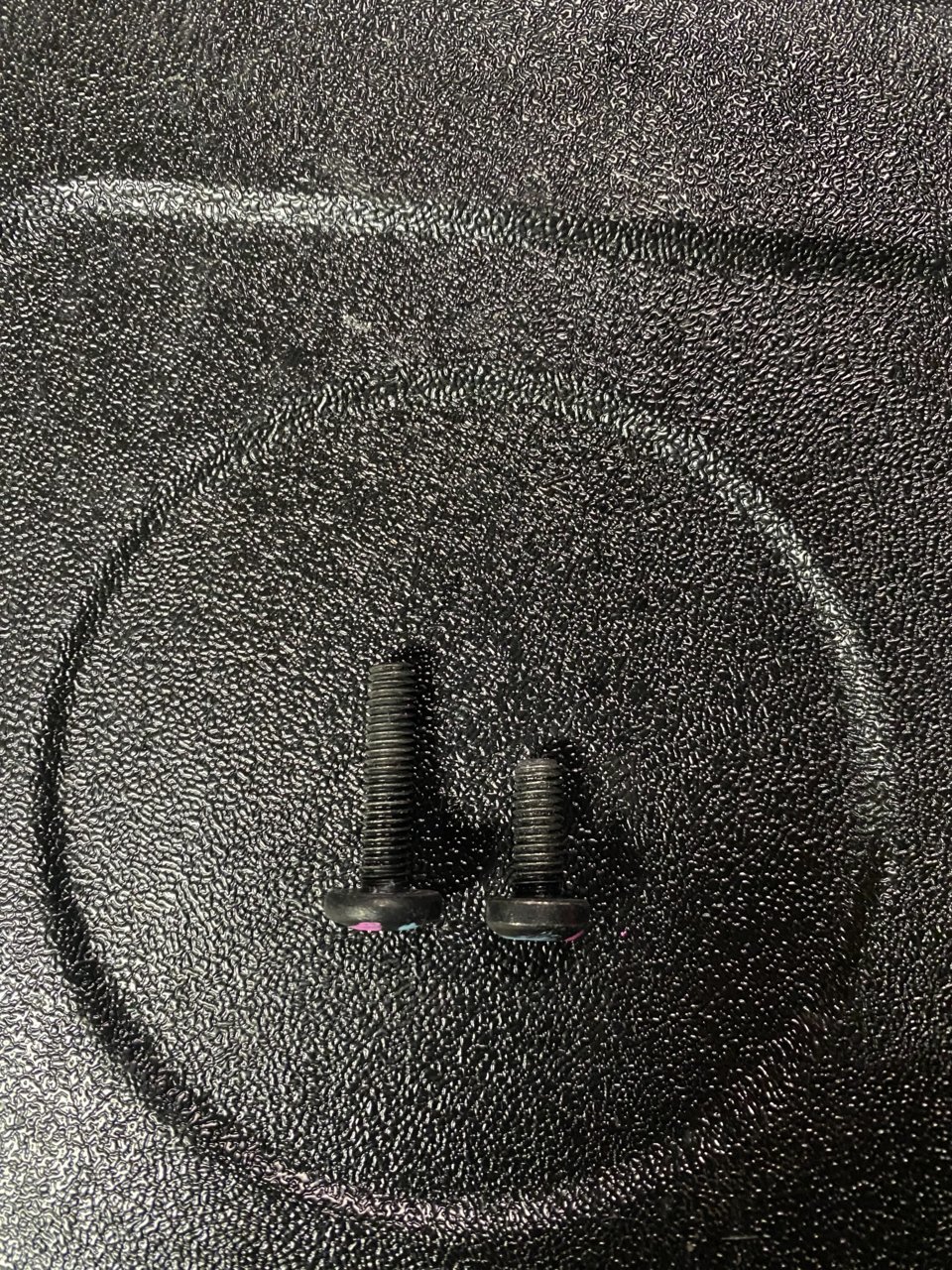

    This might not be the best thread for this question, but does anyone know which of the torx screws in the picture below comes with the factory tonneau cover? I am removing the cover to get my canopy installed tomorrow and would prefer to keep the right hardware together.AB7AFABE-E124-426B-AB09-AEB18B96828D.jpg

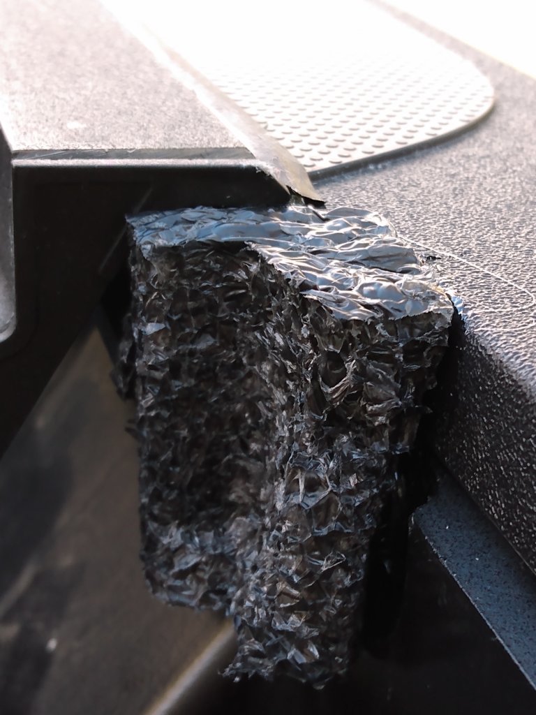

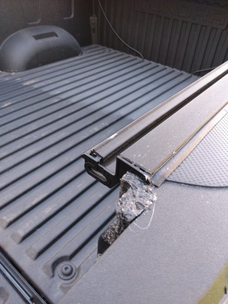

    In another thread on this forum, I reported that I was getting significant water infiltration on the passenger side of the bed. I have the BakFlip MX4 which I believe is the same as the Toyota cover.
    Today I finally did some testing. It is important to note that I always back the truck in my driveway and there is a significant tilt from front to back and driver to passenger.
    I flooded the cover with the tailgate down and did not see any leakage.
    I put the tailgate up and flooded the top of the tailgate. I did see water leakage.
    I’m not sure but I believe it is coming in from the back of the cover where it seals against the top of the tailgate.
    Some could have been coming in from the significant gap between the tailgate and the bed wall.
    Unfortunately, the cover doesn’t cover that.
    To mitigate that I glued in some hard foam blocks with E6000 (similar to Goop).
    What I need to really test my theory is to park the truck facing the garage before the next rain storm.
    EDIT: I finally tried parking the truck in opposite direction just before a heavy rain. Just saw a few drops at the corners on the tailgate. So not sure if those foam blocks are helping. Bottom line, almost all tonneau covers leak a little so just learn to live with it.
