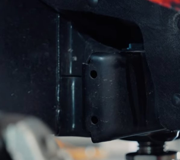

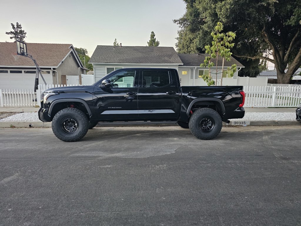

    I am running factory lift with 37’s, 0 offset wheels. I had to chop the body mount which is an easy DIY at home with no welding etc needed. I also removed metal piece behind the fender liner. All super easy. Nothing else needed to be done.

    Wow that looks really clean. I think I can probably get by with 35's but thats not the same look. How bad was the rubbing without the chop?

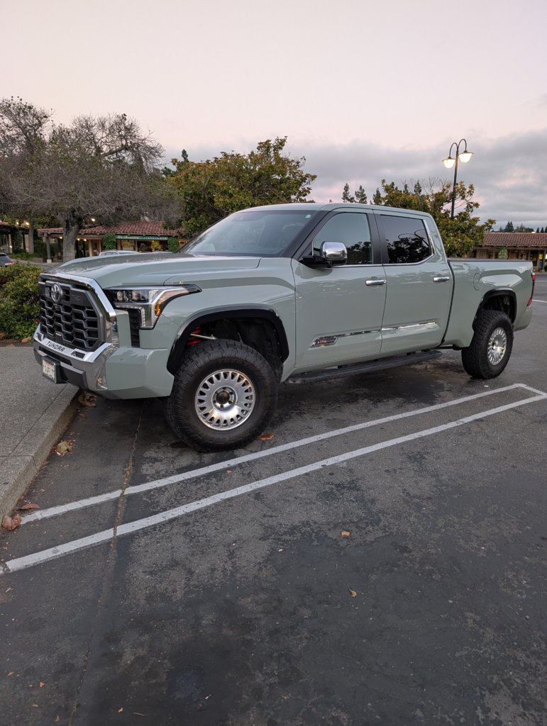

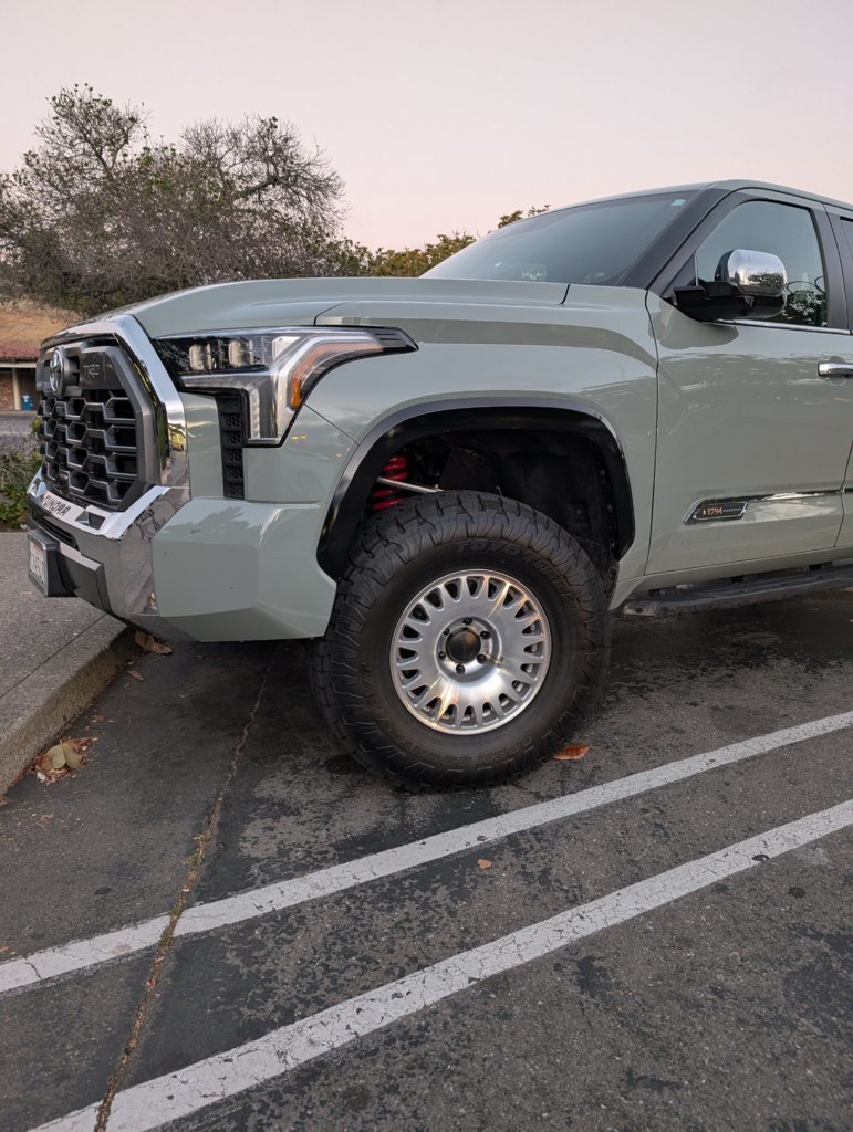

    I just got a set of 35" installed on my 2025 Tundra with factory lift. At full turn the tires rub the frame.
    I was really hoping this could be avoided. Sounds like 33" is the max.
