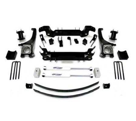

    I am a complete newb when it comes to suspension so be easy with me. I've tried to search but could not find what I an looking for. So I have a 4 inch Pro Comp lift on my 4x4 Tundra and am interested in raising the rear a little so it has more of a factory rake to the stance. Is this even possible with either some shackles or different shocks in the rear? Or would I need to get the whole 6 inch kit and replace the 4 inch with it? I've emailed Pro Comp last week and they have not responded yet. Would some shackles from @Coachbuilder1 work for this purpose or is that considered stacking lifts?

    I'd think you could just add shackles with a leaf pack and get whatever amount of lift you want. It's not considered stacking lifts.

    Im getting a 6in installed right now actually and I hear your concern. It's not considered stacking if you add shackles. For my 6in procomp they put a 3 in block and AAL in the rear. If it isn't level I'm gonna go with a shackle as well. Coachbuilder is good but depending on how much you want to raise it id go with a toytec shackle. It's adjustable from 1 in to 1 1/2 in 1/4" increments

    Here is what is on it now.
    So its possible to just add the shackles and be done with it then? Would adding shackles require a re alignment as well?

    Nope adding shackles should not require an alignment. How much are you looking to raise the hind end?

    Probably around 1 or 1.5 inches. Does anyone know what the factory rake is?

    My truck was 1 1/4" higher in the rear

    Good to here! Sorry for my ignorance, but what purpose do the lower bushings serve? Would I need those as well?

    Yes i would get them. They are just better quality then the stock ones we have.
