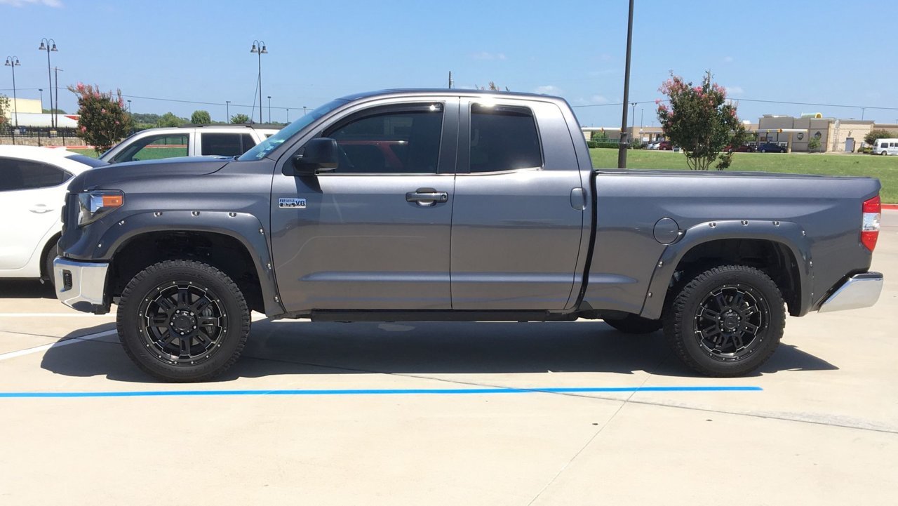

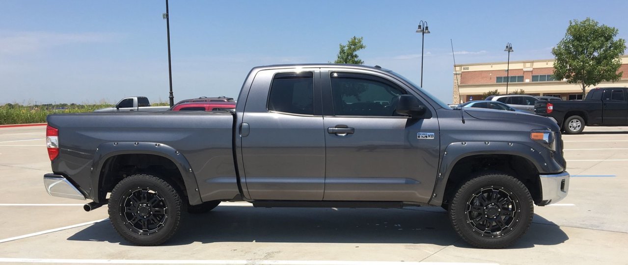

    My factory rake on my 2014 was 2.25" on the left side and 2.5" of the right side..
    I installed 6112s on a setting that gave me 2.5 of front lift and the truck pretty much sat level.
    763B91DF-899D-4443-A7EC-B9CE39DA5452_zps_bea47deabf8dc5fbeea4cb3cdbc4cdc119d6b1b5.jpg
    I then installed Toytec shackles on the 1" setting..
    91CBAE5D-765D-497E-9830-48F25491821C_zps_ae22840e7c7d0b04902d59f45c532d2ee9c16660.jpg
    What did you do to the front end to end up 1" lower in the rear?
