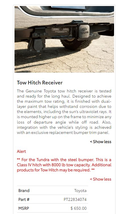

    Wondering if you even checked with a Dealership before classifying them as a "stealership" in your post. I run a dealership myself so I get that you might have had a bad experience somewhere but all dealerships arent the same. Seeing that youre in NY explains a lot as to what you probably dealt with there but some are different, especially us in the south. Below is a factory hitch from Toyota at a much lower price than you mentioned though and thats at retail...most places will discount them.
