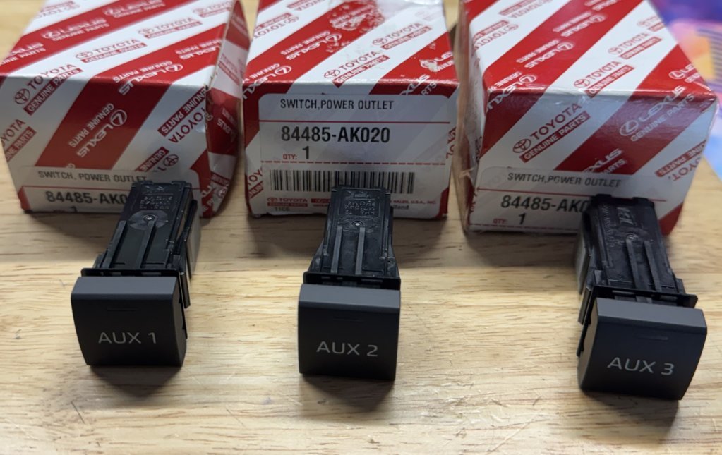

    ETA: Understood that there are aftermarket options for switches, this post is for the factory switches.
    Found this over on a Tacoma forum. I have two open spots that I would like to fill and am wondering if anyone are running these.
    Questions...
    1. Are these self latching?
    2. Are there issues installing these in existing openings? Possibles keyed for a specific opening, might be able to be modified.
    3. Wiring connector to convert to aftermarket wiring items?
    Part Number for switches...
    84485-AK010 AUX1 Switch
    84485-AK020 AUX2 Switch
    84485-AK030 AUX3 Switch

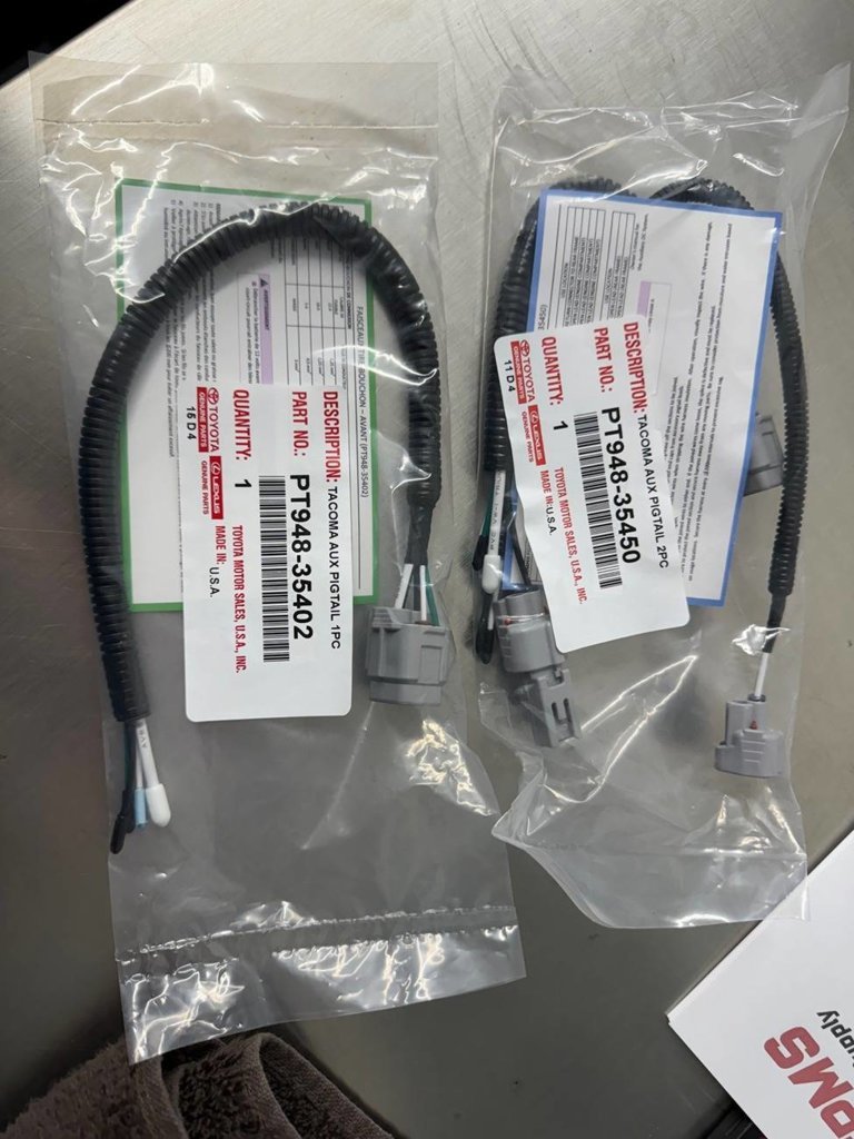

    Some AUX Wire harness part numbers out there...
    PT948-35450 AUX Wire Harness
    PT948-35402 AUX Wire Harness

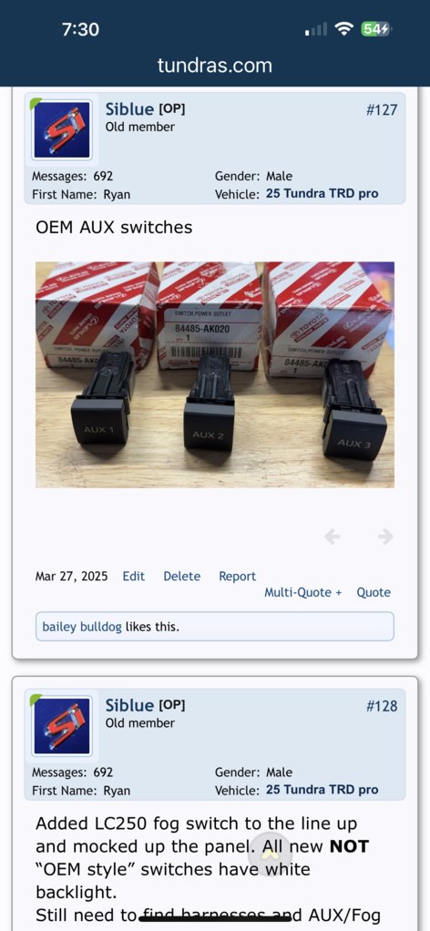

    That’s my pic from this forum

    I also continue to post on TW. Yes, I’ve completed the install in my truck.
    1. Are these self latching? YES
    2. Are there issues installing these in existing openings? Possibles keyed for a specific opening, might be able to be modified. All OEM are indexed or keyed, desired opening will require minimal trimming
    3. Wiring connector to convert to aftermarket wiring items? All switches added are wired to aftermarket components

    What harness did you use for the to go from the switch to the aftermarket item?
  7. May 16, 2025 at 7:55 AM
    Siblue
    Siblue Old member
    May 10, 2017
    #7665
    703
    Ryan
    25 Tundra TRD pro
    Tundra owners do not need the AUX harnesses. Only Tacomas and 4Runners with AUX switches pre installed require them.

    This TW thread has more switch content
    https://www.tacomaworld.com/threads/unused-connectors.838194/page-5

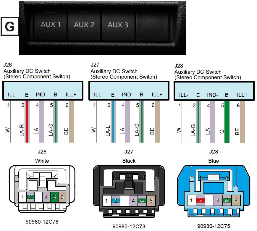

    My build thread also has some of this info. I source Aliexpress for the connector and pins to build my own harness. They are more cost effective for the connectors than OEM part numbers.
  9. May 16, 2025 at 8:16 AM
    LB-1889
    LB-1889 [OP] New Member
    Aug 25, 2022
    #82414
    83
    Thanks, sorry was taking about the connector, not necessary the existing harnesses that are pre-built into the Tacoma's. Which you cleared up.
