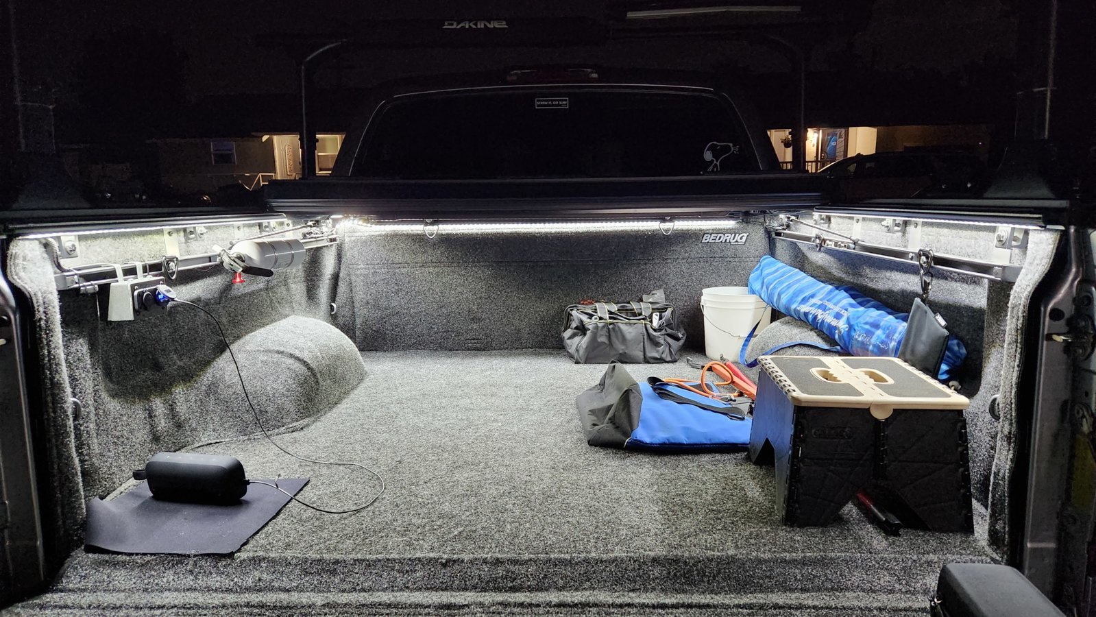

    So there are a few options.
    When i bought my ARE, it came with LED interior light by the back glass. I wired it up to the regular cab light, so the that light will come on when the truck doors are opened automatically or will come on when using the switch in the cab. You can also keep that light off with that switch too. That light works ok, not super bright.
    I also wired up Amazon strip lights along the bed lengthwise. One passenger side, one drivers side and one on the base of the glass window. These are turned on by a switch just inside the driver's side windoor, so they can be opened from that windoor or with the back glass open. These are VERY bright, wired to a 12V outlet i have installed in the back which is wired directly to the battery (fused of course). With the topper headliner, velcro sticks very well to it. That is how i stick on the lights and strips of velcro can be used to run the wiring as well.
